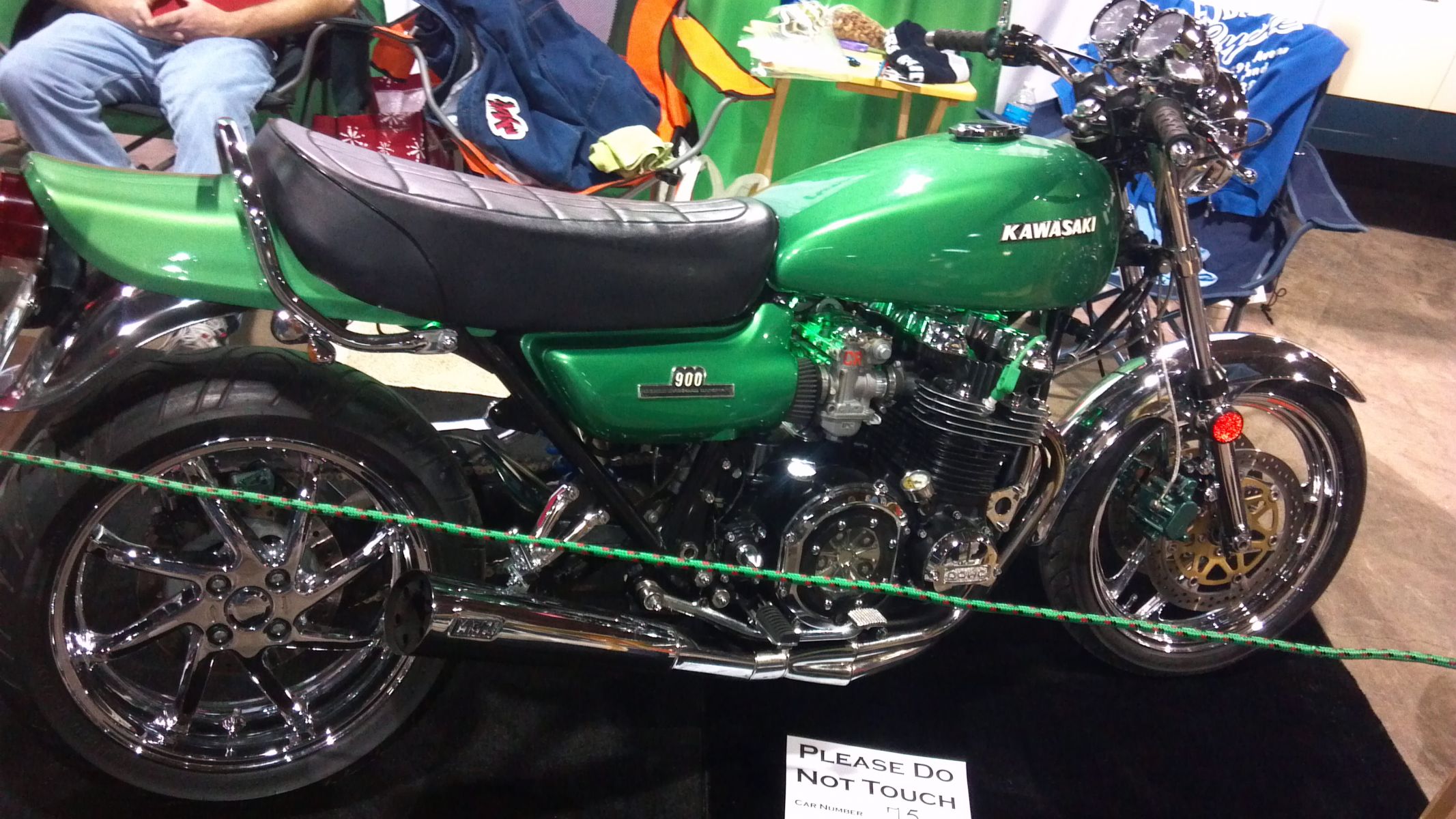

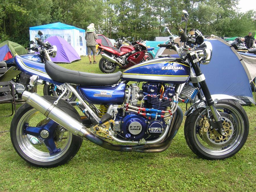

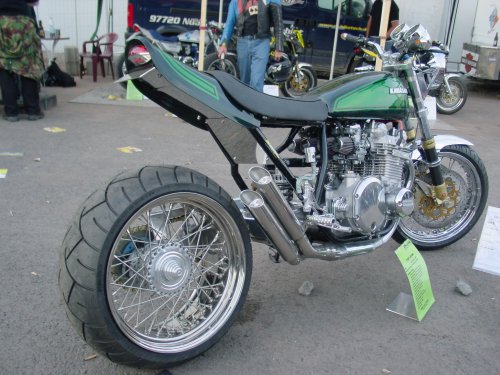

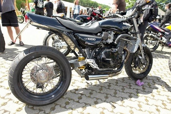

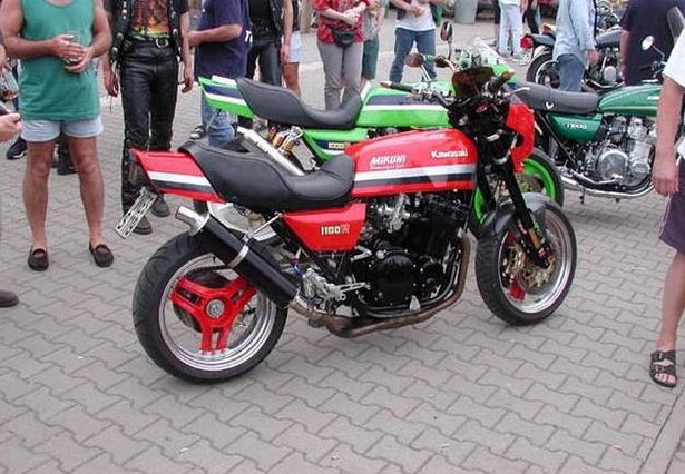

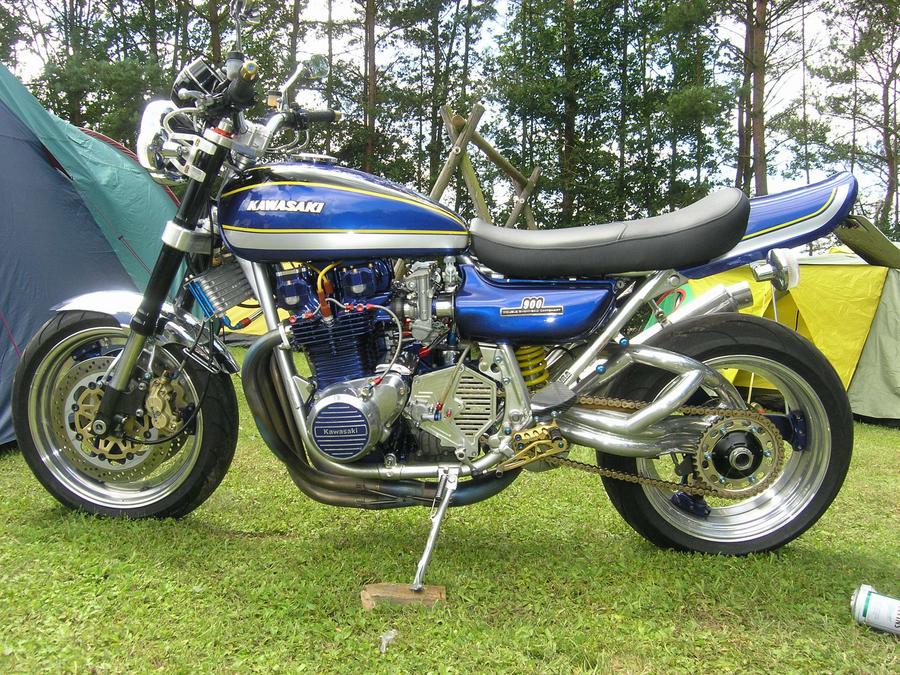

No eBay APP ID and/or Cert ID defined in Kunena configurationNo eBay APP ID and/or Cert ID defined in Kunena configurationNo eBay APP ID and/or Cert ID defined in Kunena configurationWhy not just buy a VFR? More power, better handling; better brakes; single sided swing-arm; the works!

ed it is just too bad none of the bikes you posted look like a kz with a single sided swingarm :whistle: .
or else you might be onto something
the load of a single side swingarm acts on the chassis just as nitrokeeb says.
you are looking for an arm that is or can be machined to 9 inches of width at the pivot.
most are wider than that.
if it was me i would machine the pivot tube narrower and then weld aluminum plate back into cover the holes that were opened be machining the pivot narrower.
but i have the skills and machines to do that.
