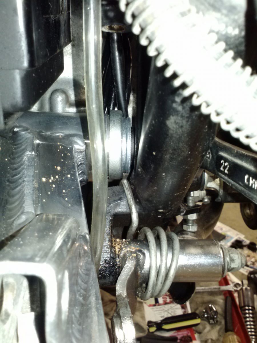

Got a question about mounting this swingarm. I bought 5/8" washers and they fit really well over the 16mm pivot axle. Each washer is about .0020 - .0025 thick. I used 4 thicker washers for a total of about 10mm. I had to tap the last washers in as it was a very tight fit. Now the swingarm doesn't move as easily as I thought it would.
My question is, how easily should the swingarm move? Can I have too tight a fit? All of the bearings and sleeves are brand new and greased. Not sure if the pressure of the frame/washers is causing the tightness or not? Maybe fewer washers would still bind because the frame tightens up when the pivot axle bolt is tightened? Thoughts??
Here is what I have now, on each side:

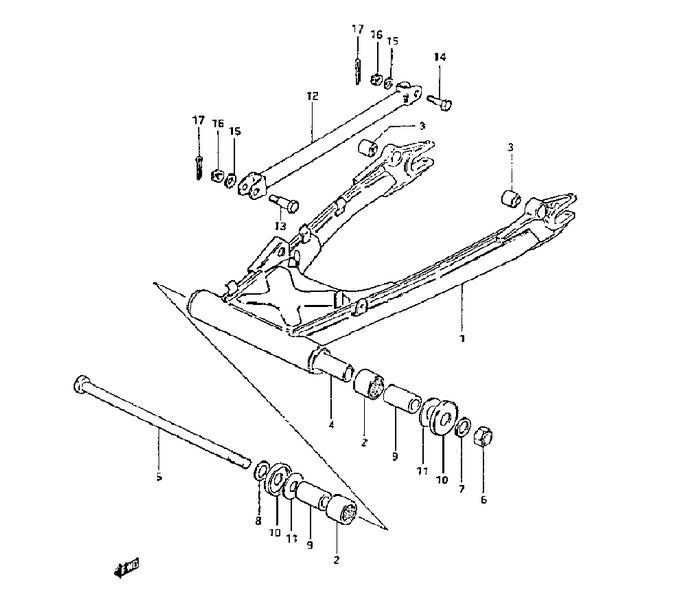

I'm also wondering exactly what parts should pivot with the swingarm? I'm thinking the only moving part should be the swingarm. The bearings, axle, spacers, and the dust seals on the ends should all remain stationary, right? You would basically have the swingarm rotating in the dust seals? They have a rubber liner inside so they swingarm would be rotating/rubbing on that.
Anybody ever noticed what exactly is going on at the pivot? I've never looked that closely.....wish I did BEFORE I removed the stock swingarm! :S

That sounds exactly like what I tried to describe above. With that being the case, the swingarm probably couldn't be "too tight" in the frame, right? I think all of the pressure would be on the sleeve and not the swingarm. The GS arm is slightly different....has (3) spacers that make up the sleeve, but the end result is the same. All (3) combined are just barely longer that the swingarm tube.
GS Arm:

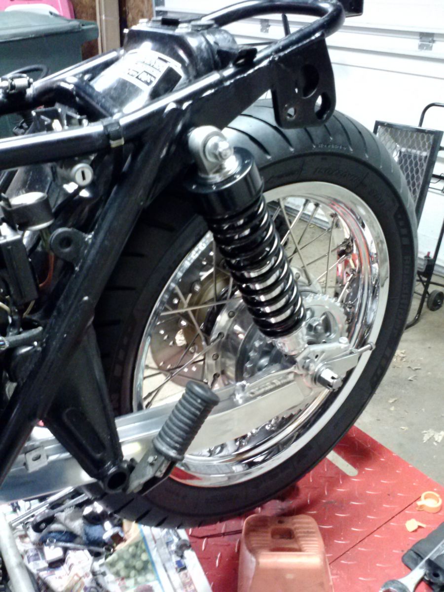

For the record, I swapped out one spacer on each side for a slightly thinner one. The fit it still very tight but looser than it was. I also added more grease to the inside rubber edge of the end caps. I properly torqued the pivot axle and it seems to move very smoothly with zero slop. Here's a couple pics of how things are looking. More details are in the build thread since this one is about polishing the arm, not installing it. The arm is a bit dirty from working on it so I'll hit it again with Mother's when all the work is done.
Here's the link to the build thread:
