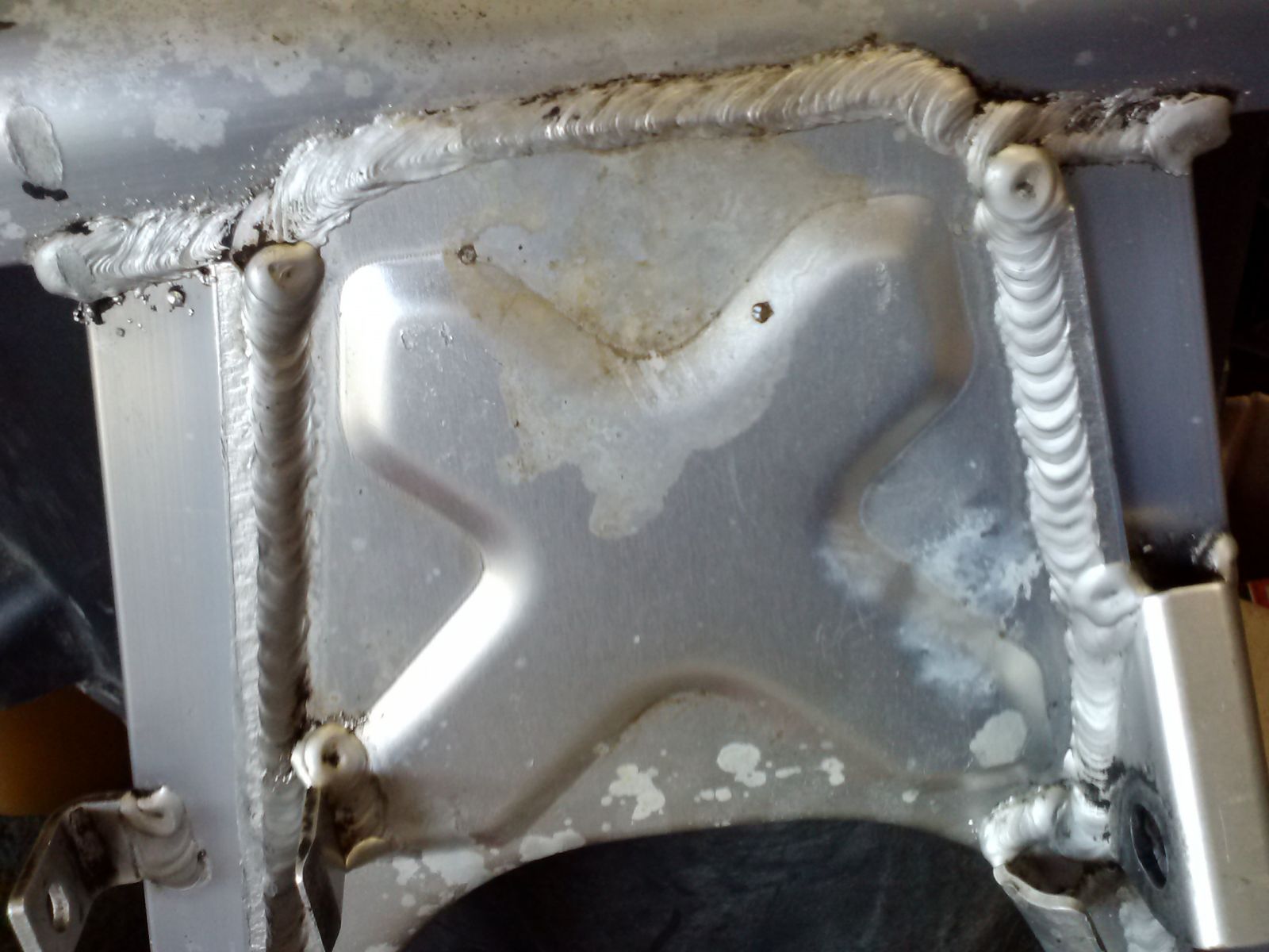

Hello All,
I'm working on my '78 KZ1000 A project and I've got a GS1100 swingarm for it. I've got everything ready to go now....reconditioned / painted / new: All bearings, sleeves, shocks, chainguard, brake caliper, 3.5" aluminum rim laced to a stock hub with a 150/70 tire, etc...
I'm ready for final assembly but I'm having a real hard time refinishing the swingarm. It's the last piece I need to clean up. There's a factory silver coating that won't come off! I've tried chemical strippers, sanding, etc...with no luck. I wanted to polish it but I'm thinking about painting it black or silver.....which I swore to myself I'd never do to an aluminum part. Or, I'd send it somewhere to be polished if I could find some place to do it. Nobody ever gets back to me?

This is a thick silver coating, not just clear anodize. I'm guessing it's paint since I don't think they were powder coating back then. Whatever it is, it's on there good. I've got to get to the bare aluminum to polish it.
By the way, I heard back from a local polishing place.....$375 to do the arm! :ohmy: Does that seem right to you guys? I can buy another swingarm for that kind of money. Wow......

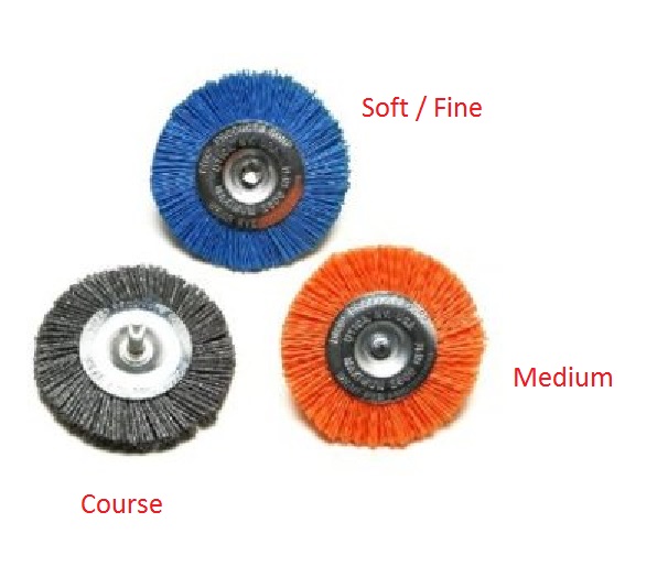

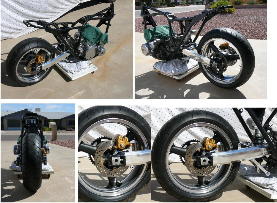

ZX636 Swing-arm count.... Black hard as hell to get off rims and swing-arm....
Here's what I used after trying several brands of stripper to no avail other than a mess....
Then buff the hell out of her..... Brown tripoli then white compounds, buff disk/pad on end of drill. Yes, it took some time, Ok was a PITA but was worth it...
OMR

If the heavy silver is anodize, it makes sense then why the stripper doesn't touch it. I need something caustic like easy off or lye, as has been mentioned.
I took Steele's suggestion to use an angle grinder and did a lot of sanding last night. It worked great on most of it but there are a lot of nooks and crannies that I can't reach. I might need the oven cleaner for those areas.
OMR - Wow, that ZX6 stuff looks great...thanks for the tips. Any idea where I could find abrasive wheels like those? Home Depot or Lowes maybe?
