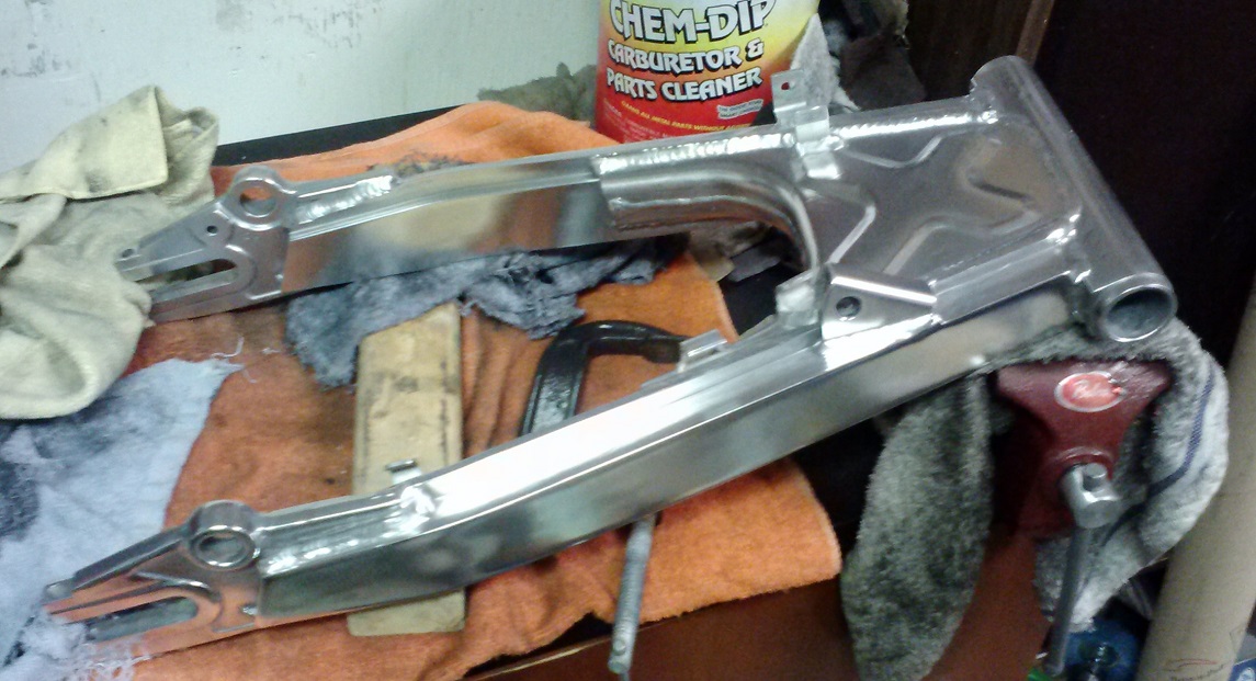

Here's a picture that the seller sent me before I bought it....The Before:
And here is what it looks like now....I'm getting there! :woohoo:
Any yes, OMR did good. Those wheels are great to work with.

Re: Anybody Ever Polish a GS1100 Swingarm?
15 Sep 2013 09:47 - 15 Sep 2013 09:47
Well-well, look at that purdy Swing arm....
OK, which route did you go to get it to this level... ?
I see a chem-dip carb cleaner in the image, is this what you used to get that coating off...?
Is this a non buffed state, damn looks good if so.... Wait till you hit it with some white compound... BLING-BLING.... :laugh:

15 Sep 2013 17:40Old Man Rock wrote: Well-well, look at that purdy Swing arm....
I tried so many things it's hard to say what I did exactly,
I started with an angle grinder and a sanding disc to get the anodize off. It worked pretty well but left all of the nooks and crannies and also beat up the swingarm pretty badly. I wouldn't recommend it.
Then I tried the EZ Off oven cleaner to remove the anodize and it worked very well. If I had to do over, I'd go with the EZ off right from the start. Since the arm was so bad after the sanding disc, I went with some heavy duty sanding paper and LOTS of sanding just to get it pretty smooth again. I then went with several types of scotch brite to get everything pretty well scuffed up and consistent all over. I tried some very fine sand paper and a little polish and it really brought out all of the defects. It looked terrible! Polishing brings out every little defect....it truly has to be perfect if you want your final result to be perfect.
So, back to heavy sanding...I think it was 150 grit, and I worked all of the bad areas. Then I worked my way back up through the scotch brites and then to the three new abrasive wheels. I went with the gray (course), the orange (med) and then the blue (fine). It was pretty shiny by that point. Those wheels are really great. I gave it a quick hit by hand with some mothers and that's where it is now.
I would like to get a buffing wheel for my drill and see how that works. Do you recommend the polishing compound over something like Mother's?
Oh, and the Chem Dip is just sitting there, it wasn't used for the swingarm, just the carbs.
16 Sep 2013 07:42
Lowe's has the Brown Tripoli (medium cut) and White (fine cut) compounds and the buffing wheel. They way that looks now, most likely only need the white compound to Mirror/BLING it out.... All depends how deep scratches are.
Mothers or similar would be used to keep it shiny afterwards.
Feels good don't it
to see what a little work transforms this old stuff to... ANd you did it yourself versus [paying someone $200 plus to accomplish.
Seriously, looks awesome!
