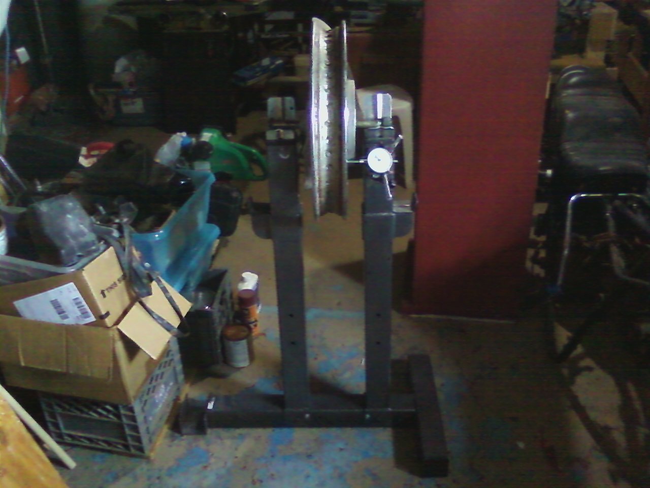

You can always make a stand, this one was made from parts of a weight bench that never got used :blush:
It's not that hard to lace a tire and youtube has videos, before you start,check you rim on something flat to make sure that it is in good shape , if it is wobbly or has a real crappy weld it gets a little tougher.
