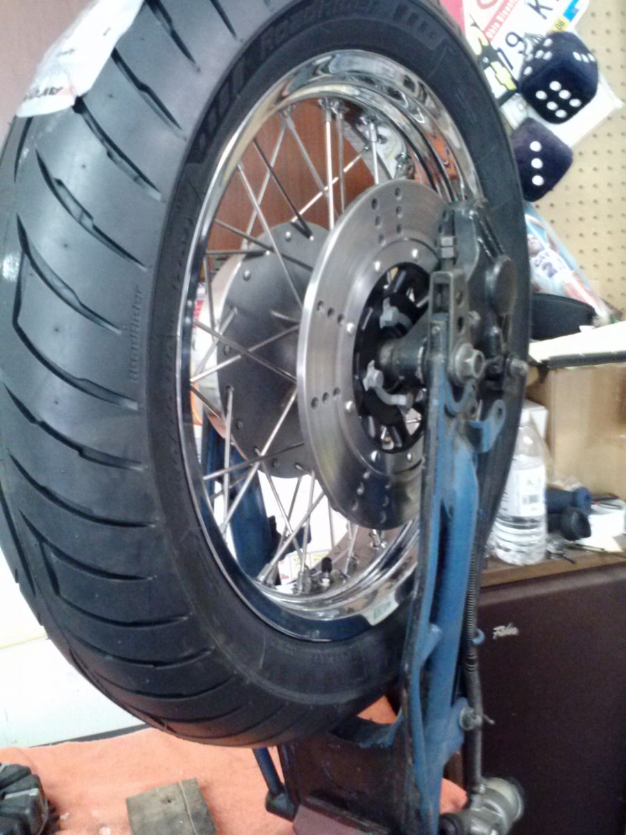

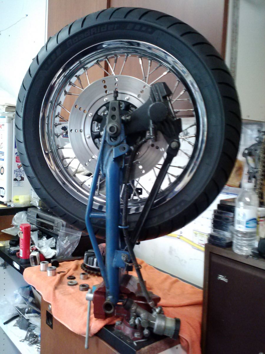

OK, got my rim back and now I have some questions. :S
This wheel will eventually go into an aftermarket swingarm, but I wanted to mount it into a stock arm to make sure I had the correct spacers to start with. I noticed that the distance from the edge of the tire to the swingarm is way off when the rear axle is lined up with the pivot axle. Our stock wheel / spacer set up should center the wheel in the swingarm, no? I don't get it. Is it possible that the wheel was laced incorrectly so the hub is too far to one side or the other??
In order to get the tire to siwngarm gap even on both sides, the chain adjusters need to be different by 3/8"....that's an eternity. Any thoughts?? Thanks

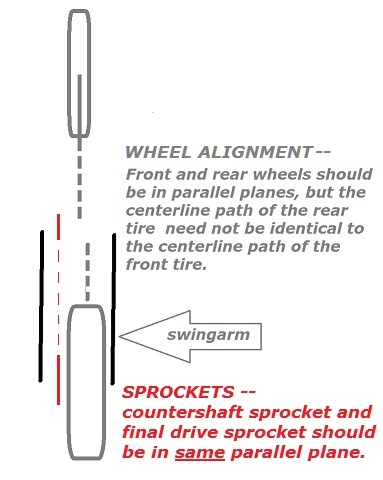

New models on the showroom floor with fat rear tires often do not have the center line of the rear tire tracking directly over the center line of the front tire when the bike is moving forward straight ahead.
The wheels should be in parallel planes but not necessarily in the same parallel plane.
However, the sprockets should be in the identical parallel plane.
