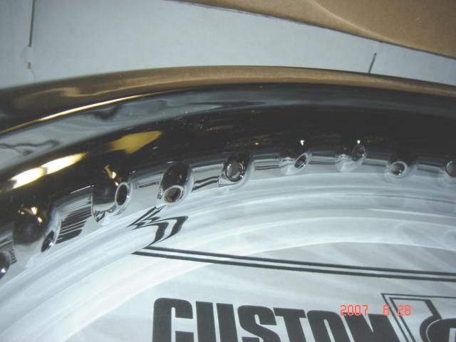

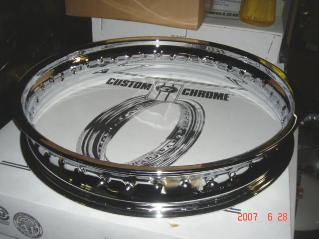

I'd like to do the front rim now, so I have another question. Will any 40 spoke rim lace up to the stock KZ front hub? I'll post of picture of the specific one I'm wondering about. It's a 2.5x19 aluminum rim. I have a spare hub and rotors so I'd like to get the correct SS spokes and lace it up. This one is supposedly for a Hardley but will it work??

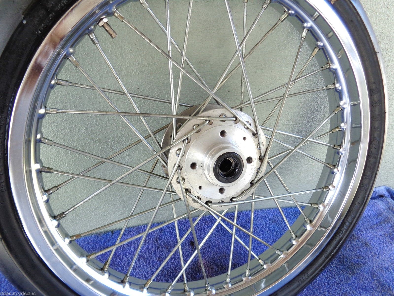

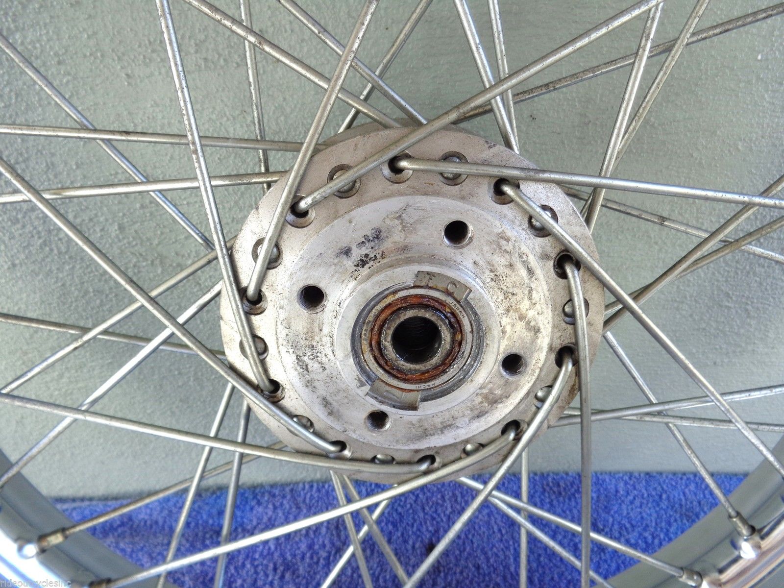

No eBay APP ID and/or Cert ID defined in Kunena configurationHoly Kaw! I don't know exactly what went wrong in lacing this wheel, but I can tell you for sure....it ain't right! :ohmy:
