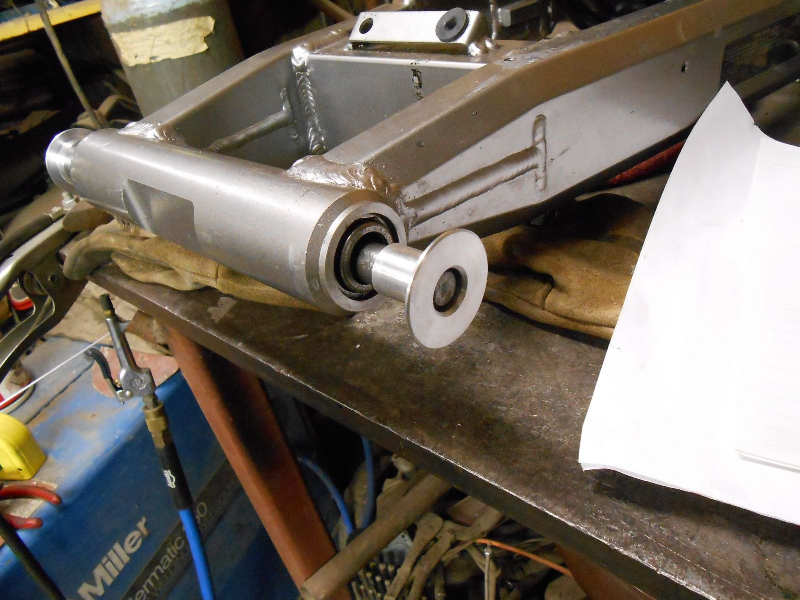

for the swingarm swap i mill the sides down so it fits in the frame(makes it nice if you ever want to go back stock)shorten the center spacer and make top hat style spacers to adapt to the kz bolt.
