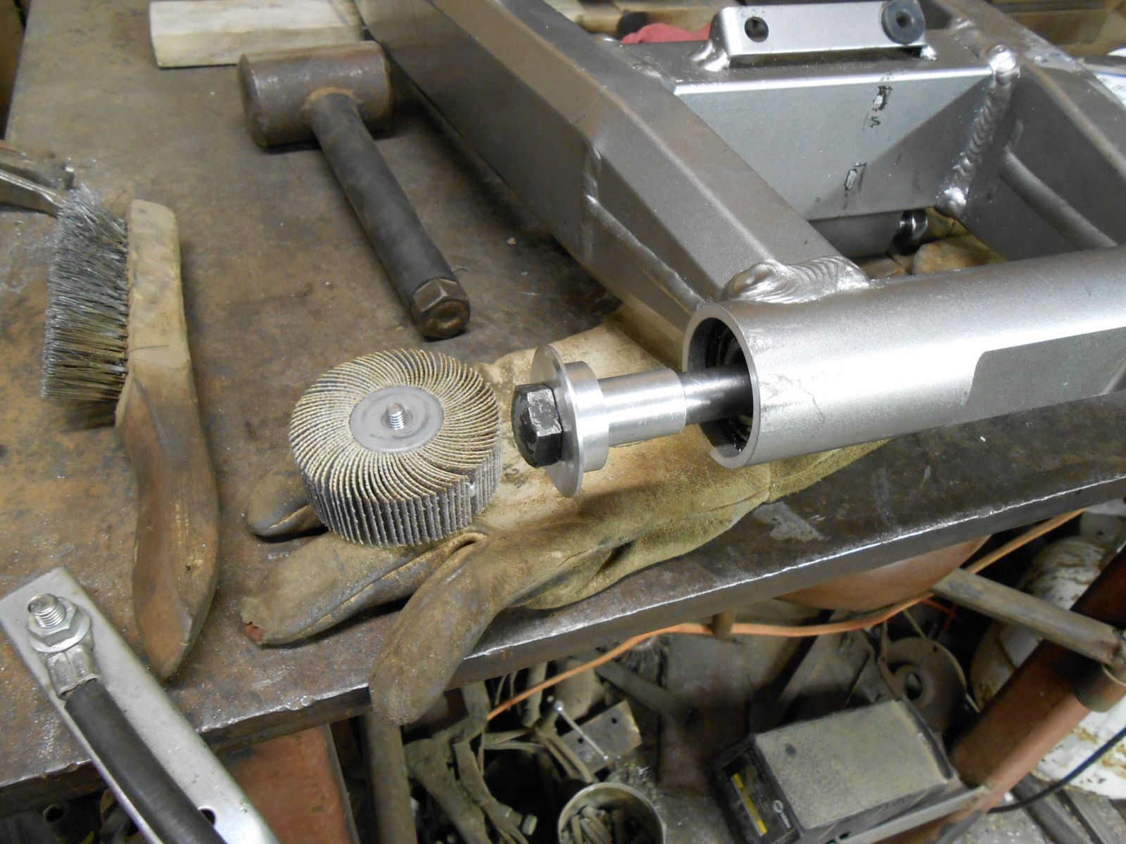

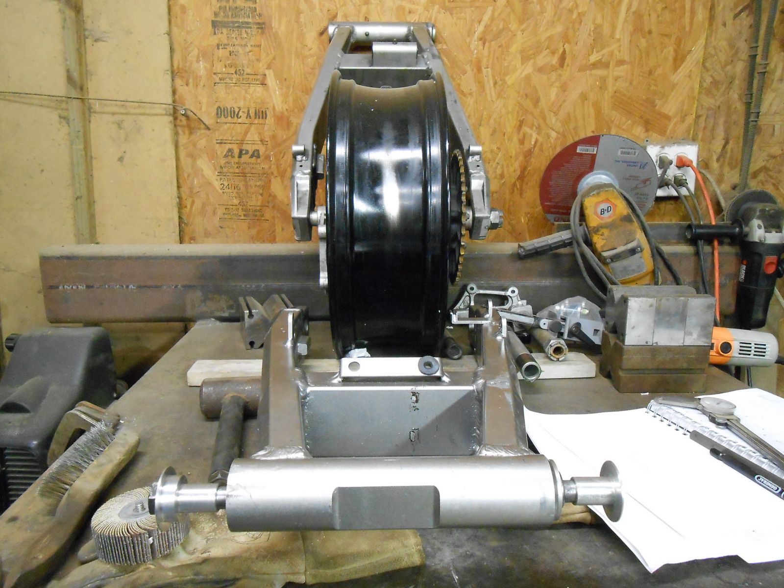

for the swingarm swap i mill the sides down so it fits in the frame(makes it nice if you ever want to go back stock)shorten the center spacer and make top hat style spacers to adapt to the kz bolt.

Thanks Leon, if all else fails ill send it out, looks like the bearings might work, Still messing around with it at the moment. Ill be getting with you in the future for that swingarm setup,
