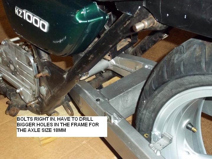

Hi, I just bought a 2006 zzx 600cc? Rear wheel and swing arm. It is 2 inch longer than a KZ or Z1
Pretty tight fit between the KZ frame and has a 20mm pivot axle.

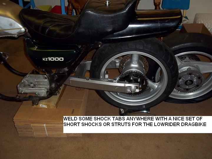

But Man this looks like a nice conversion swingarm. I have to weld some shock or strut brackets on the top of it and drill out the frame openings to 20mm.
I did not take any pictures yet. But I think this will work nice.
Rim is 5.5" x 17 Nice for a M/T drag slick. I am going to change the drag chassis I have to this rear wheel.
Now I need to find a matching front wheel.
I don't know anything about these new crotch sewing machines.
But I do know that $50 bucks with the brake caliper is a good deal.
I'll post a picture later at 11:00pm east coast.
Any one know or opinions on this swap?

thats awesome i'm looking at a 96 600 ninja swingarm and tire combo..i'll use my swing arm for the bobber look and weld the tabs where the ninja shocks would go on both the frame and swingarm..glad to know it can be done tho..thanks for posting..let us know what you think of the way it handles and rides

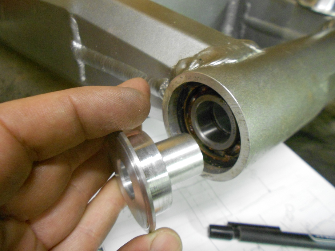

How about just making a new sleeve for swingarm?

Yes, I'll make something, The openening is actually 20mm.

Leon, r u able to make a top hat spacer?

03 Jul 2012 11:27Revboyz wrote: Leon, r u able to make a top hat spacer?
yessir!
