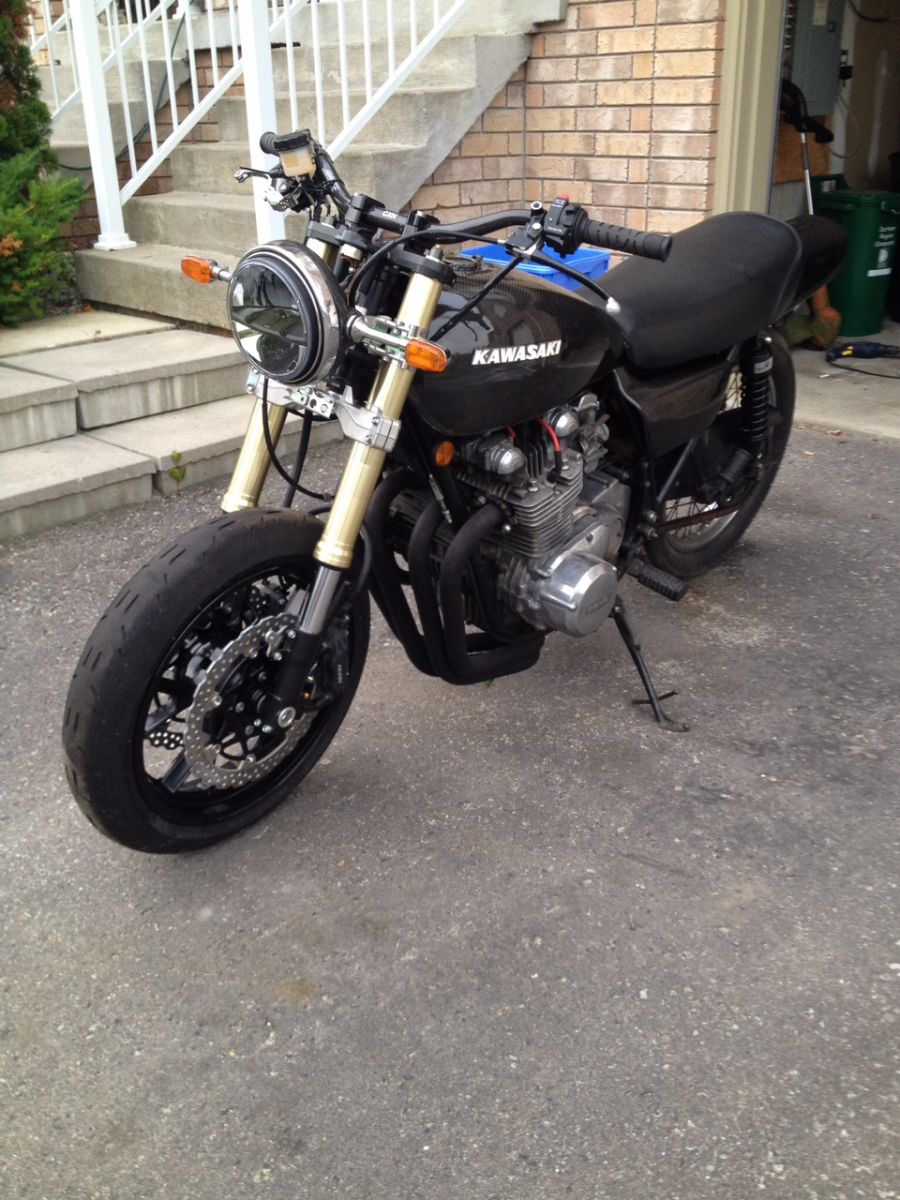

I think it's time for an update (its only been 2 years)

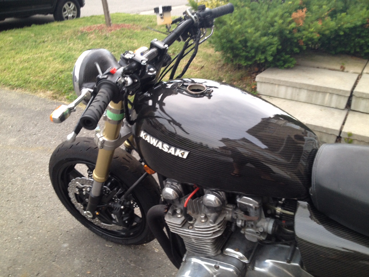

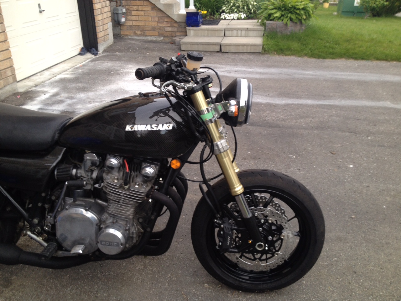

So the carbon fiber work is now complete, the ZX14R front end has been fitted, a LED headlight has been installed, and I have swapped out a few bits and pieces around the bike.
Things to complete: Get a custom swingarm to accomidate the ZX14 rear wheel, figure out what i'm going to do about the seat, upgrade the engine.

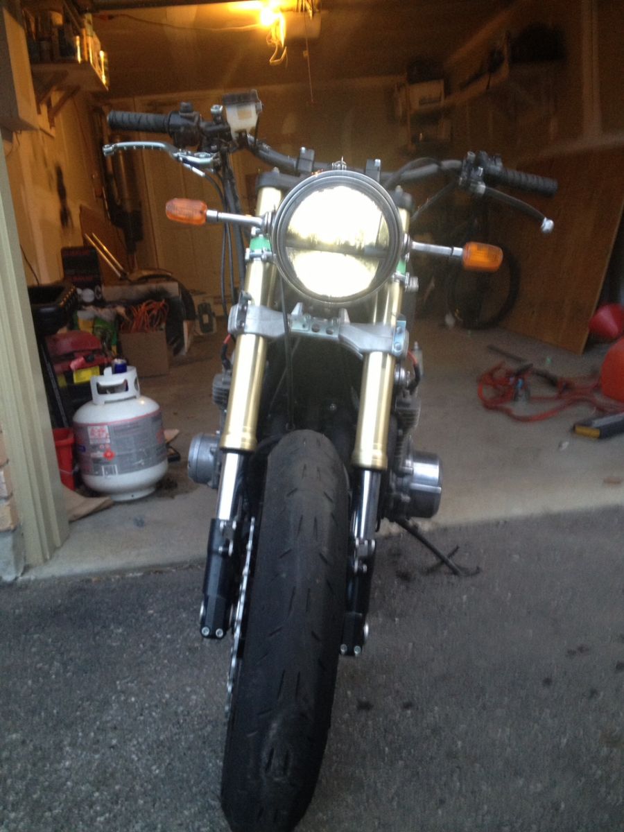

Nicely done Scotty. How do you like the headlight? I put one on my bike but its still in pieces. I'm hoping it was a good investment. It looks great and fits great but have no idea if its bright enough.

The headlight is awsome!!! It is just as bright as the HID headlights but draws less energy and produces less heat. Definatly worth the money.

I'm probably going to go with a custom swingarm. not sure which one just yet
