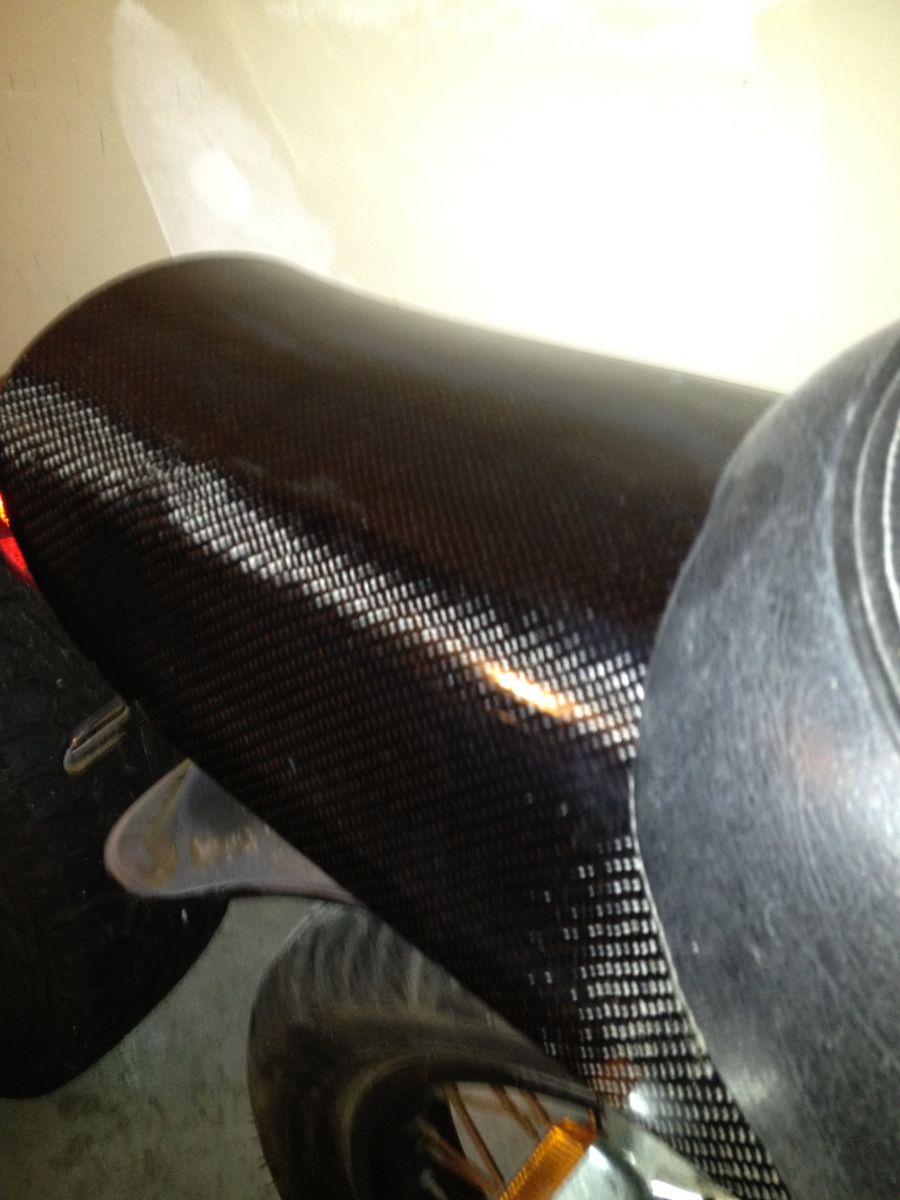

Some Pics of the Carbon fiber so far. More to come.

I am wraping the parts in carbon fiber by painting my parts black,then mix an epoxi resin and coating the parts with the resin. Waiting till the resin gets tacky then placing carbon fiber fabric over the parts (it is exreamly difficult to lay the fabric without screwing up the weave)
Once you are happy you soak the dry carbon fiber with multiple coats of resin. You need to use a hairdryer to heat the resin(this remove air from the resin). I did about 4 coats of resin (sanding between coats with 800 grit). If you have suficient coverage you need to make Shure the surface is smooth and the shape that you desire. Sand the object with progressively finer grit sandpaper untill you get to 2000grit.
You then need to clear coat it with a uv blocker.
Yes it looks really cool....but....WoW WHAT A PAIN IN THE A$$.
