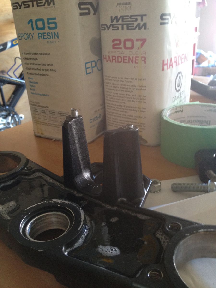

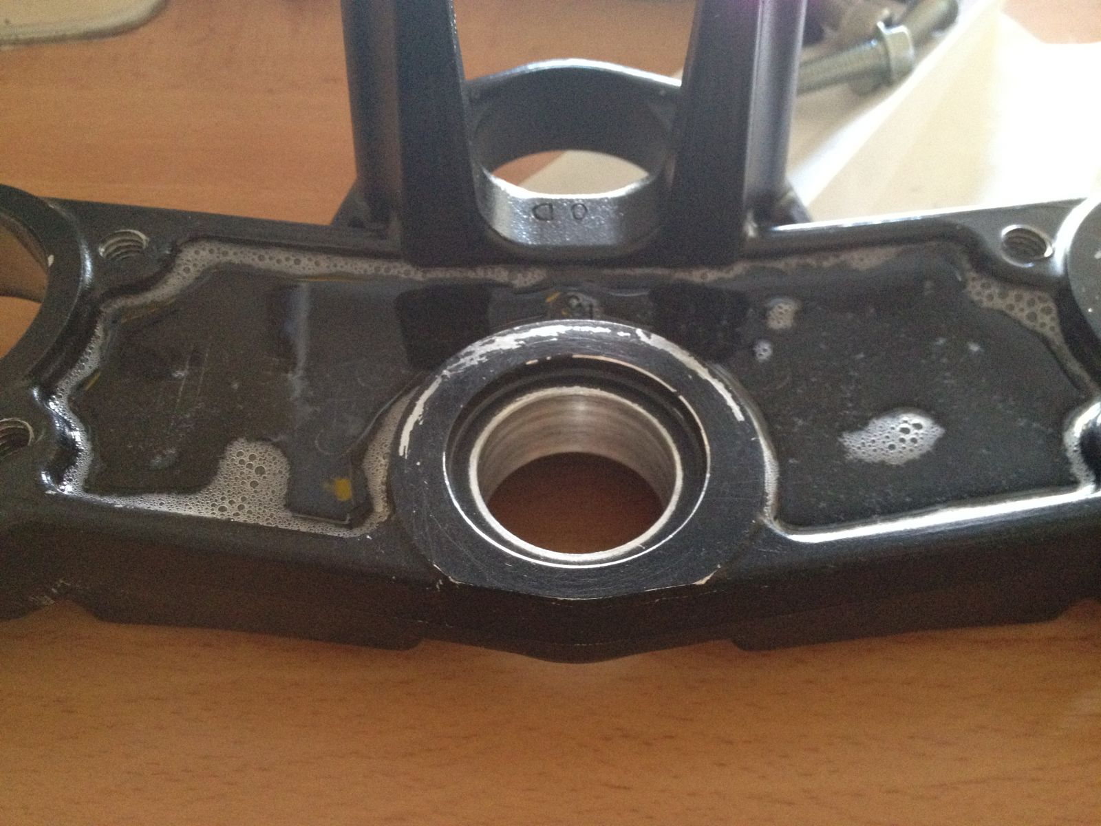

Instead of getting a custom top tree made for me, I just filled the bottom of the top tree with a strong epoxy. My thinking is that I can make the mounting point for the riser much stronger than if I just drilled through the aluminum, see pic

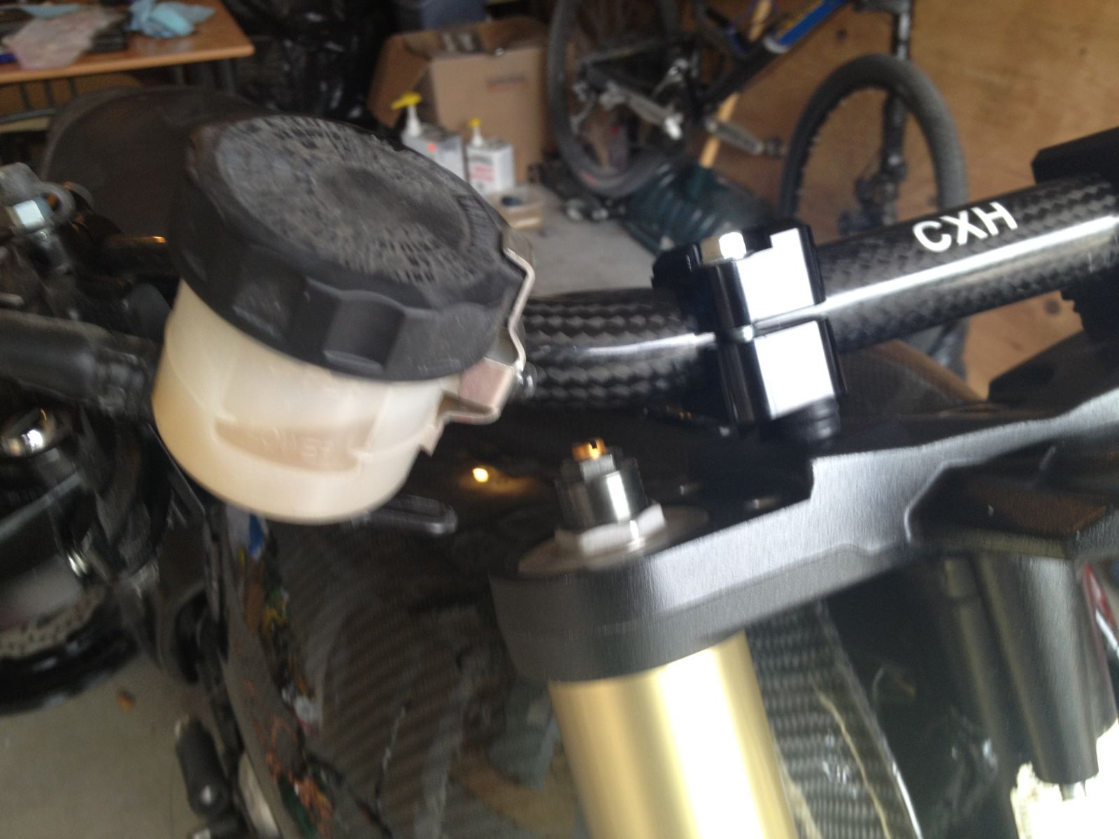

Once that was all done I mounted the Driven risers and the kermaxx carbon fiber bar.
It looks very cool.

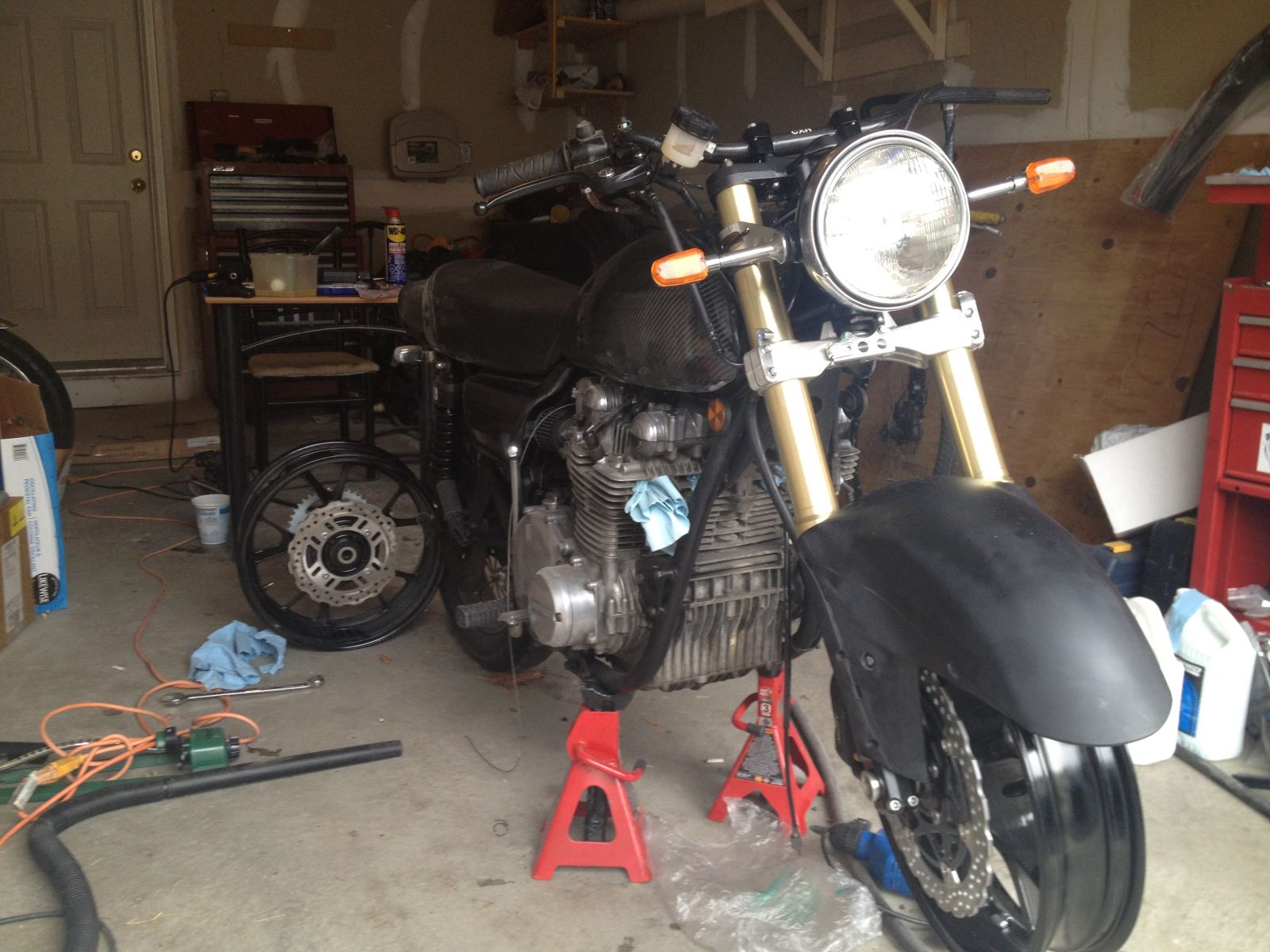

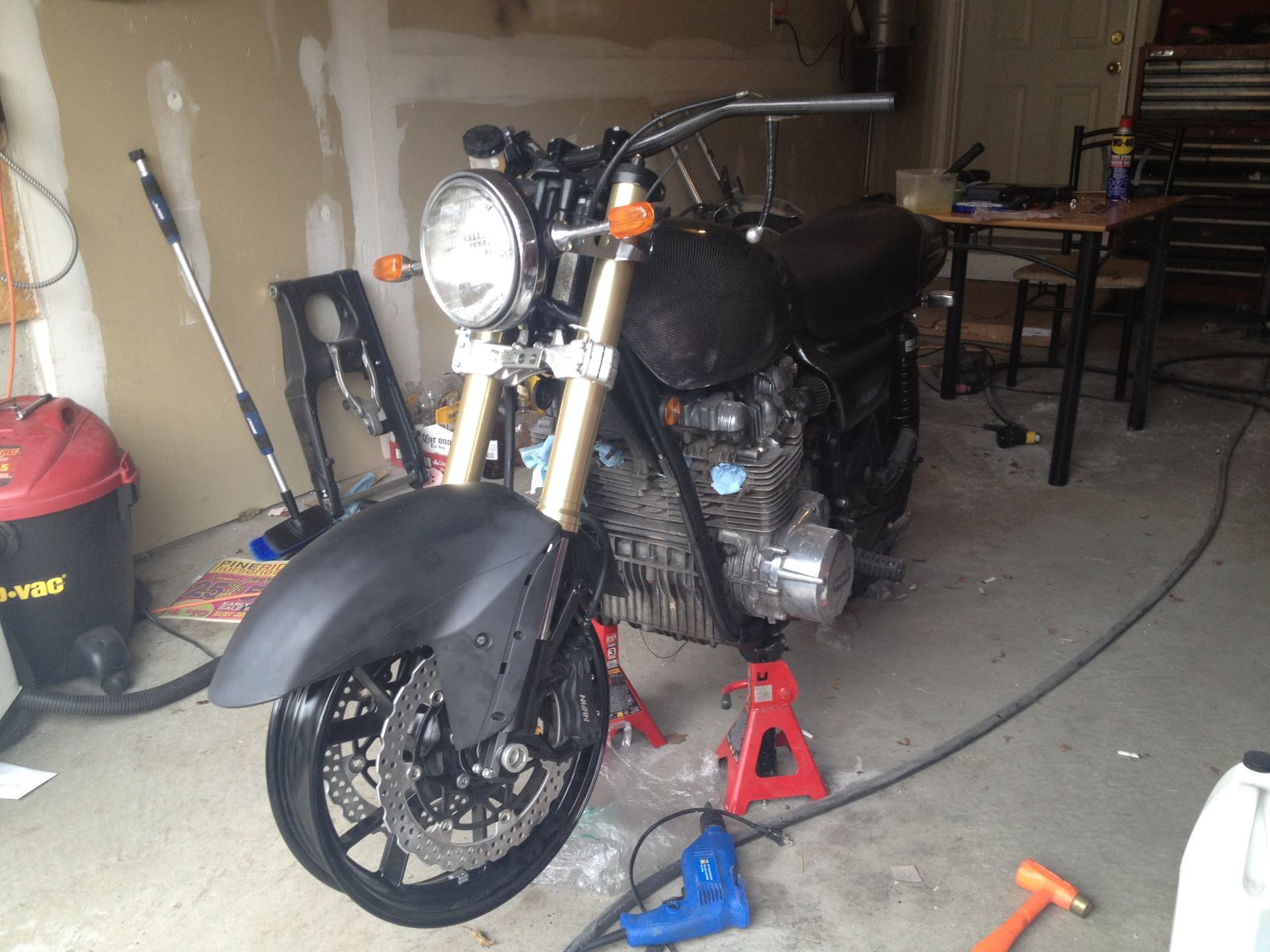

I then took some time to mock up the front end (mounted the wheel, brakes, fender and zip tied the headlight on) just to see how it will all come together. The only problem is that my brake line is waaaay too short. Since these brakes are from a ZX14 they were made for clipons so I am probably 4-5 inches higher. Anyone have any brake line company that they can recommend?

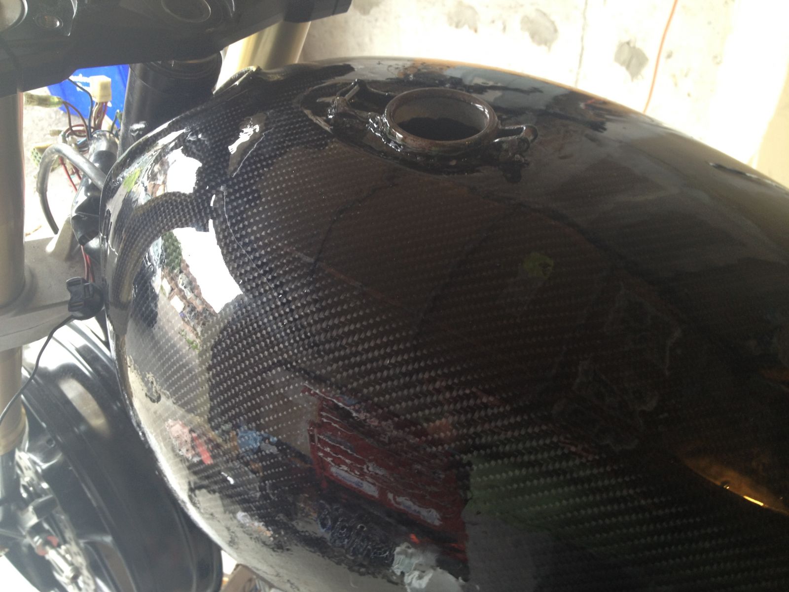

And last but no least here is a pic of the tank wrapped in carbon, I think I will take another run at it with 2000 before I figure out what kind of Kawi stripes to paint on it.
It looks very cool.

03 Aug 2012 16:33 - 03 Aug 2012 16:34ScottyKZ1000A2 wrote: ...brake line is waaaay too short. Since these brakes are from a ZX14 they were made for clipons so I am probably 4-5 inches higher. Anyone have any brake line company that they can recommend?....
Z1 Enterprises has a wide selection.
www.z1enterprises.com/ListItems.aspx?keywords=brake%20hose

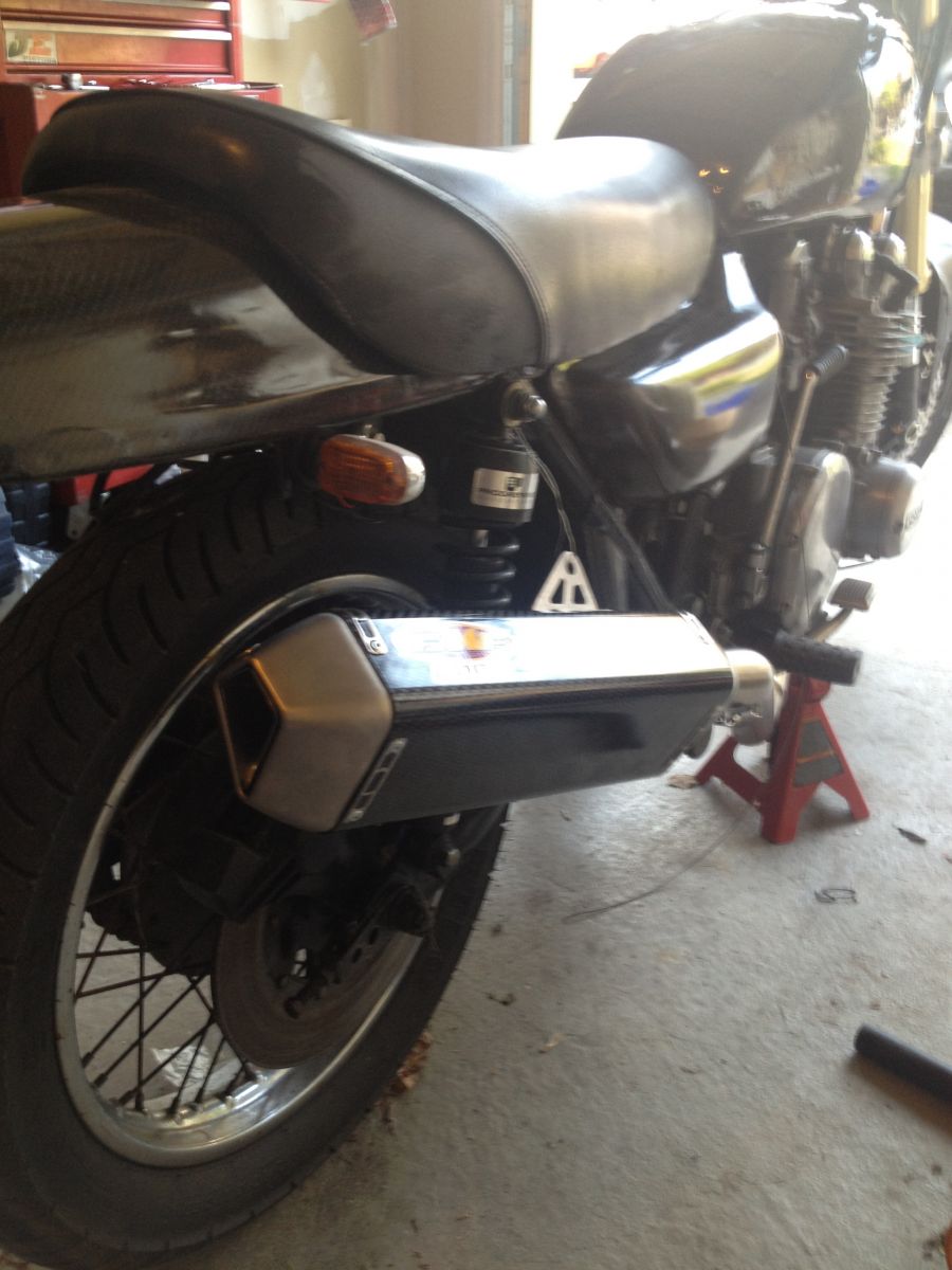

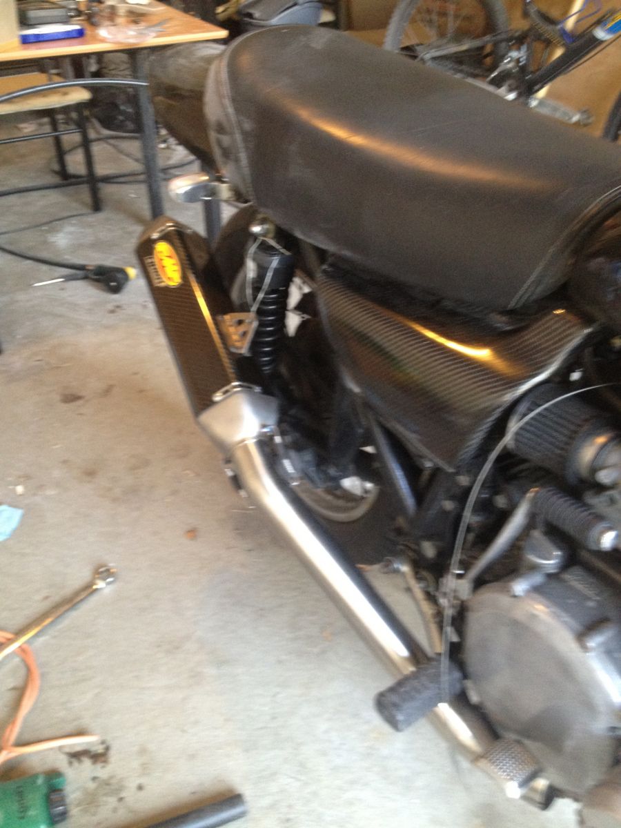

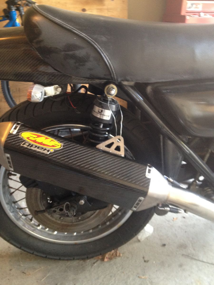

I went to one of my local shops today to pick up a scrub tire and came across a deal that I couldn't pass up on. He had a FMF carbon fiber slipon hanging on his wall for a GSXR1000. Brand new in box for $300 CDN!!!! yup gotta have it, see pics
as you can see I am just mocking up the bike so it isn't attached permanently. Just hung with some wire.
Anyone have any ideas for some custom headers???

Scotty, I do believe you love carbon fiber even more than me! Nice score on the can, hopefully it's not too much trouble to adapt to a kz header. The tank looks great too! How many coats of resin did you have to brush on and sand down to get to that point? Have you clear coated it yet in those pics?

There is about 10 to 15 coats with a sanding to every 3 coats to get most of the imperfections out. Since this was my first experience with carbon it was a lot of trial and error. In the pics the tail and side covers have clear, but the tank needs a final sand and clear.

I'd be interested in knowing what you and the guys think of acquiring an appropriate header and then just bending a connecting pipe to join the FMF can. I know lots of R&D work goes into pipe length, diameter, collector shape, etc. I wonder how critical the mid pipe is in all that?
