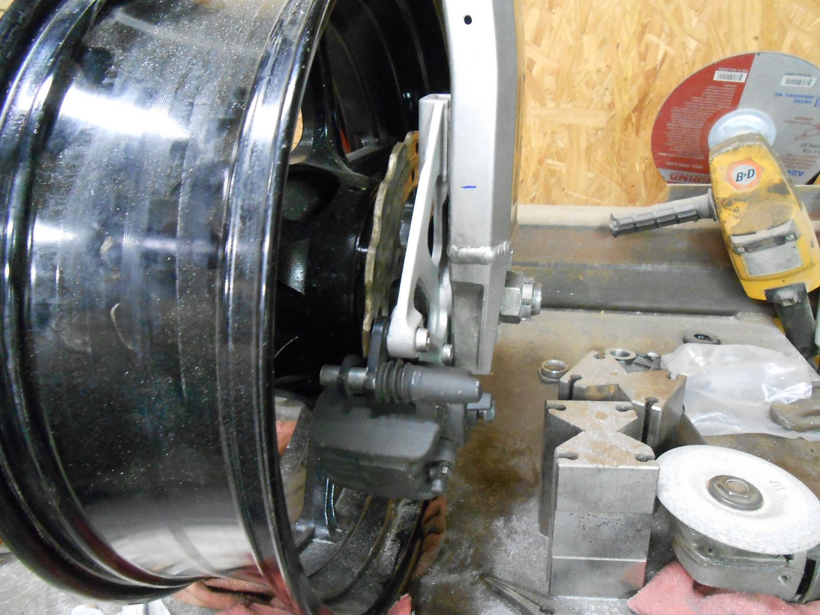

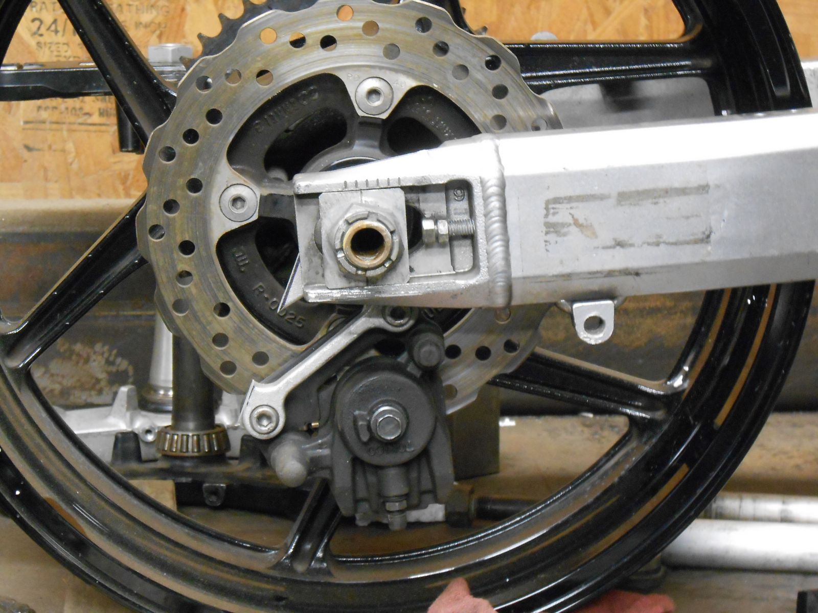

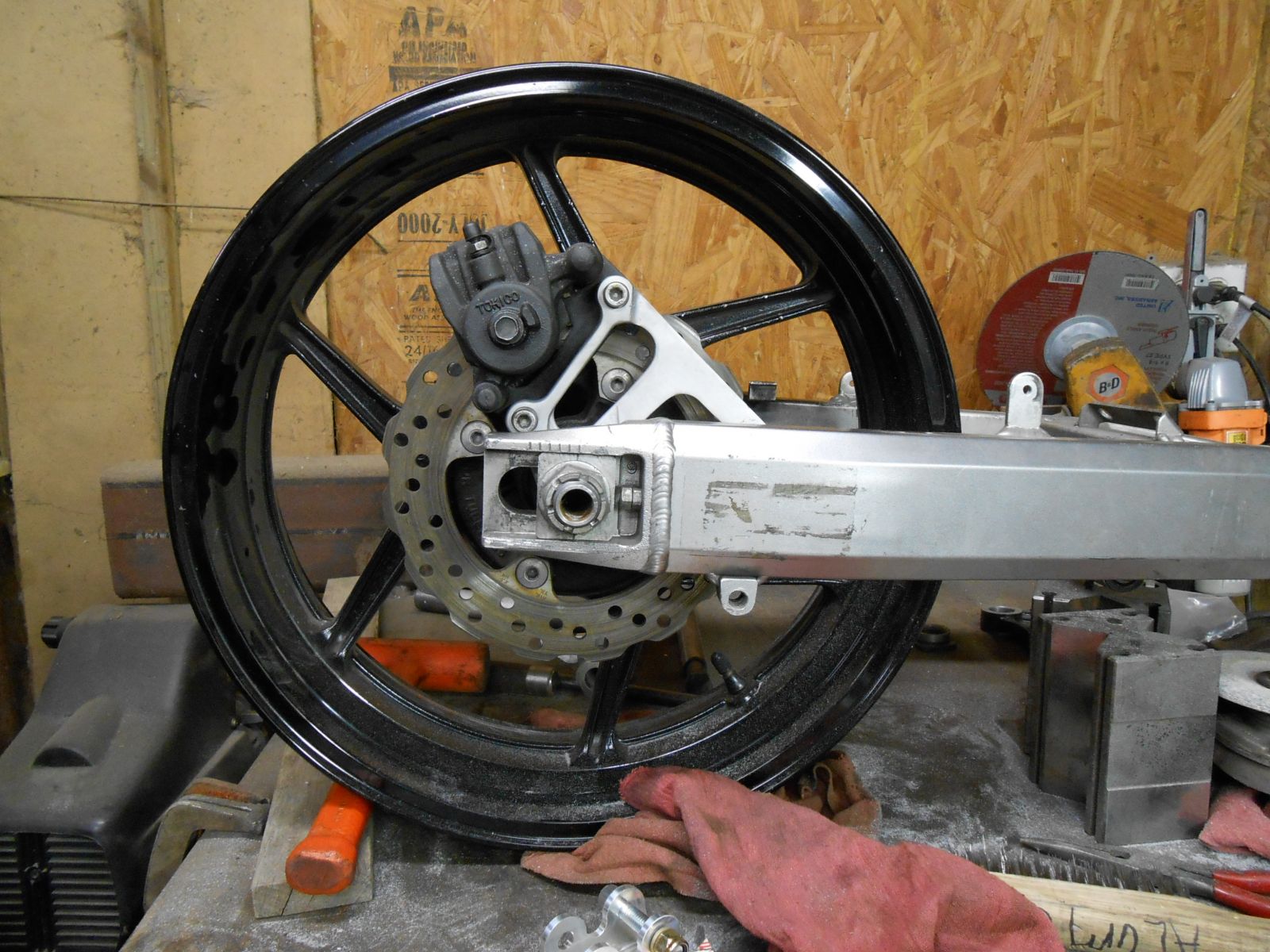

i dug this thread back up to show how i have gone about rotating the caliper back to clear dual shocks.
i currently have revboyz swingarm wheel caliper the whole mess so i could figure it out and make it work.
i cut the original bracket apart and experimented with a bottom location and a stabilizer rod.
nah,bleeder on bottom,no good place to mount stabilizer.
so i put both pieces of the bracket back in place and seen that i could cut a triangle out and weld it back in.so that it would rotate the caliper back out of the way enough that you can fit dual shocks.
i was all into it and and forgot to take take pictures through out the process :pinch: .
but here is the finished product,because that's really all that matters right? :evil:
took some thinking to figure out but seems to be a pretty slick solution,imho. :whistle:

new you'd figure it out! NOw im gonna go buy all the zx swingers i can get my hands on :laugh: :laugh: im just glad i went mono before you did way happier than i would've been

now we need to get les to cnc us some of these brackets :whistle: !!!!!!!!!
