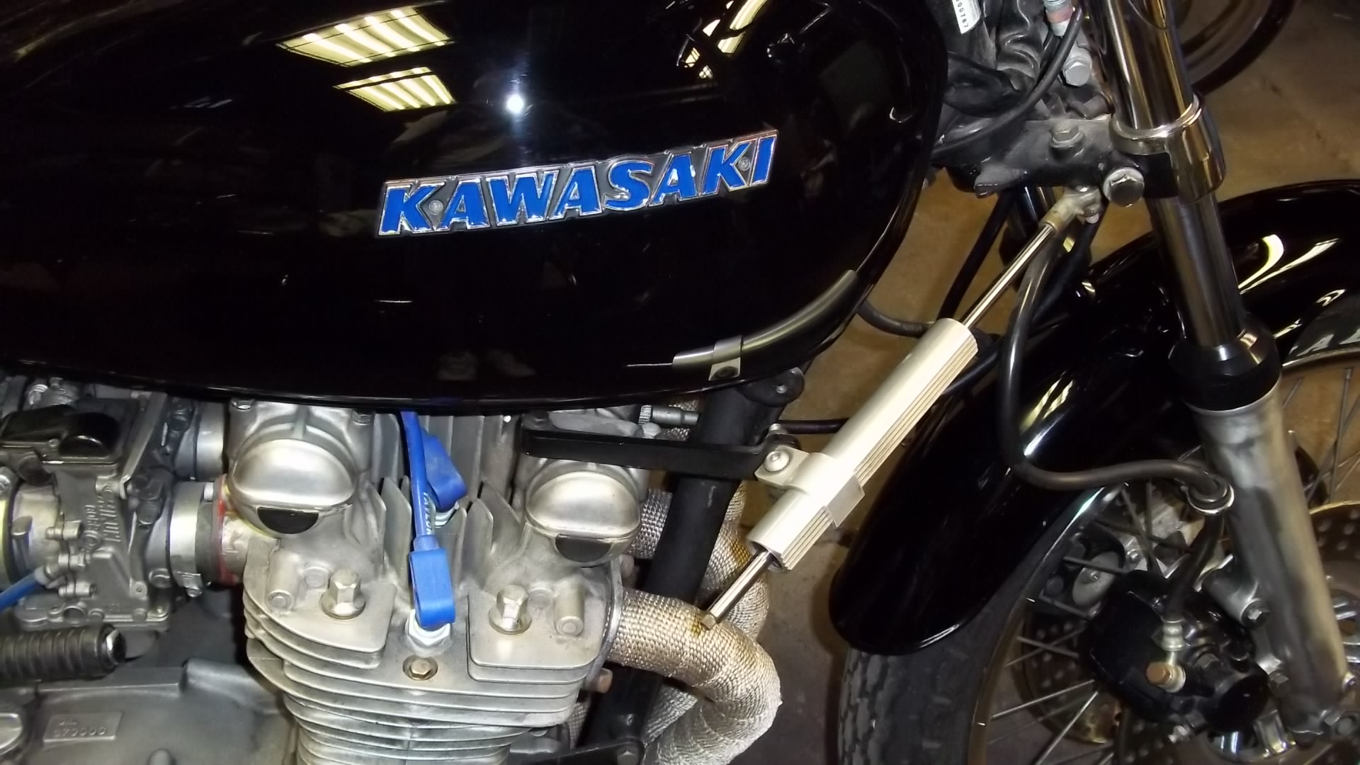

This is one of them bolt to the valve cover, with a Z1 triple tree. On a 1977 KZ1000.
I bought this bike like this.

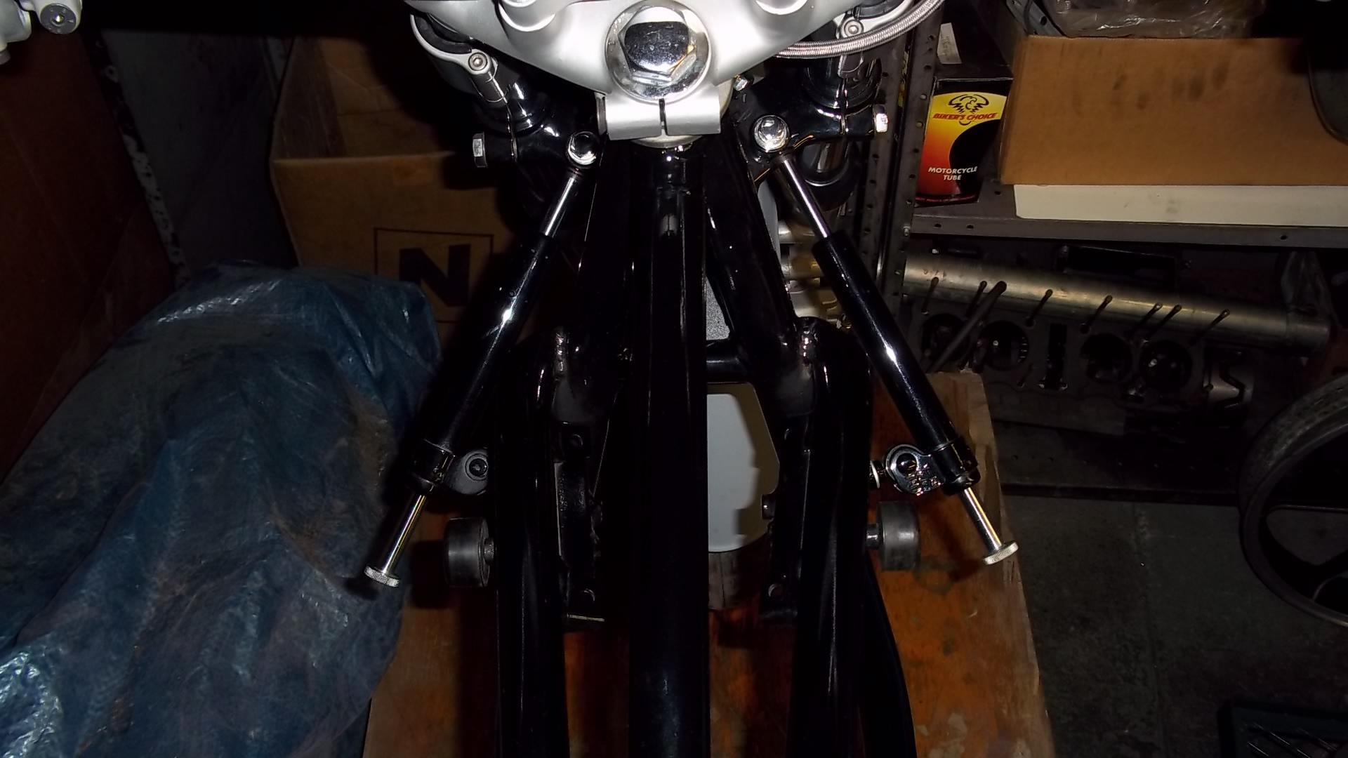

Then I mounted 2 - Z1 stock stabilizers on the hot rod just because it looks cool. This is a KZ triple tree, just drilled holes through both sides. Then welded lugs on the frame rails.
Either way you have to modify or fabricate something.

old triple trees cut up make nice steering damper mounts.

30 Aug 2011 13:54I like the mountz1kzonly wrote: This is one of them bolt to the valve cover, with a Z1 triple tree. On a 1977 KZ1000.
