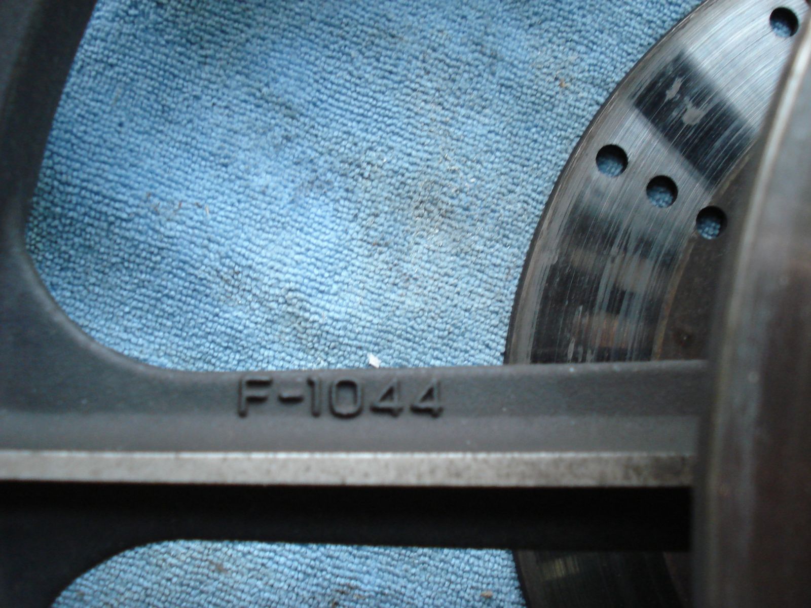

02 May 2011 23:42 - 02 May 2011 23:48...makes soldered cable ends seem relatively safe....steell wrote: mjg15, that is a tube type wheel that has been mis-marked as tubeless. In addition to the bead area, compare the center channel, tubeless rims have a deeper and usually wider, center channel than tubeless.
Seems to me, that if you did run a tire tubeless on that rim, and the bead did slip causing you to crash, Kawasaki might be facing some liability issues.
It definitely surprised me to see that it looked like that when the tire came off. Below is the number that is cast into the wheel, I don't know if is a model number, but I'm going to see if any of the other wheels that I have are the same model.
