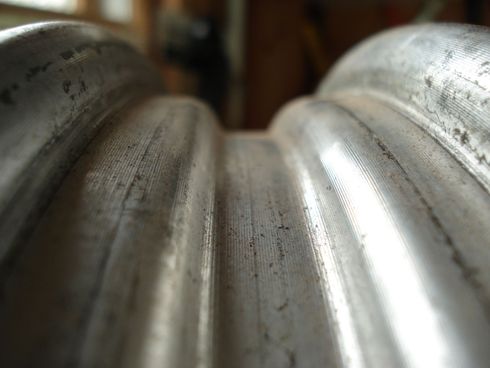

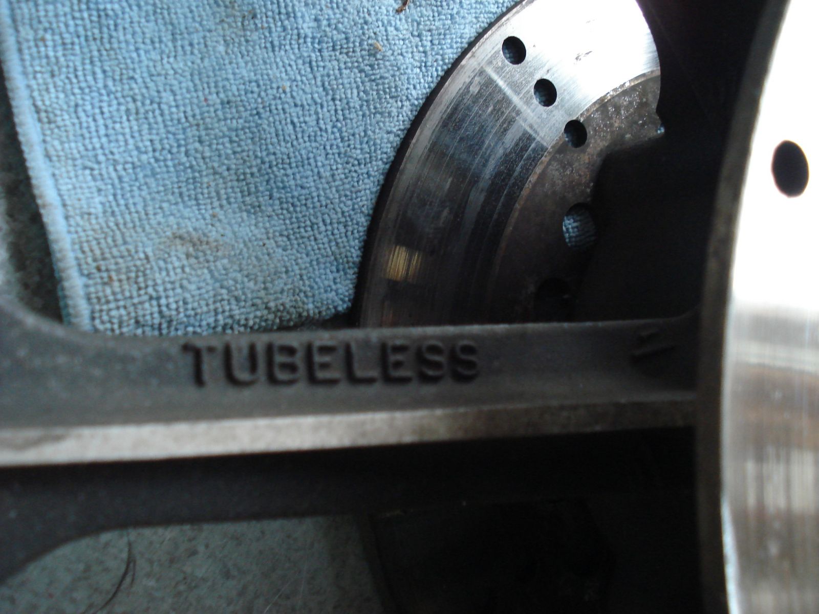

My 81 550 has "tubeless" cast into both rims, but the front doesnt have the extra lip. Is that common among other Kaws? I noticed the lack of the inner lip after dismounting the old tires, so I checked for the letters in the casting and both of them had it.

02 May 2011 01:30mjg15 wrote: My 81 550 has "tubeless" cast into both rims, but the front doesnt have the extra lip. Is that common among other Kaws? I noticed the lack of the inner lip after dismounting the old tires, so I checked for the letters in the casting and both of them had it.
Got a picture of the inside of your rims?

I put tires back on, but I'm pretty sure that the front had no extra lip, which surprised me and prompted me to check for the "tubeless" lettering in the casting. I think that I have a spare wheel kicking around the garage, I'll take a look later and see if it's the same.

Heres the pics of an '81 GPz550 front wheel with no "tubeless" ridges. Maybe the angle of the bead seat area is different than the tube-type rims? I have a tube-type Z1R front wheel somewhere, when I get a chance I'll compare them.
