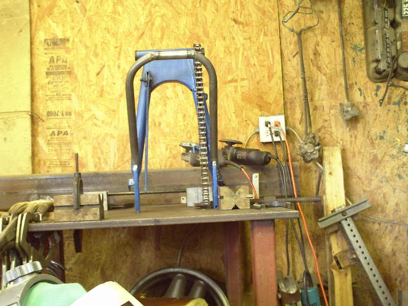

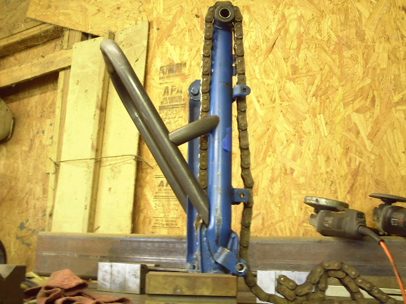

i neglected to take the chain run into account on my first fit ups so the tubes i had bent would not work.so i just welded some tube together to get the chain clearance and to be able to get the tubes fit up and notched and help in layout.then i will go back and bend the lower tube in one bend.not having computer controlled benders makes it time consuming to get correct bends.at $3.66 per foot for chro-mo you hate to miss bend
.it all gets used somewhere tho.
on to the pics,
here i am getting the chain line and gusset tubes all fitted.
the chain line is crowding the area where i want the back gusset tube,so that tube will be bent and fitted to allow ample chain clearance.
on to the pics,

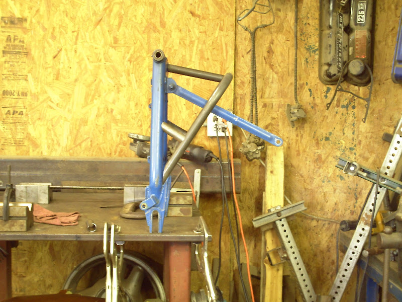

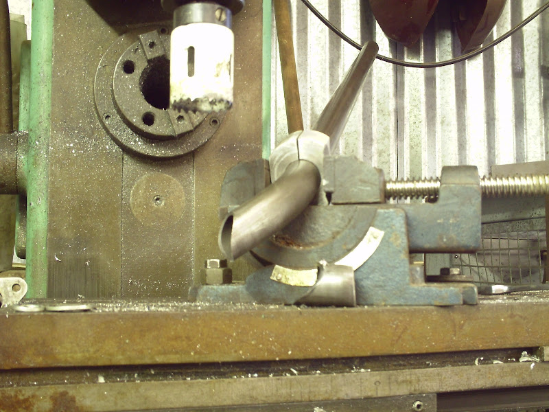

i have a joint jigger for notching tube,but when you have tube that has bends in it the joint jigger can't really accomodate them properly.so i built a tube holding jig for holding the tube in a mill vise then just use my holes saws chucked in the mill.worked great,
here is the gusset tube for the right side and one of the other front tubes fitted.
profile shot
thats it for now,
profile shot
thats it for now,

Wow, she's really coming together! Looking good Leon!
Thats not gonna hit off the tube my center stand used to mount to is it?

never mind, for some reason I thought the center stand tube was rearward of the swingarm pivot, but it turns out I'm just insane.
