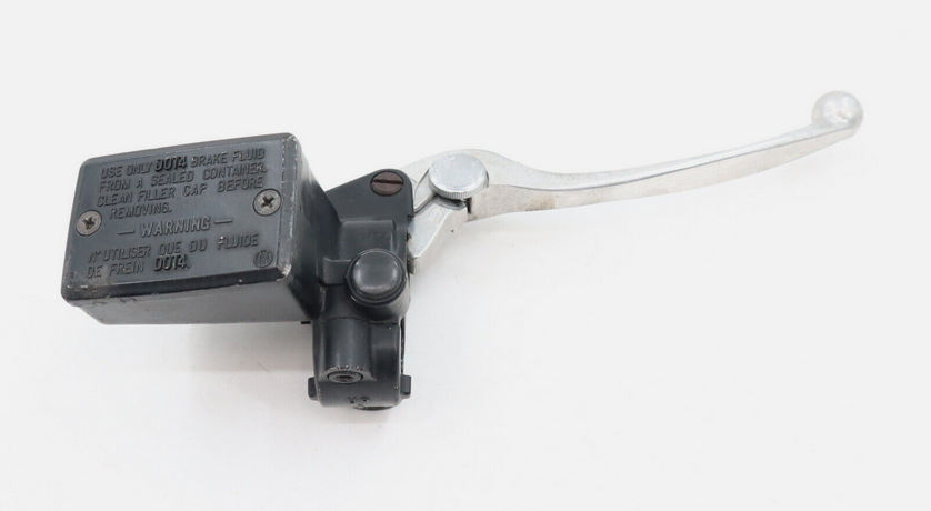

Thanks to everyone who chimed in. I was trying to keep it stock-ish.so I bought this master cylinder from eBay and a rebuild kit from BrakeCrafters. I am into this paper weight for about $100. Life is a Lesson. Guess I will put it on the shelf as a reminder and buy a new one, LOL.

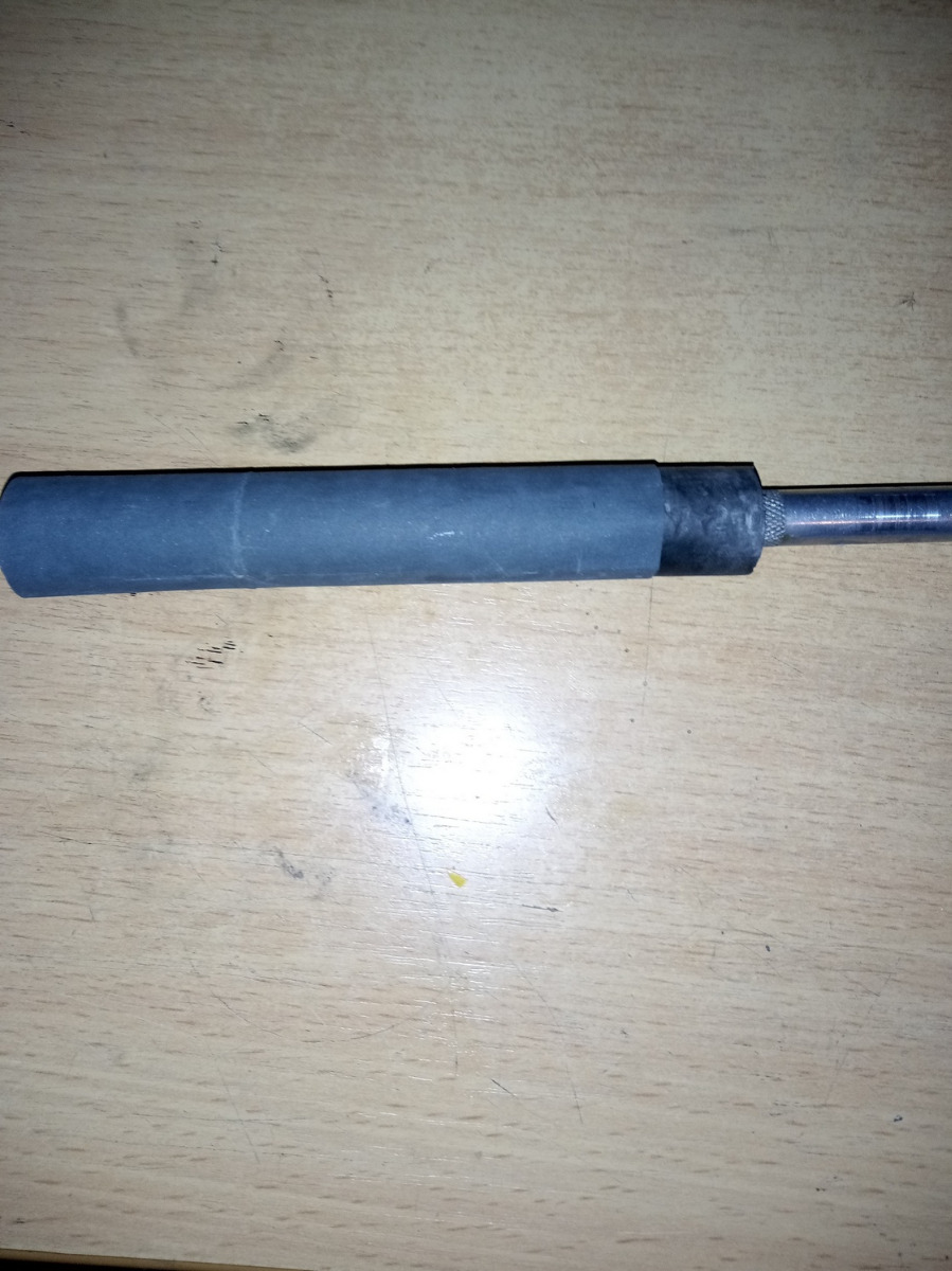

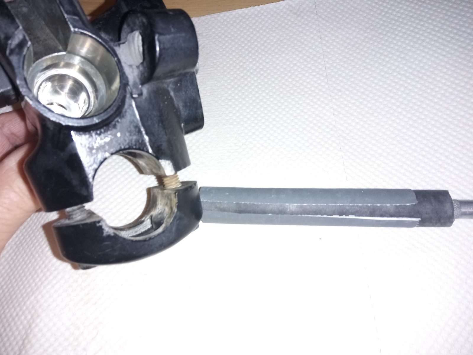

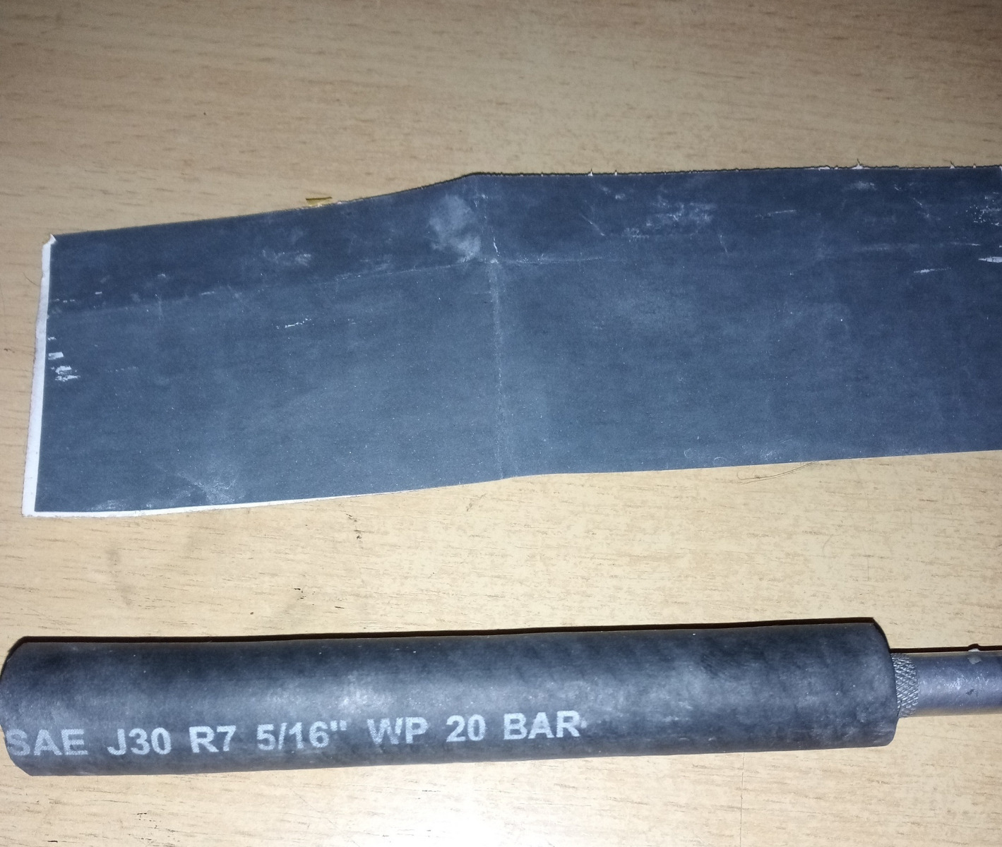

Dont give up yet on the master. Have you tried the good old trick to let it selfbleed? you just tie the lever into the throttlegrip than fill up the reservoir and let it sit over night with the lid off and bleeder screw shut. If it is pitted in the bore ,But not too bad ! you can hone the bore using a
fuelhose tube with wetsand paper taped on it with dublesided tape. The small hole is for air venting out by the way.

that style of m/c isn't very good. the top leaks. finding an alternative can be a pain. for bleeding. get a speed bleeder. or bleeders if it's dual disk. raising the caliper helps.

Rolf i haven't a clue why the metal was used? Of course it's a common theme on just about every car on the road. I use KARPs in California to SS sleeve all my masters, i'm sure there's plenty of other companies that do it too. Yes H1V, those rectangular or trapezoidal type Tokicos always seem to weep-out eventually. And those trapezoidal ones were metal bore too, that's why they are soo expensive. Any moisture will rot out the bore, mostly on bottom of bore where the water sits. I suppose the failure could be contributed to owners NEVER flushing out/replacing fluid as called for though. From my experience maybe one out of ten are useful for reuse. And as Ed mentioned, sandpaper will just knock down the staining. Too much sanding will result in a rocking piston and failure anyway. I never sand mine but use an extra long drywall screw with the screw head cut-off so i can chuck it up in a drill. Then wrap the threaded section with 000 steel wool making sure the screw is centered in wool packing. Shoot a little lite oil down the bore and go to town. You don't want a rough RA (roughness average) in that bore, a drawback from using sandpaper.
