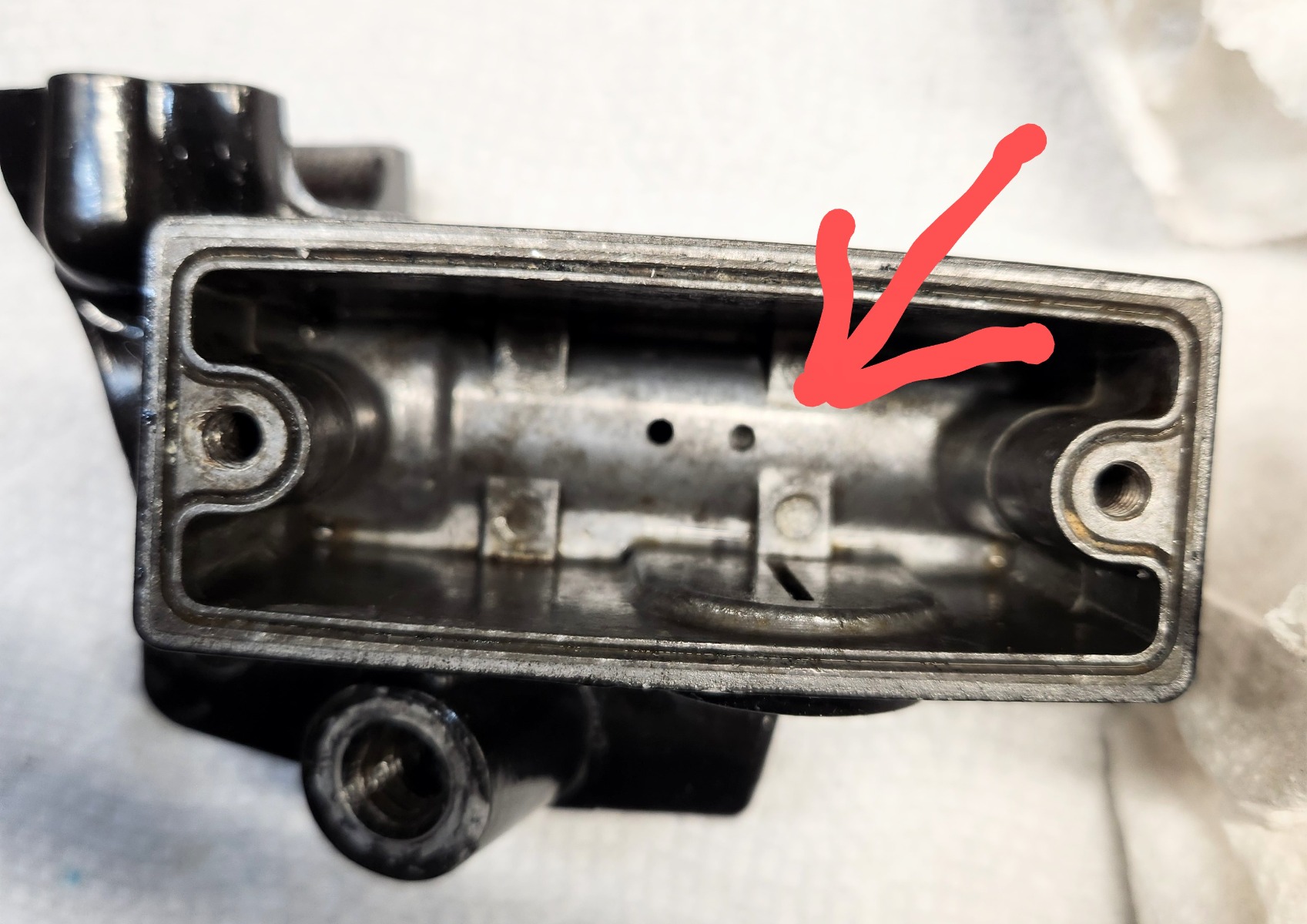

My freshly rebuilt front master cylinder wont pump... Question is, should both holes in the bottom of the reserve be open? Only the one closest to the brake lever is open, the other does not go through to the piston. On the inside of the cylinder, I cant see any sign that it ever went all the way through. But she no pumpy!

Yes, it needs to be open. It is a really tiny hole.

Yes, tiny.
When you pull the hand lever, with the lid off, a stream of fluid will shoot out of that hole, so consider this your warning! The regular wrenchers are no doubt laughing after reading that, since many of us have managed to squirt ourselves, and the bike, learning (the hard way) this nugget of wisdom.

Thanks Fellas, I just used a Torch tio cleaner to clean the hole. It measured out to be .0017" or .4318mm.

07 Feb 2025 12:46Also don't forget brake fluid is an incredibly effective "paint stripper" especially when it gets were you don't want it (another lesson learned the hard way many years ago !!!!!)Yes, tiny.

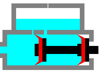

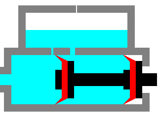

Next question, do the piston cups go in the same direction or face each other? I ask because there is no squirt out of the freshly opened "little hole".
Thanks you guys are Awesome!
Last edit: 07 Feb 2025 14:45 by saltroni.
- Thanks: 2263
Re: Front Master Cylinder Q?
07 Feb 2025 15:56 - 07 Feb 2025 15:57
The piston rubber gaskets should face the same direction.
Small OD to the leveler, big OD to the brake line/banjo bolt.
See animation made by Lou D, R.I.P......
Last edit: 07 Feb 2025 15:57 by Scirocco.
