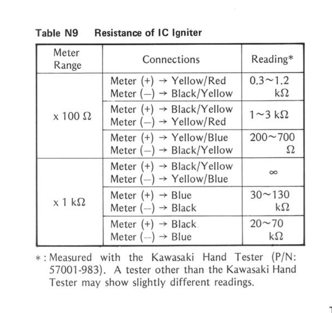

I did the attached test after going through the manual. Battery, coil and pickup coil all check out.
Doing the test below with the Ignitor on the bench, multimeter set to 20K:
1 14.1

Can you post a picture of your meter (set up exactly as you were using it) are you sure (especially with 3 & 4) that the meter polarity was as per the instructions
If you get a spark with the screwdriver test on the pick-up that would suggest that the igniter is OK !! (pick up triggers the igniter which triggers the coil

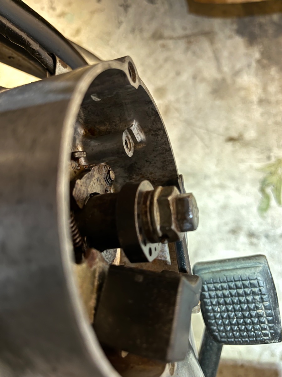

I think I spotted the issue. See the picture below as it appears the pickup has been knocked over. The cover has a repaired hole, so that might explain what happened.
My caliper batteries just took a dump so I do not have exact distance.

Good eye!!!! I think you figured it out.
Yeah, your pickup is nowhere near the rotor.

I have to assume that is somewhat delicate. Do you know if that is glued down or are there screws from the other side?
