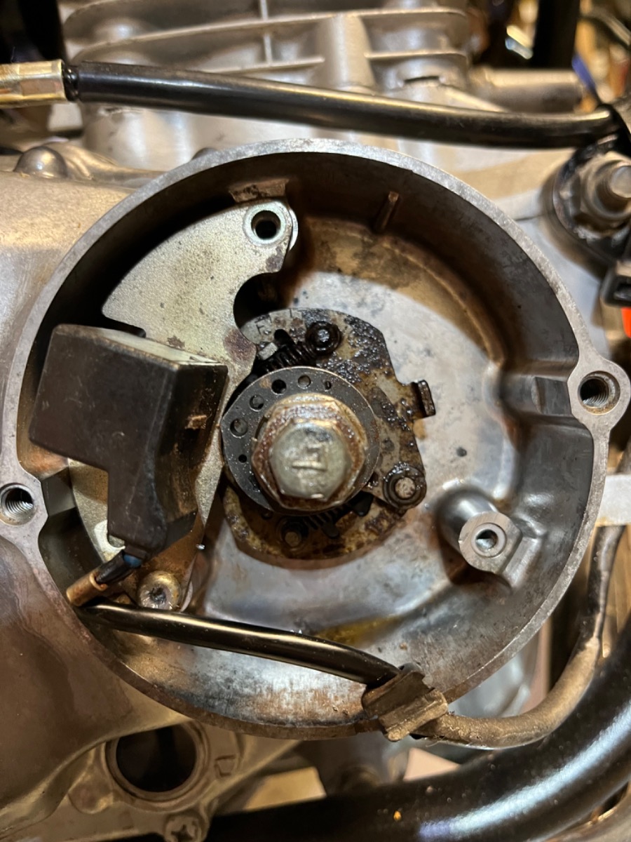

You really want to keep it within 0.5v of the battery voltage.

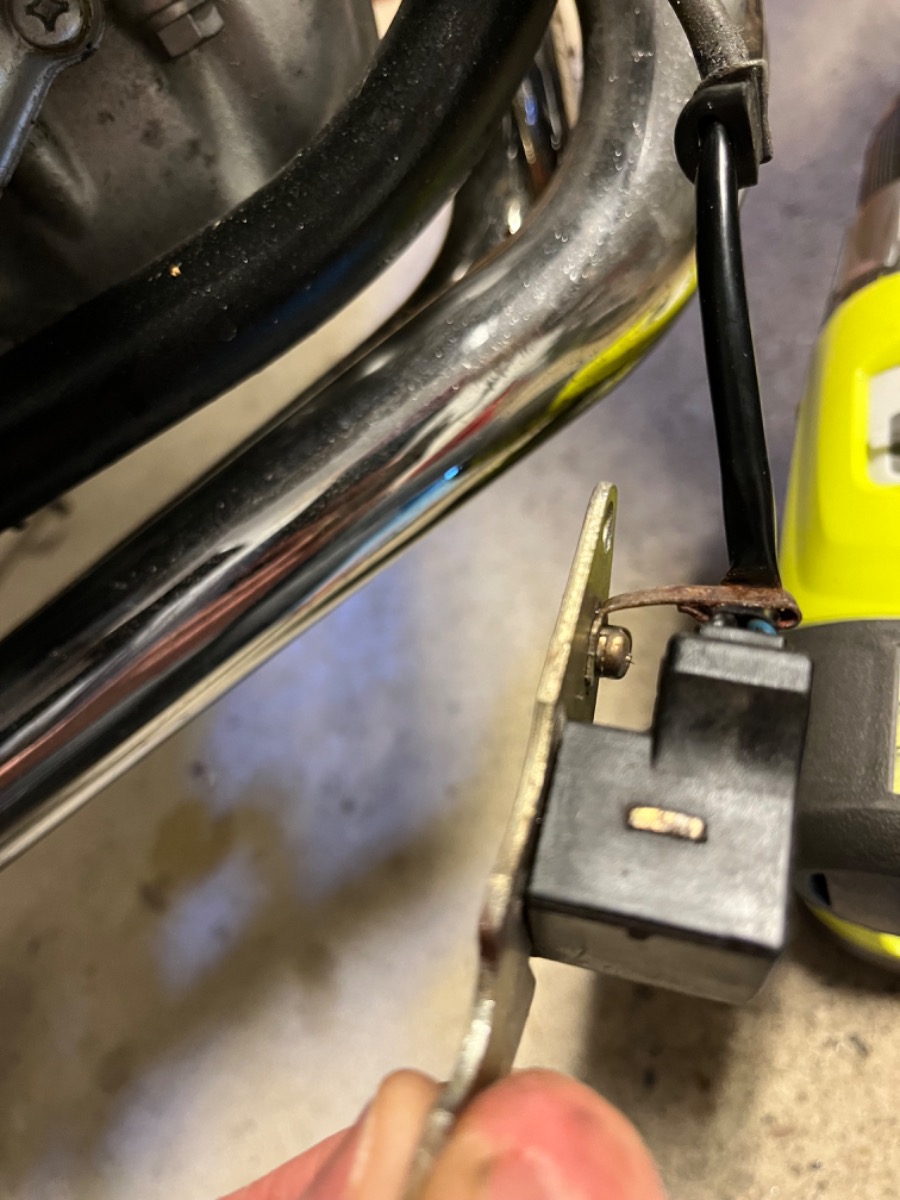

The pickup may be riveted.. i can't remember...
You may try jb weld...and clamp it for 24 hours.
Just be careful as the wires inside the pickup are super thin so you don't want to pull too hard on the wires going into the pickup.
It doesn't look riveted... probably pressed on... but you're going to have to bond it to the plate somehow to make sure the rotor is aligned with the metal protrusion on the pickup
Could you also take a straight in photo of the pickup/ rotor.

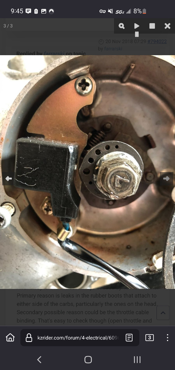

Your pickup should look like this from straight on.

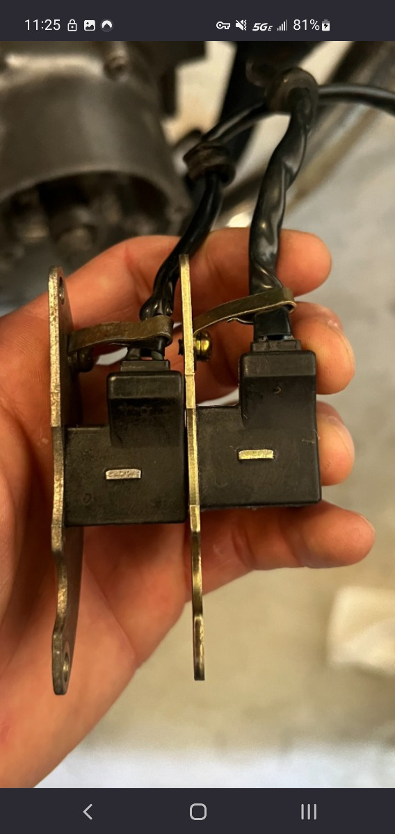

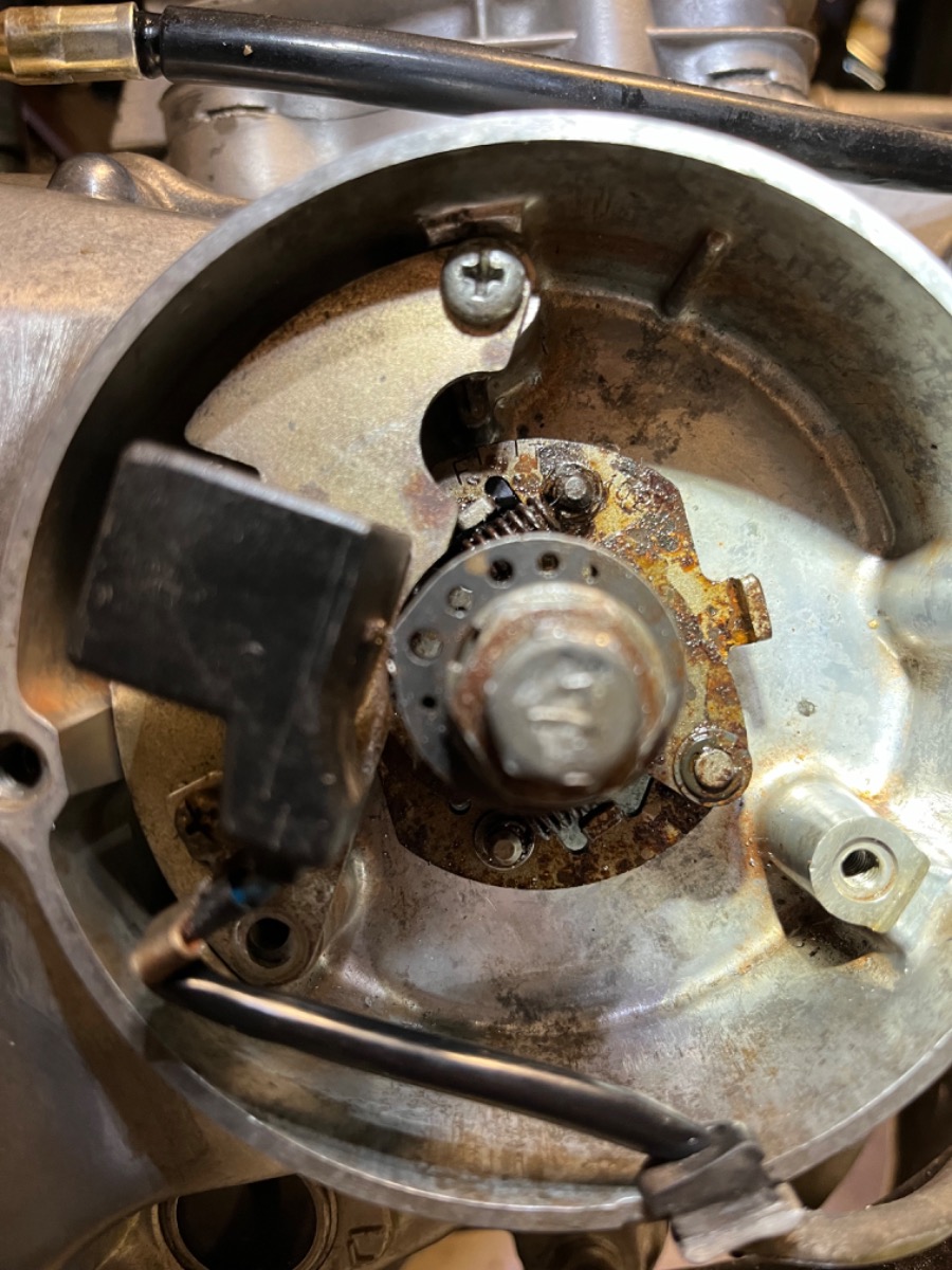

SPARK!! Both sides.
The lower bracket bolt was stripped so it took some effort to get the plate off. I used a clamp to squeeze it back, but it is not flush. Seal the crack with silicone?
Thinking of removing rotor and giving it a bath in Evaporust, then make sure everything is clean and lubed.
Hopefully I can get her started after work tomorrow.

The second picture should be the before…
Thanks again!

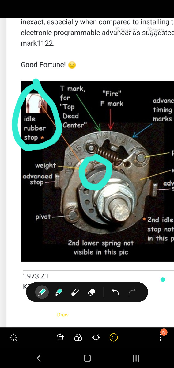

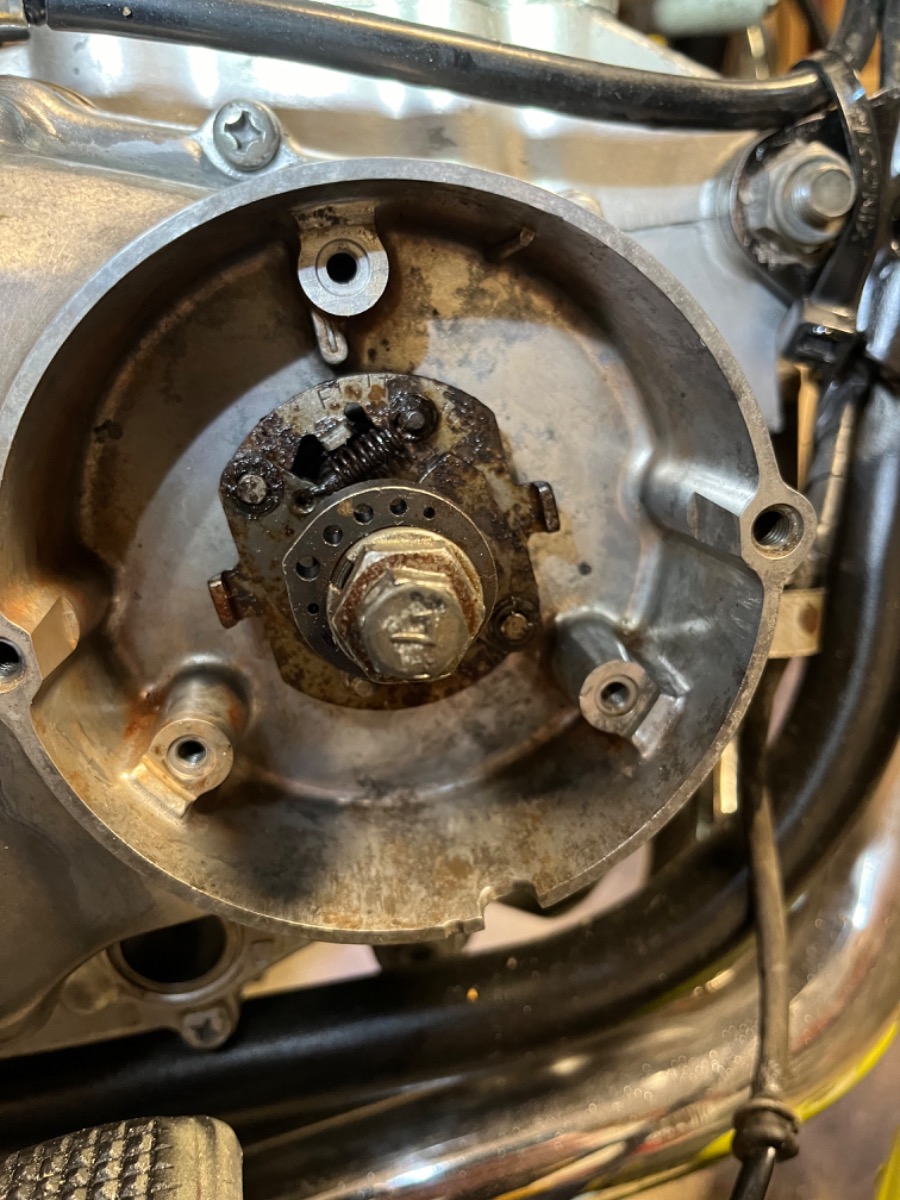

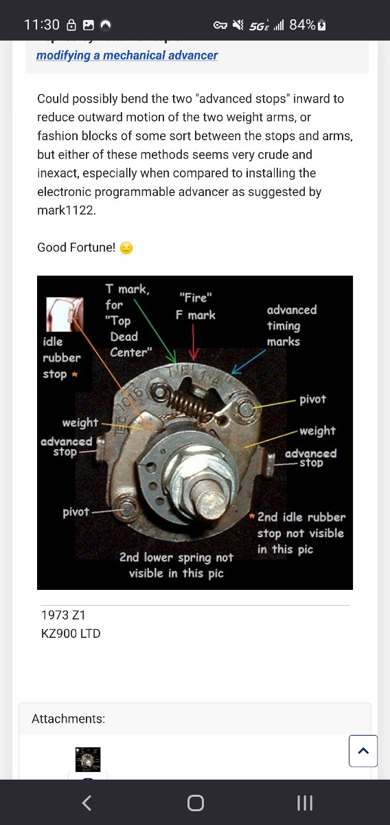

You should also clean the weights and springs below the rotor.
Just be careful about the rubber tips on the weights
Those should move freely when the rotor is rotated. The pickup needs to be flush with the plate. silicone may not have the holding power but you could try it.
This is what that joint should look like.
photo: patton
www.kzrider.com/forum/4-electrical/46182...-mechanical-advancer
photo: patton

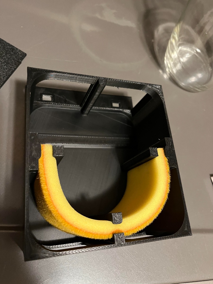

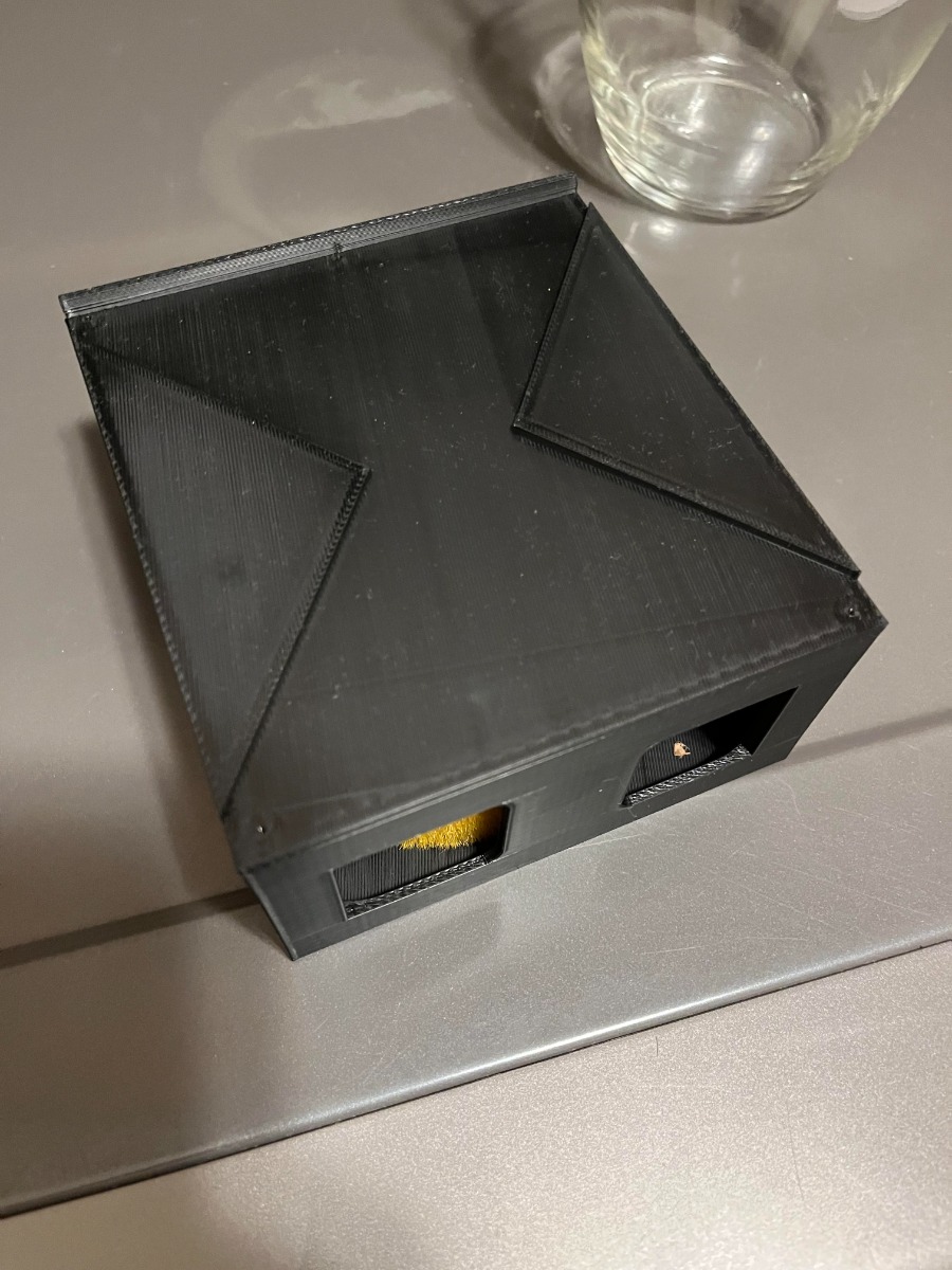

On a positive note I was able to redesign the airbox cover to simplify and also allow better airflow through the filter element.

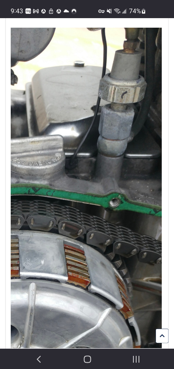

I set up a fan and let the bike warm up and idle for a bit. I tested the switch per your instructions and got 0.0 stopped and OL when running.
I noticed the oil window fills while running, then empties when it is shut off. Hopefully that means the oil is dumping where it needs to be while running and then draining to the lower levels when it stops? No idea if that is correct or not. The window fills to 3/4 at rest and with the bike level.
I keep getting a click, sometimes worse, like something is not meshing correctly. I occasionally get a pretty major chunk sound from the starter motor. The weather has been absolute crap the past three days so I cannot take it for a quick spin.
I tried to capture the sounds in the video below, if that helps with diagnosis. You can hear it at the start of the video and again after I rev the engine.
Sorry to keep asking questions but not sure if it is safe to ride or not.

Your switch and oil pressure seem fine if the bike ran with OL on the meter.
0.0 ohms would indicate low oil pressure.
If your light continues to light when connected to the switch when the bike is running, I would investigate the circuit from the switch to the light.
You may have to put some slack in the oil switch wire. Possibly remove the L terminal to the switch and mount it upside down. Bend it out a bit so it doesn't touch the switch body.
My KZ440 belt has always made the same hiccup when idling. Not sure what it is. Possible misfire is my guess. Mine is fine once I start riding.
The oil will wash over the oil level window when running. It it is getting churned by the primary chain. The only thing this indicated is that your primary chain is turning behind that cover.
