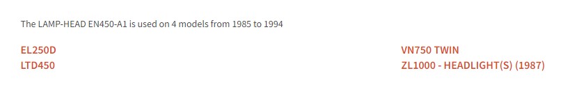

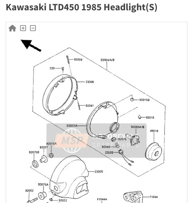

- Posts: 6072
- Thanks: 3810
Re: KZ400 Position Lights
29 Nov 2022 11:07
It took 5 minutes to find this one in the Netherlands (you are in Spain I believe), I am sure you will find what you need

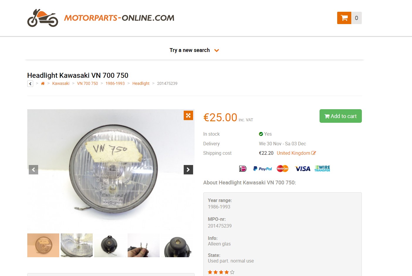

- Feanor_twh
- Posts: 118
- Thanks: 22
29 Nov 2022 13:53 - 29 Nov 2022 13:54It's amazing. I searched for two hours and found almost nothing, and I thought I was a good seeker.It took 5 minutes to find this one in the Netherlands (you are in Spain I believe), I am sure you will find what you need
It seems that it coincides with my headlight, in terms of the location of the main and directional brackets. Do you think it will work? Only this doubt stops me.

- Posts: 6072
- Thanks: 3810
29 Nov 2022 14:20
I'm fairly confident you can make it work, worth the gamble for the money
- Feanor_twh
- Posts: 118
- Thanks: 22
09 Dec 2022 06:54
I finally ordered the headlight for Vulcan 700, it doesn't fit. It has exactly the same brackets but a 1cm larger diameter. I was going to take photos but I remembered when I had already assembled the lighthouse again.
I'll have to send it back.
I'm still looking for an optic for KZ400 with interchangeable socket (H4 preferably but I suppose any other will do) and with sidelight (optional, because I can drill)
