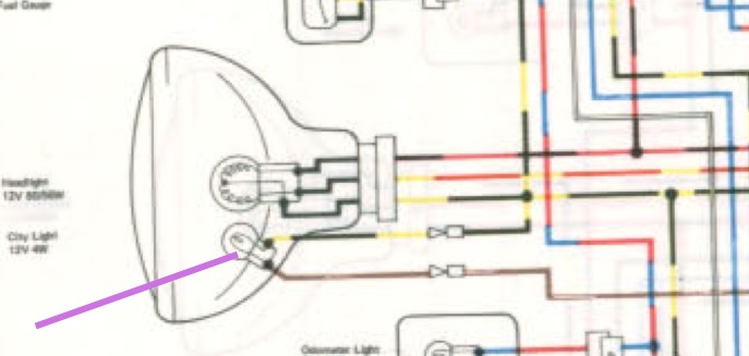

The below diagram shows what I believe you are looking for on a European spec KZ1000j (I am sure there will be others)

24 Nov 2022 01:38That gives me a more precise idea of what I'm looking for. However I have looked in Partzilla and can't find any KZ400 headlights that have that sidelight.

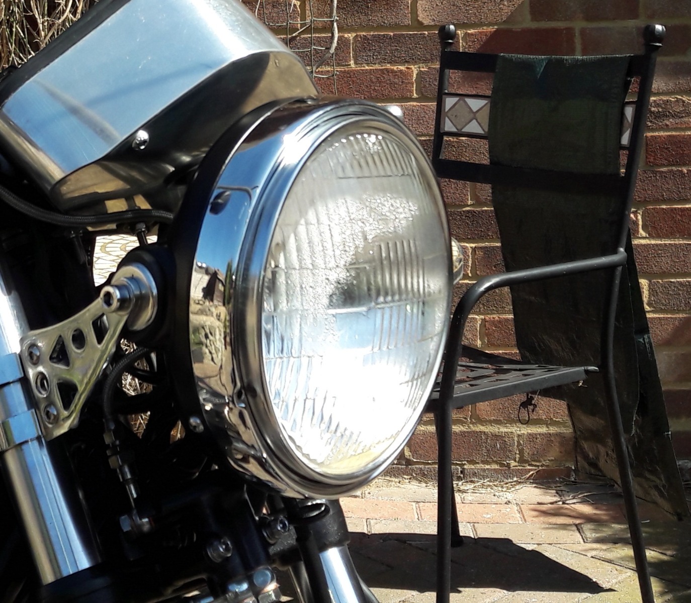

All you need is a 7inch replacement headlight for an original mini also used on hundreds of other cars. You position light is known as a pilot bulb in Europe.
Only thing to look out for is if its LH or RH orientation. They are a straight replacement fit.

The original headlight has tabs that the replacement doesn't, it probably won't fit properly and I'll lose directional adjustment.
I don't mind paying more money for a compatible headlight instead of a cheaper generic version, but I still don't know if there is a sidelight headlight for the KZ400 or which of these headlights from other models would be compatible.
It appears the KZ650 mounted a 7-inch headlight with sidelight, apparently compatible with the KZ400, but I'm not sure.

Trust me, it'll fit perfectly. I've used them on several restoration projects. The black 650 below has one fitted which is an American bike I imported into the UK.
