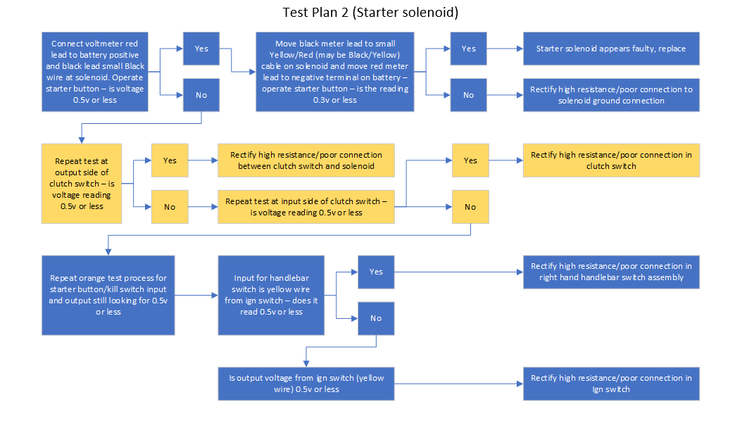

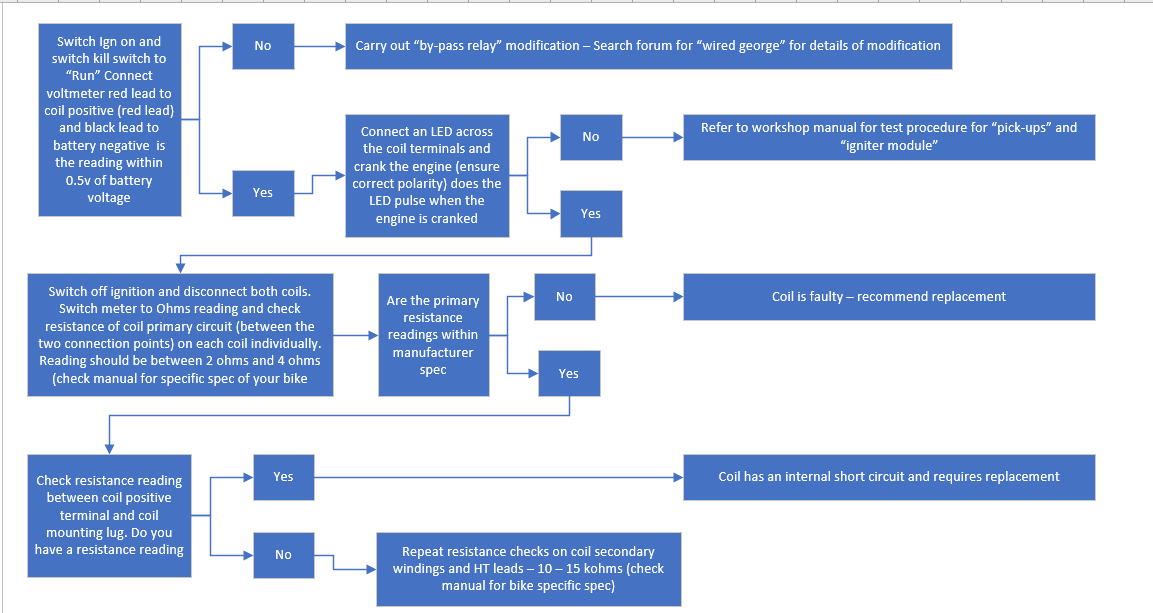

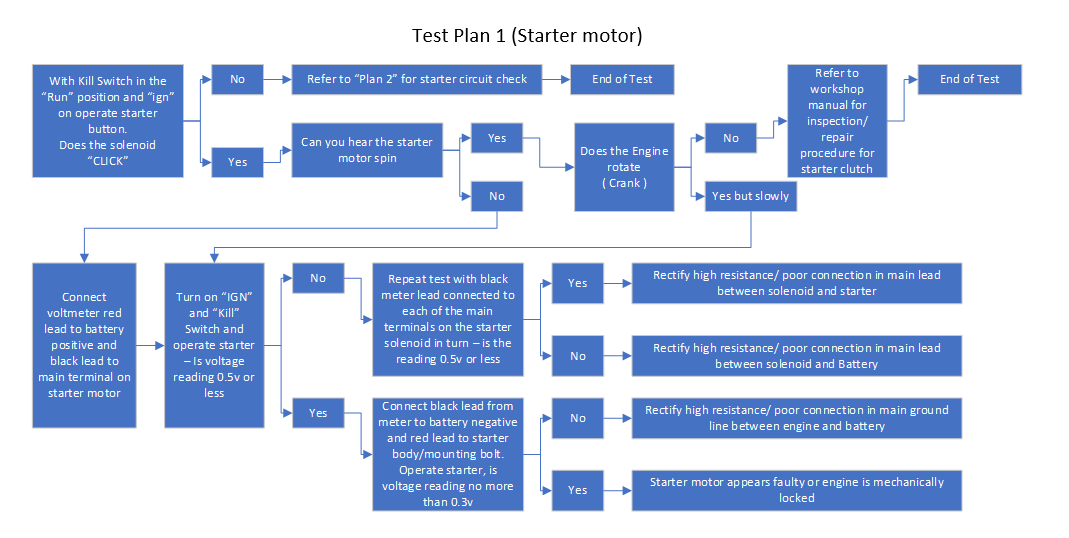

Ok I have included test plans for the starter and ign - all testing should be done on a live circuit with everything connected (except resistance measurements) WARNING: don't leave the ignition on without the engine running for prolonged periods or you will burn out your coils
