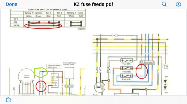

17 Jun 2022 01:58Moose that is really interesting as that isn't how it's shown on the wiring diagram (blue/white for headlight and brown/white for tail and panel lights are shown going from the right switch to power the two 10a fuses) the attached shows that the tail light is only powered from the ign switch in the "park" position ??There's a brown/white coming off the ing. switch into the main harness going to the fuse block. I think the extra brown/white in the headlight is for daytime running lights which I don't have on my bike.
The green circle is where the 2 position light switch is located (brown/white for "PO" and blue/white for "On")

17 Jun 2022 02:03Steve that is pretty straightforward. If you look at the response to Moose all you need to do is swop the blue/white (headlight) with the brown/white (tail light) where they come out of the right handlebar switch

17 Jun 2022 08:36Steve that is pretty straightforward. If you look at the response to Moose all you need to do is swop the blue/white (headlight) with the brown/white (tail light) where they come out of the right handlebar switch
