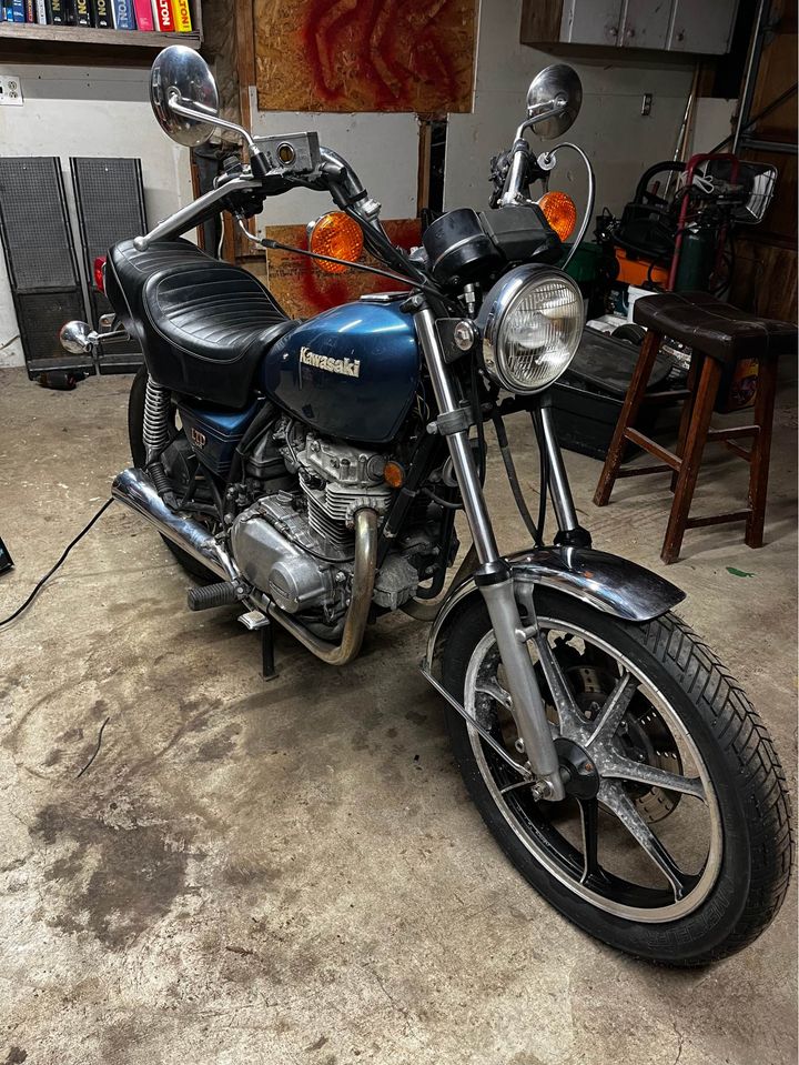

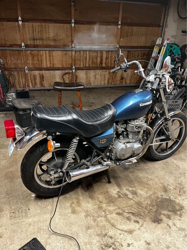

04 Mar 2022 14:31Not yet, these are just 2 nice photos from the FB ad. I'll go see the bike (and likely pick it up) Sunday morning.Do you have any pics of the pic-up, rotor and advancer under the ignition cover?
I am just wondering if this kind of ignition conundrum is a potential deal-killer...
