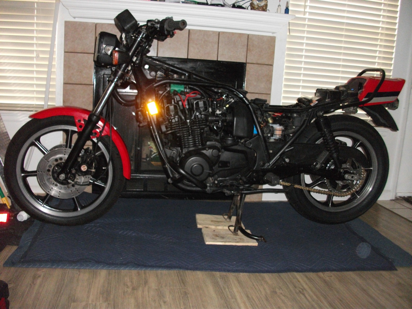

Alright. I'm going to order the kit. I already have the 3-ohm Dyna coils. I'm a little further ahead on the GPZ than the picture shows. Thanks again for the tips, everyone.
Here it is.
Here it is.
