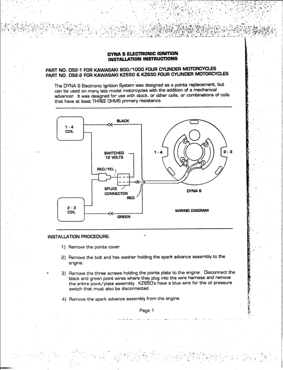

No eBay APP ID and/or Cert ID defined in Kunena configurationThe igniter on my '82 GPZ1100 has seen better days, so I'm thinking of installing a Dyna S ignition like the one in the link below.
This kit eliminates the factory igniter, right?
I'm looking for feedback from those running this kit. Thanks.
