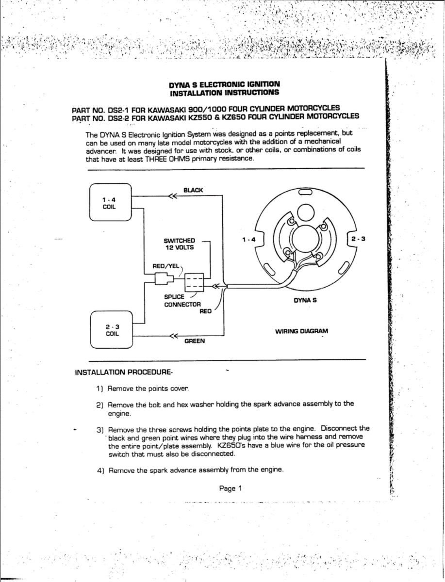

Yes. Stand alone replacement no igniter required.
Just needs switched power from the ignition switch and 3 to 5 ohm coils.

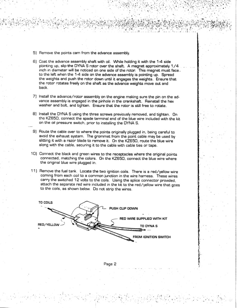

I recently converted my 1980 KZ1000 LTD. Runs better than ever!
I have one beef about the Dyna S system. They recommend using their blue splice to attach to a power wire. I've had issues in the past getting the system to power up so I put a standard bullet connector on the red wire and attached it to the double brown femail connector near the headlight. This is a spare 12 volt connection on the main harness.

I agree with HRM, upgrade the red power wire, don’t use the scotch lock.

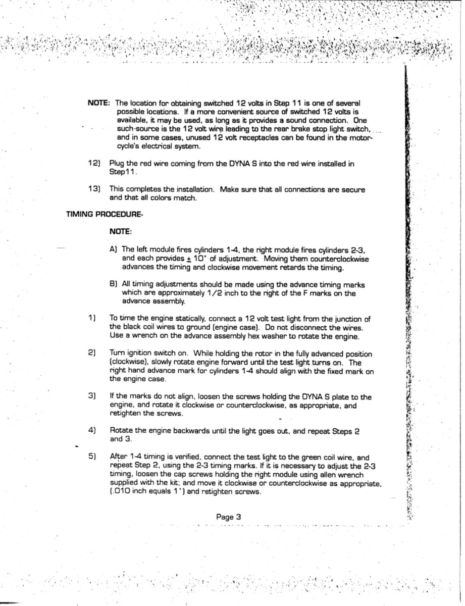

Static time it per install directions and then once started use a timing light and dynamic time.

I just put it on my KZ900, with great results. Ditch the blue splice they provide, I wired it in with the wires they suggest but soldered them together instead of the splice.

17 Sep 2020 07:37zed1015 wrote: and 3 to 5 ohm coils.
As far as I can tell by reading the FSM, the 82 kz1100 has coils with a range of 1.8 to 2.8 ohms, which is too low for the Dyna S. You would need to replace the coils as well.
