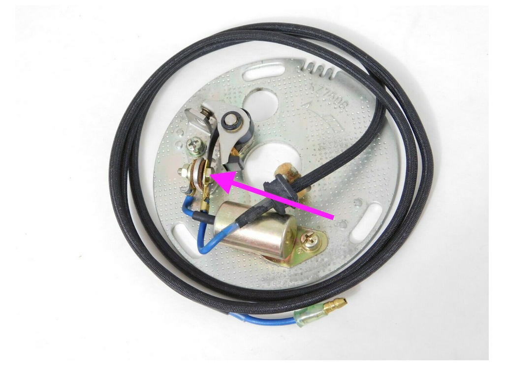

Re: Spark Plug Gap
05 Jul 2020 15:17 - 05 Jul 2020 15:31
Ok
meter on DC V
Bike ignition on but engine not running
Points closed
Red meter probe on negative battery post
Black meter probe on coil negative wire(blue wire).
Note voltage
move black meter probe to the points screw with pink arrow.
Note voltage
The reason your voltage drops when you connect the wire at the coil is the circuit is now under load.
Current is now flowing.
When you do voltage drop testing the circuit has to be fully connected and on.
It's pretty easy when you understand the technique.
photo by charka129
meter on DC V
Points closed
Note voltage
Note voltage
photo by charka129
81-KZ440-D2.
LIC, NY
LIC, NY
Last edit: 05 Jul 2020 15:31 by F64.
