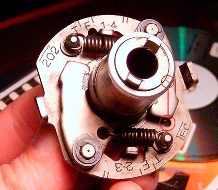

Sorry if this was already covered, but if the advancer was taken apart and put back together at some point and the bike would not run after that, it is possible the cam lobe is 180 degrees in the wrong direction. This will allow the plugs to still spark, but the bike won't run. It might have the appearance that there is no spark inside the engine.
I'm not sure what the advancer looks like on the 750 twin, but there is usually something indicating which way to set the cam lobe rotor. On this 4 cyl model, there is a tic mark on the edge of the rotor that should line up with the "TEC" logo, or possible the hole near the logo.

Thank you. It’s not been covered. I had that issue back in January and was not the easiest thing to figure out. The problem I'm having now is the spark plugs fire outside perfectly right when the F shows up in the timing advancer but won’t spark once installed if set to the gap recommended by the manual (.7mm). If set to something like .35mm or less it will fire, but of course the bike is not running as it should.
