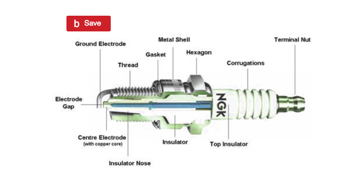

These are the spark plugs I'm using:
www.ngk.com/product.aspx?zpid=9229
