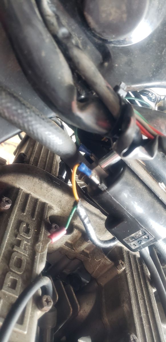

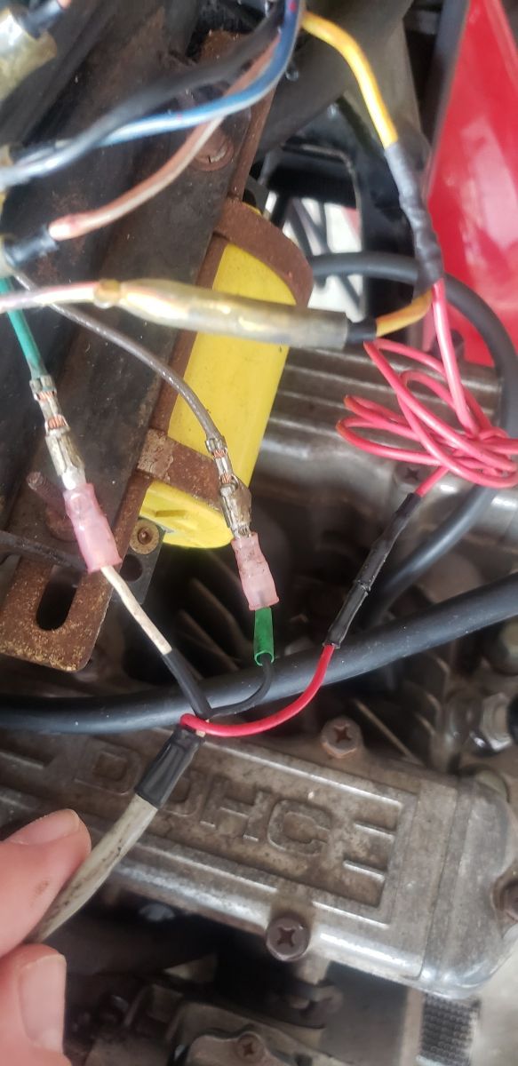

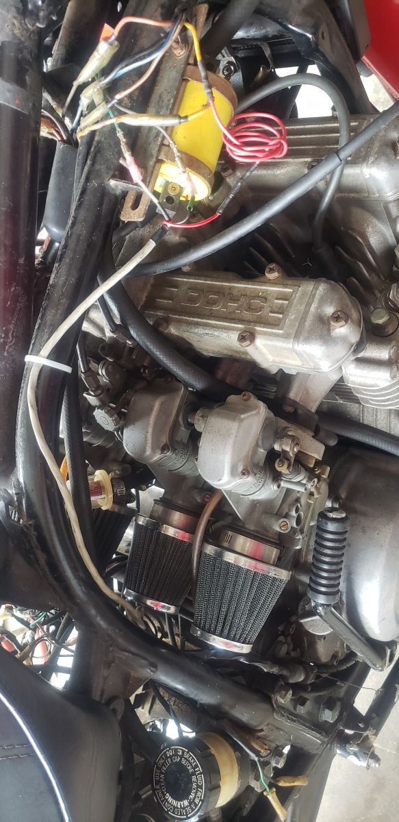

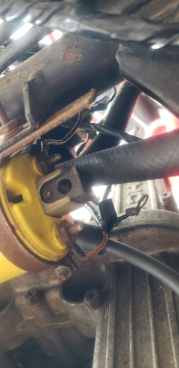

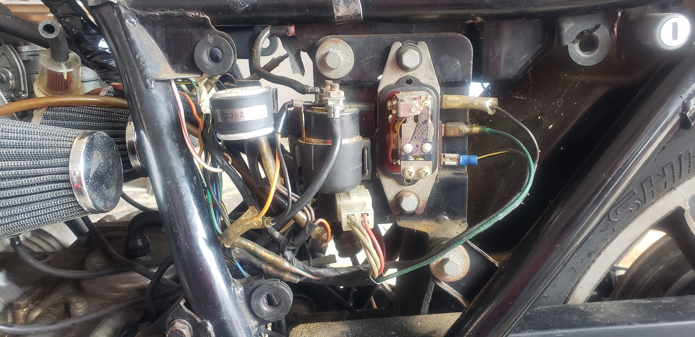

Here is what i have found so far.
1. There are two different types of coils that i dont beleive that are hooked up right.
I dont beleive they are going to the right plug firing order either. There seems to be a extra wire going to nothing as well.
2. The rectifier wires going in to it does not look burnt or discolored. Will get a pic this weekend .
3. Going over the rest of the harness doent seem to bad can fix or run new wire if i need to.
Here are some pics.
If you see anything that i need to do please let me know
Thank you
Here are some pics.
Thank you

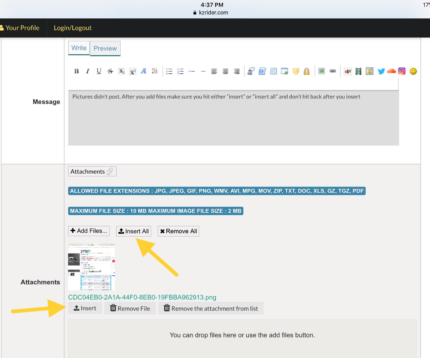

Pictures didn’t post. After you add files make sure you hit either “insert” or “insert all” and don’t hit back after you insert

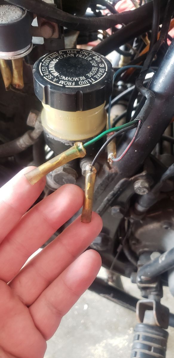

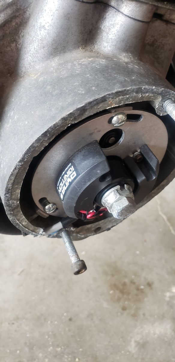

Without seeing were the green (unconnected) wire goes I’d guess it was just dead headed and replaced with the green or black from the dyna s
- Thanks: 2263
Re: 1977 kz650 wire harness
26 Mar 2020 14:41
Holy crap, did i see an yellow accel and an unknown black replacment ignition coil mix mash!?!?
26 Mar 2020 14:45Scirocco wrote: Holy crap, did i see an yellow accel and an unknown black replacment ignition coil mix mash!?!?

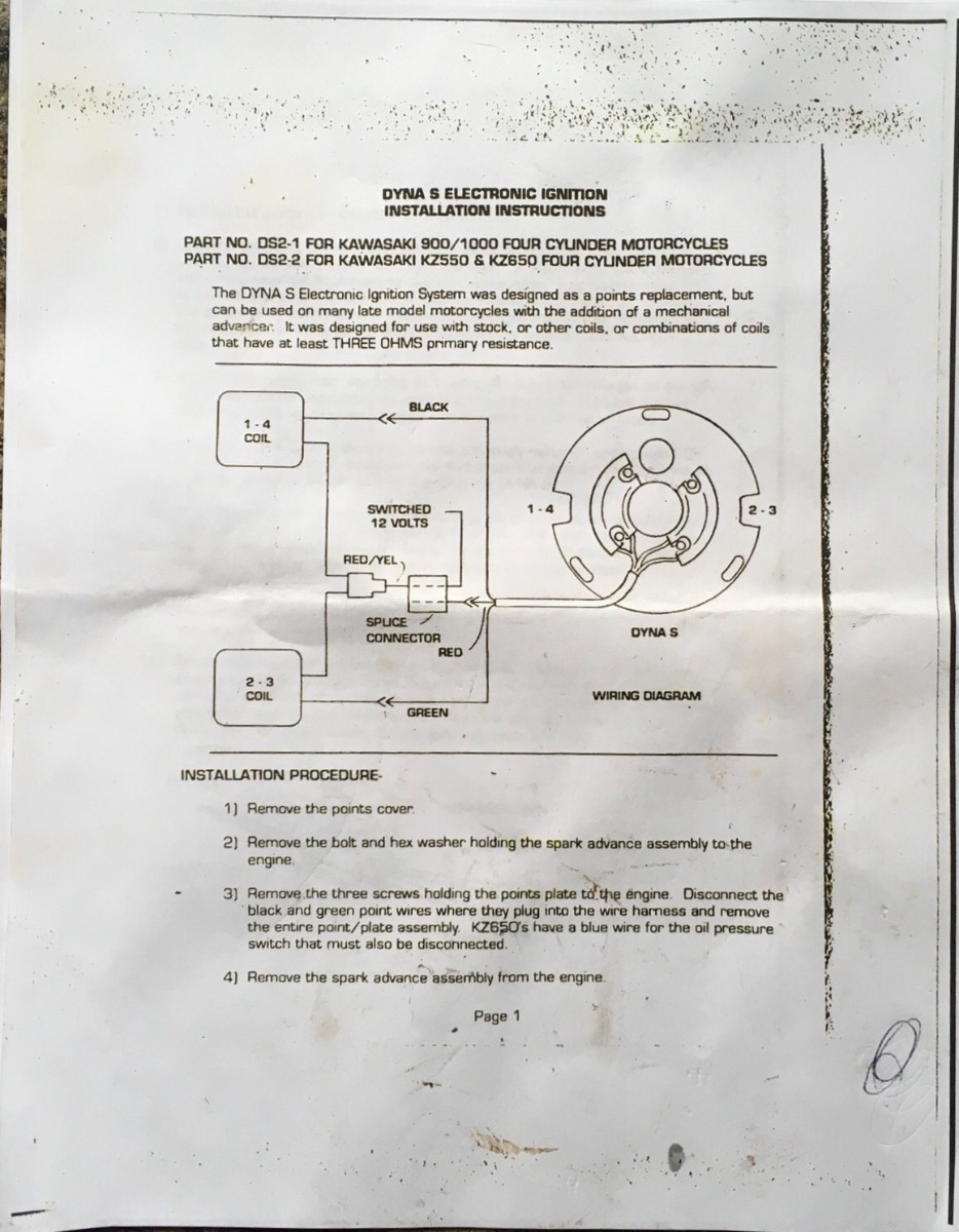

I did! But if you read the dyna s it’s says “any combination of “ as long as they are 3ohms or more. Not optimal but it might work to sort things out and get the bike started

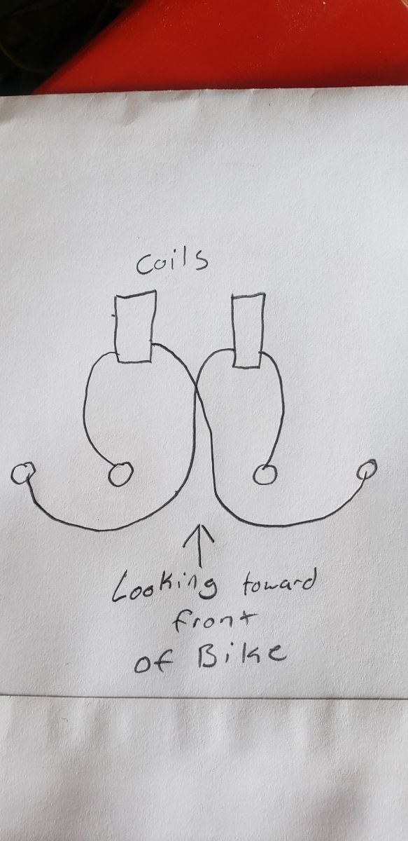

I just went out and looked. It seems they bypassed the black and green wire and ran it up to the coils. It looks awful so i will redo all of that.
I have 3 wires coming from the dyna red, black and white.
Red splices into the red and yellow
I am guessing black should go to black
And white to the green.
And yes the guy put one new coil on it. it looks to be a emgo coil wich i need to check the ohms online.
I will be replacing both soon. Just want to figure all the wiring out first.
Trying to figure out plug firing order now.
I drew a scetch of what they are now. Dont think its right.
