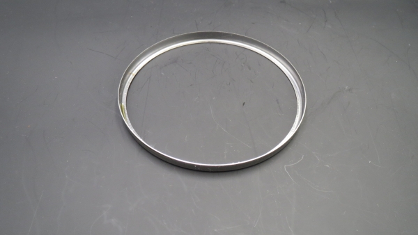

I don't know anything about these. see links. I would fab up a crimp ring holder or something, so that they can be crimped with minimal damage.
Honda CB750 Faces ---Kawasaki parts
www.cb750faces.com/cb750faces.nl/en/48-kawasaki-parts
Honda CB750 Faces ---Kawasaki crimp rings
www.cb750faces.com/cb750faces.nl/en/kawa...-ring-set-2-pcs.html

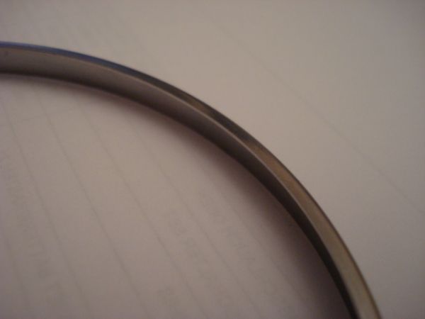

The stainlees steel rings are avaliable!!!
z-fever.de/shop/en/product_info.php?info=p1498_ring-clocks.html
