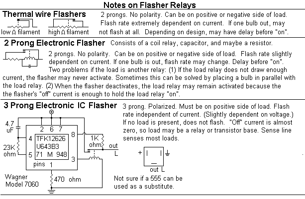

Some of the three pin ones require ground, can you get a pic of the side if there is a schematic printed on it?

One of my bikes has leds. Didnt install them so not sure what flasher but the flasher has a ground . Forgot to hook it to the bat once and no blinky .

Here are some notes on old flasher units. It shows why the 3-prong needs a ground.
The Wagner 7060 was the go-to flasher for LEDs, but I don't think Wagner makes them anymore. Tyco, or some other Chinese company probably has an equivalent or even identical model now.
