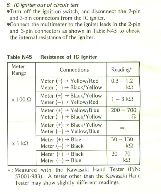

the trouble shooting flow chart of the manual says you should now perform the "IC ignitor out of circuit test" Id go from there.

Unfortunately my multi-meter is auto-range only but this is what I got with it from top to bottom on the list
27.91 m ohm
4.52 m ohm
open
4.64 m ohm
115.4 k ohm
115.4 k ohm
Looks like 90% of the readings are out of range, but maybe I am converting m ohms to k ohms incorrect.

well it seems like you need a new ignitor. the differnece between kiloohms and miliohms is 6 zeros so its way off. i would double check the measurements again first.

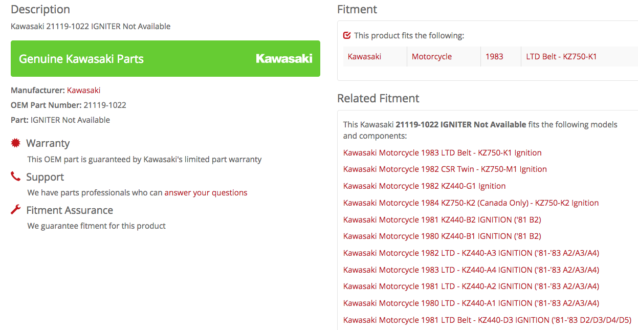

I'm double checked and those are the correct measurements. Guess the next thing is to locate the correct part. All the ones on eBay look pretty rough and I'd hate to spend $50-100 for something that'll fail in a week. Is there any newer options? Would a dyna s work? The part # isn't even listed on the diagram on Kawasakis website so it's hard to search for a cross or something aftetmarket.

As far as I know the only aftermarket ignition for these bikes is from C5 ignitions. They are pretty high tech; optical ignition with optional programmable curves, they ain't cheap though. I'm running one on my bike and have no complaints. great customer service as well.
You may be able to get a dyna s to work but you would be blazing new trails there I believe.
kz440 uses the same igniter if that opens up any possibilities

06 Dec 2018 09:22
Thanks for the part #. I found one on eBay for $35. Hopefully this fixes it. I'll keep you guys updated, I appreciate all your help.

But you mentioned the pickup resistance is .4 ohms. That is not right. It should be more in the hundreds of ohms. Inline fours are around 400 ohms. The twins use a slightly different pickup, but I wouldn't expect the resistance to be much different than 400 ohms.
Also, don't use resistance checks on the igniter as the only test. Resistance checks on active devices rely heavily on the internal construction of the meter, thus the results can vary widely. Resistance meters are really only reliable at reading resistances of resistors. Diodes and transistors can give vary different results on different meters.
The Kawasaki manual is written based on you having the actual Kawasaki multi-tester.
