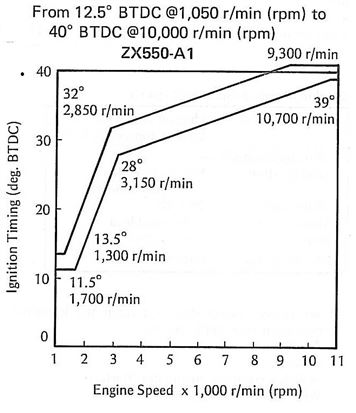

That's interesting. The SW+8 position is really only about 5 degrees more advanced than a Zx550 . Zx550's max out at about 40 deg BTDC.
So the SW 0 would have been retarded compared to a Zx550.

27 Jun 2018 03:29 - 27 Jun 2018 03:32I think the biggest difference starts around the 3000 rpm point, theres 6-7 degrees more than the ZX550 and is more like the KZ550s 35 degrees @ 3200rpm mechanical advance then reaches full advance round 8000rpm instead of 10,000rpm on the ZX550'sloudhvx wrote: That's interesting. The SW+8 position is really only about 5 degrees more advanced than a Zx550.
loudhvx wrote: So the SW 0 would have been retarded compared to a Zx550.
Total advance might be less but its very similar @ 3000rpm, it might even have more advance up from there up to around 8000rpm than ZX550 ,
Im pretty sure i read the ZR's had 35 degrees total, itwould be nice to see the factory ZR550 ignition curve for comparison.

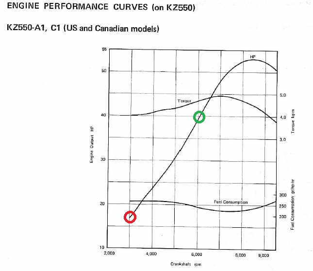

But on a 550, 3000 rpm is nowhere near the power band really.
You would lose time looking for power at 3000 rpm. That would be downshift time or rev and clutch slip time. 3000 and light throttle would be fuel economy cruise mode, and that would be a slow cruise at that.
The kz advance down low is too much
, which is why the mechanical advance is a compromise. Lugging the motor that low while trying to get power would do bad things... Lots of knock. Which is why they went to electronic advance.
For power you would only be concerned with about 6000 rpm and up, maybe 5000.

27 Jun 2018 08:33loudhvx wrote: But on a 550, 3000 rpm is nowhere near the power band really.
I think the factory limits total advance in later years due to emissions.
Exactly!! As the Kawasaki KZ550 performance chart below shows at 3000 rpm (red circle) the engine makes about 17 hp while at 6000 rpm (green circle) it makes about 40 hp. Also, using stock gearing, in top gear 3000 rpm would only propel the bike a bit less than 40 mph. Ed

27 Jun 2018 22:18 - 27 Jun 2018 22:18Wozza wrote: It would be nice to see the factory ZR550 ignition curve for comparison.
I'm curious too. I've never seen one. It's not in the FSM.
Do we know why there are two curves here?
