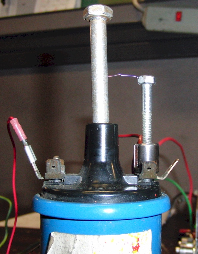

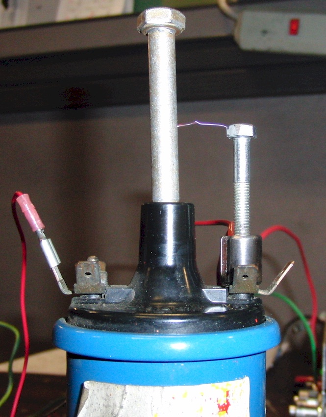

In direct sunlight, you might not see spark, but you should hear it.
In shade on a sunny day, it might appear weak and reddish.
At night, or in any dark setting it will appear blue/white.
Video and photos can exaggerate the brightness and intensity.
This photo shows a good spark, but it is much brighter than what you would see in person. In direct sunlight, you probably would not see it at all.
