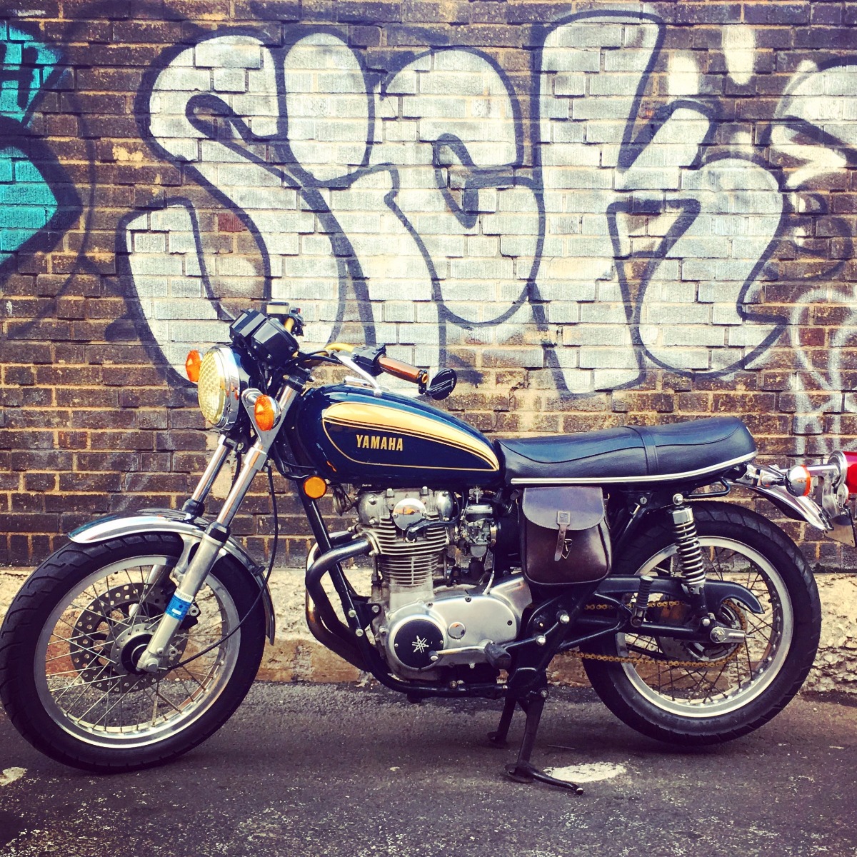

Only happens when the bike gets warm and some say thats a dead giveaway its most likely the coil. This post isnt about my Kawa. Its about my Yamaha XS650, and the problem happened today, ONLY when it gets warm. Its def not the valves carbs or wire. ALL of those things were redone. New wiring harness, valves adjusted etc. Only the coil and plugs werent changed. The bike isnt getting spark = most likely coil. This photo was taken today. It was 83 degrees in NYC:
