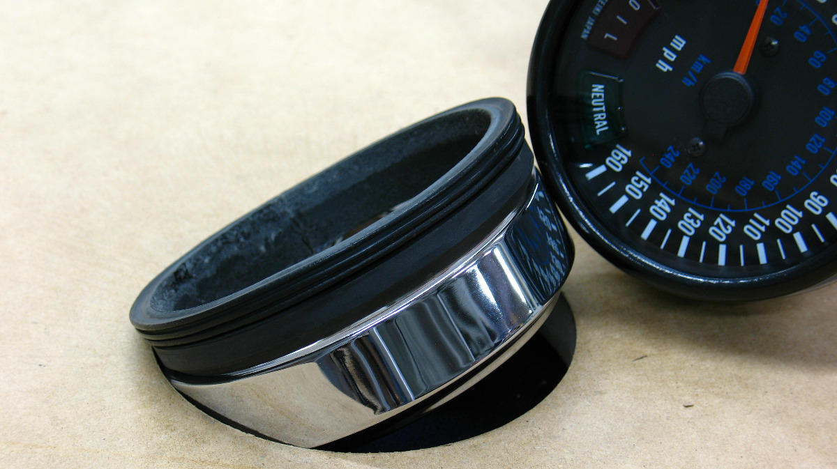

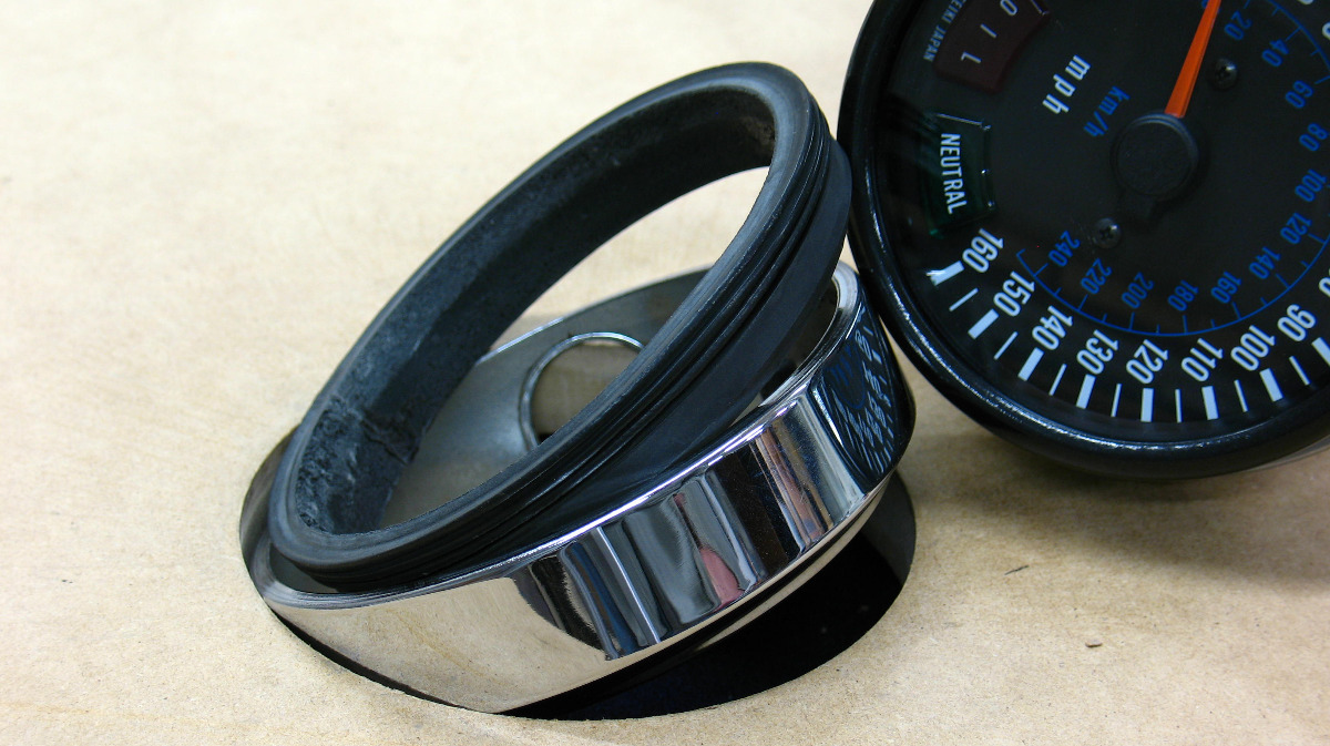

28 Apr 2017 06:02SmokyOwl wrote: Dang, looks like I missed it. Any tips on reconditioning these rings? Mine are ok....ish....but I'd like to get them in better condition. Right now I just have a couple rubber washers under the rear screw to keep things a bit tighter.
If you can for the sake of comparison, post a pic that shows the condition of the meter damper(s) you have...
Condition shown is typical of the set I may part with:

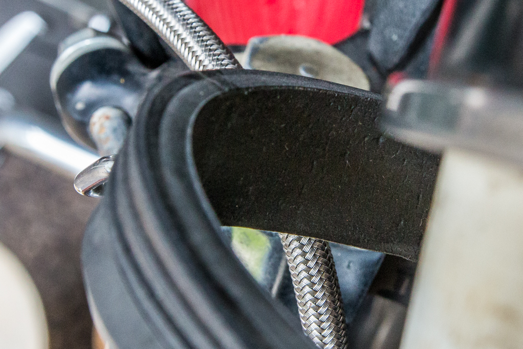

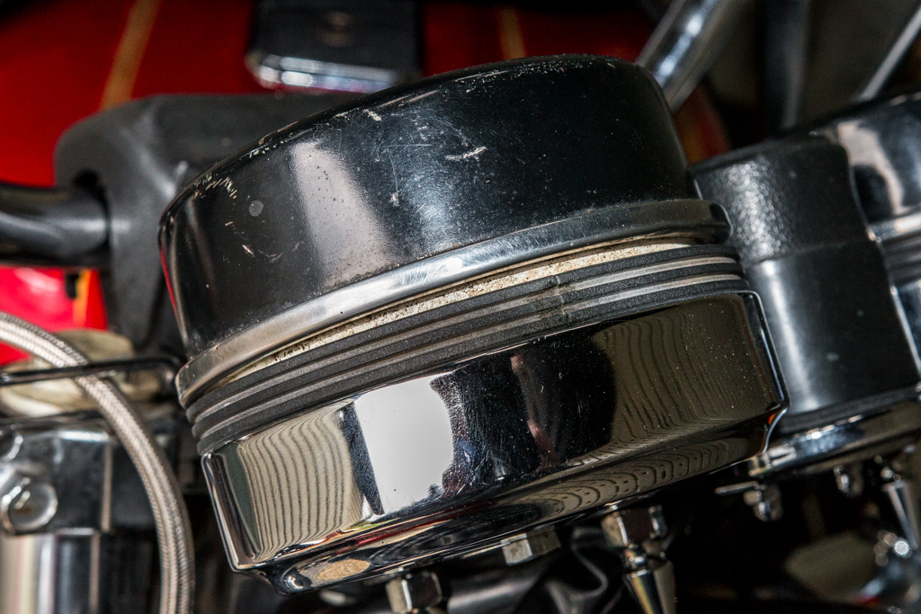

28 Apr 2017 10:15Here's a pic of the inside, it looks like it's pitting on the inside.
But when I have everything installed, the meters are ridiculously loose...bouncing all over the place when riding.
My guess it's a combination of the big rings and the smaller rubber spacer/washer by the bolt degrading. Right now all I figured I can do was put some rubber washers under the chrome metal washer to space out the bolt and tighten everything up.
