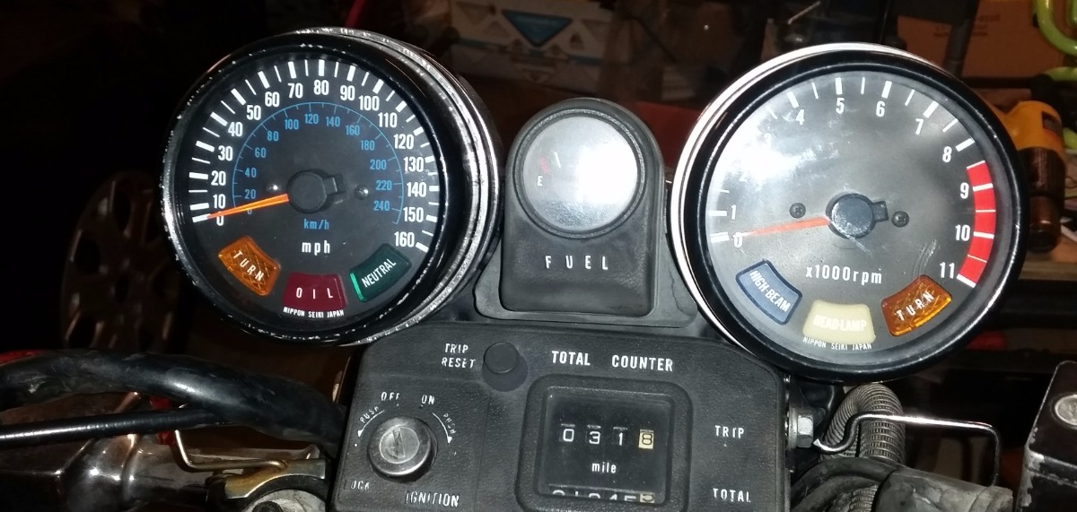

- GPzMOD750

- GPzMOD750
- Posts: 1365
- Thanks: 148
Re: KZ1100A2 Tachometer Bounce
31 Mar 2017 08:12SmokyOwl wrote: I need one of those 160mph speedos, they're hard to come by tho.
That they are. I bought the 2 I found on UK eBay that would ship stateside. The one pictured cost me $165 shipped. It was only the Speedo and it didn't have the silver band holding the bezel on but it sat on a dealer shelf for decades supposedly. Then I bought a complete cluster for $125 shipped for spares.
