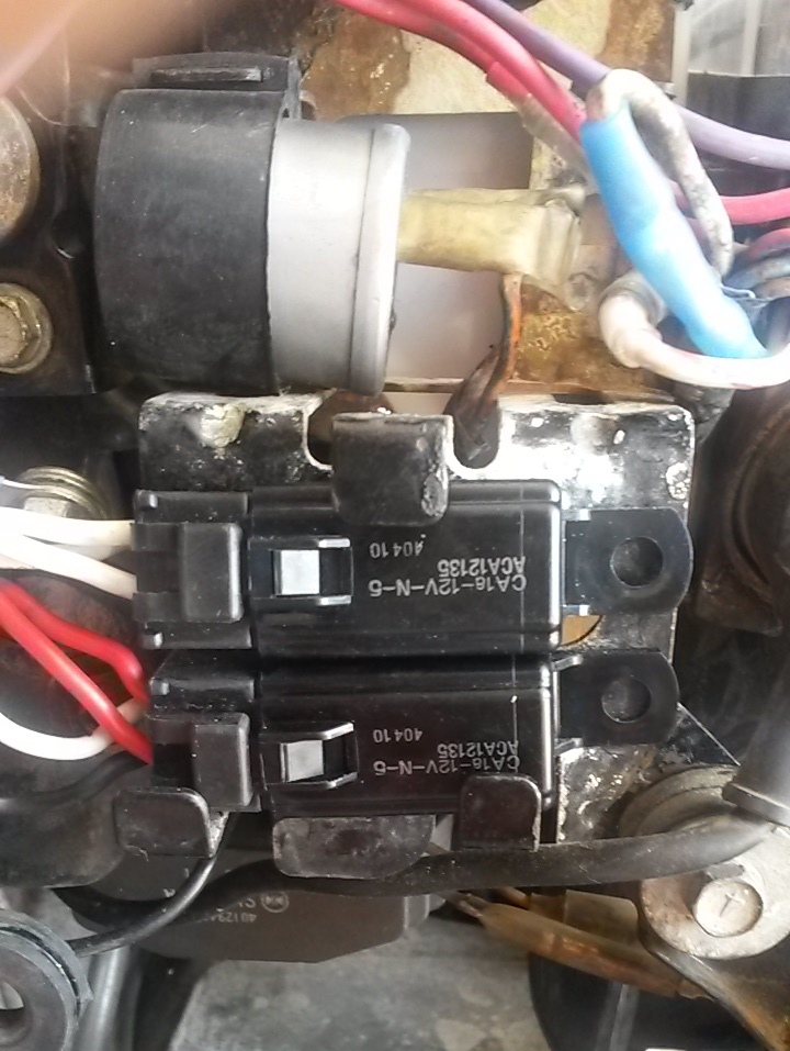

There are generic four pin relays at AZ, OR, etc. They're hanging where the trailer light and such are along with fuses and breakers.

They might be in CA but not in UT.
Believe me I've looked high and low.

If they have 5 pin, just don't use one of them.

08 Jul 2016 17:24Yeah I know how they work but I didn't want to worry about using a massive 30A relay when 20A would suffice. I was actually looking for Bosch 5 pin micro 20A but I couldn't find anyone that had them or the plugs to go with them. These Panasonic type are much nicer and are specifically for motorcycle applications.swest wrote: If they have 5 pin, just don't use one of them.

They have different types. 30 A is the max load it can carry.
www.rockauto.com/en/moreinfo.php?pk=6337488&jsn=269
www.rockauto.com/en/moreinfo.php?pk=634928&jsn=272

Those are big blocky monstrosities compared to these that fit side by side in the same spot that the original fuse box was.
www.cycleterminal.com/accessory-relays.html
I do know a few things about relays and fuses.
This is a Taurus fuse/relay box I installed in a '79 F150 I once had.

They're no bigger than them.
