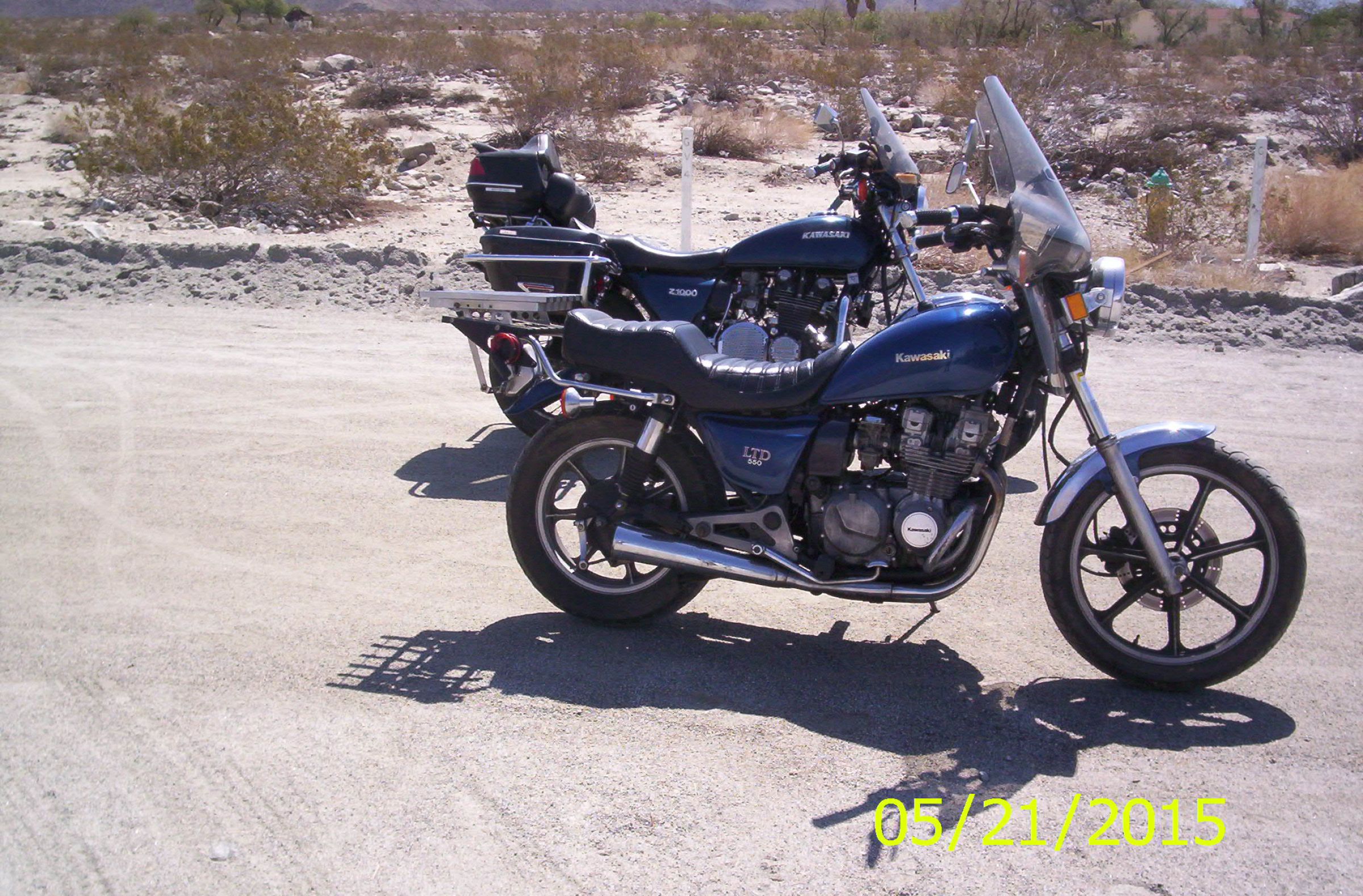

Well....Pic of the bike?

There's one as my profile pic, but here's a couple more.
