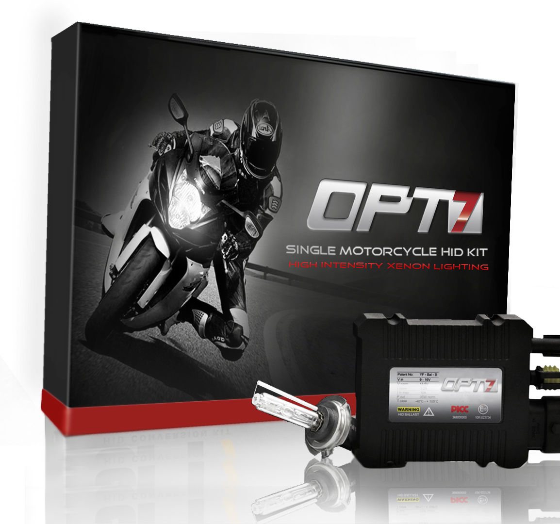

No eBay APP ID and/or Cert ID defined in Kunena configurationI got a HID.
kzrider.com/forum/4-electrical/602108-new-bulb#721497

You should not need to change the housing regardless of what type lamp you use. However, you may need to change the lens.
The KZ1100-A2 came with an H4 type headlamp. This type has the replaceable bulb that fits into the lens. There are aftermarket HID and LED bulbs available that fit the H4 lens configuration, so the housing is not an issue. Depending on the bulb, it may be necessary to replace the lens with the bulb, but the new lens will still fit in your existing housing. This lens replacement may be required to ensure the light emitted from the lens is spread in such a fashion as to provide good visibility without blinding oncoming drivers. If you surf the web a bit you should find multiple options with reviews, etc. to help you decide. Ed

My lense is from a motorcycle. It works fine with the HID.

The above site mirrors my worries about the bulb damaging the lens with an HID bulb. (I meant requiring a new lens instead of new housing in my initial post) I've heard stories of higher heat off the bulb melting the lens in cars, I'd imagine it'd be a similar scenario with motorcycles. Stumbled upon this thread too that spiraled downward into an argument about HIDs in an H4 setup: www.candlepowerforums.com/vb/showthread....H4-for-my-motorcycle
My local shop pointed towards this $60 light, looked like an LED to me: flat white strip with a yellow circle on the end. He said it was awesome bright, but without knowing more detail he couldn't guarantee fitment. I'll see if I can find it. LEDs run much cooler and should be safer for the lens right?

I'm considering a headlight alternative also. When my stock unit is adjusted to the best low-beam position, then the high-beam shines way too high. :whistle:
Would that be the nature of the reflective beam pattern produced by the stock headlight housing, or might that be corrected by a better bulb choice, such as the OPT7 that Steve suggests?

My headlight is from the 550 In bought. It's glass and says motorcyle on it. It is meant for a H4. They run hot as well. Halogine. No problems and I run it day or night.
They just want to sell you a new one. :dry:
