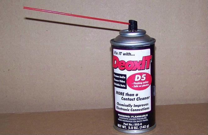

Clean all the connections, etc. in the starter and ignition circuits. The stuff shown below is THE thing to use. Radio Shack and others sell it. Ed
