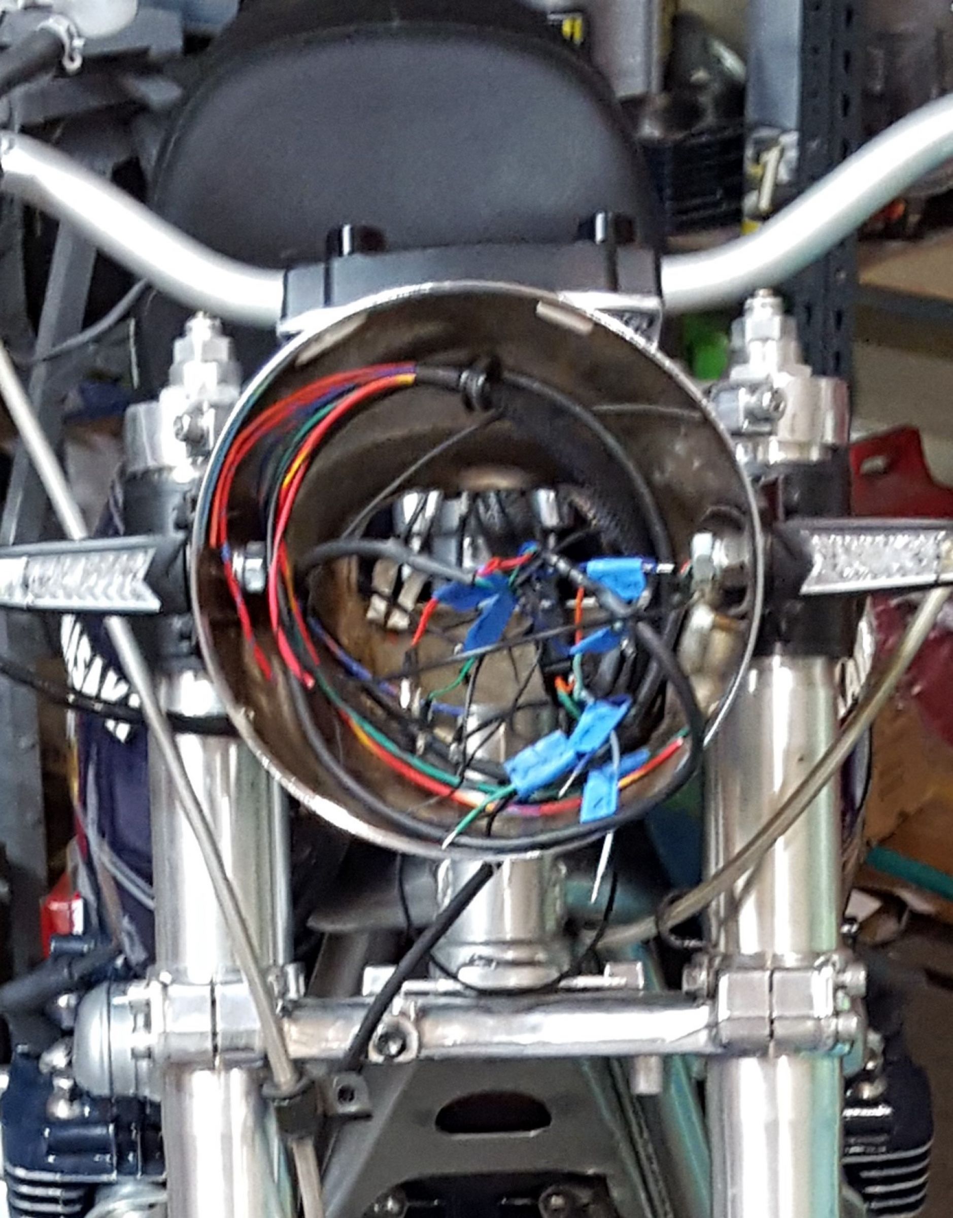

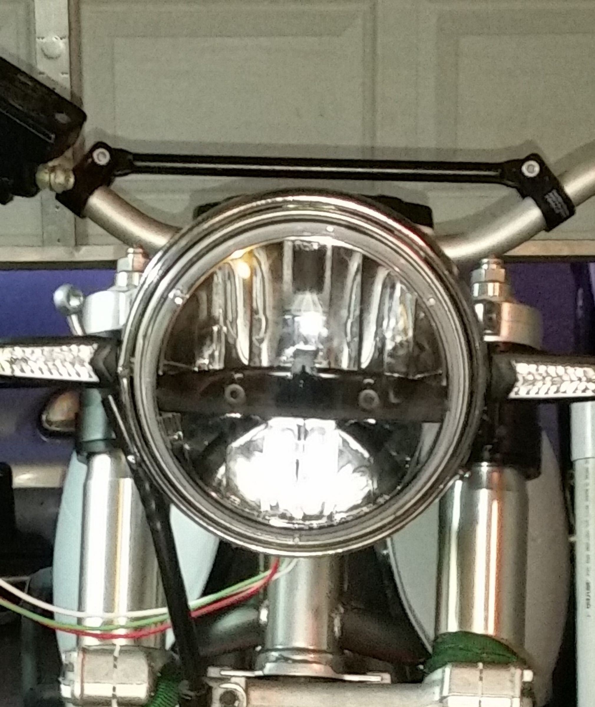

20 Apr 2016 22:20Rave71 wrote: So that whole unit will mount behind the bezel of the stock headlight assembly?
Yes you take the ring off the stock head light place it on the new one. Here are some pics of mine.

Awesome, looks really clean!
