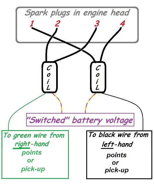

13 Mar 2016 19:41If not already done, would assure that the ignition coil firing the two inside spark plugs has a primary terminal connected to the signal wire (usually green) that's coming from the 3 o'clock set of points, And that the ignition coil firing the two outside spark plugs has a primary terminal connected to the signal wire (usually black) that's coming from the 9 o'clock set of points.

I have connected the ignition the right way and got a mechanic to help, but sadly it still did not start.. I have ordered a new set of condensers and will try to measure the voltage between the coils and make the plug against plug test and return with a update.
