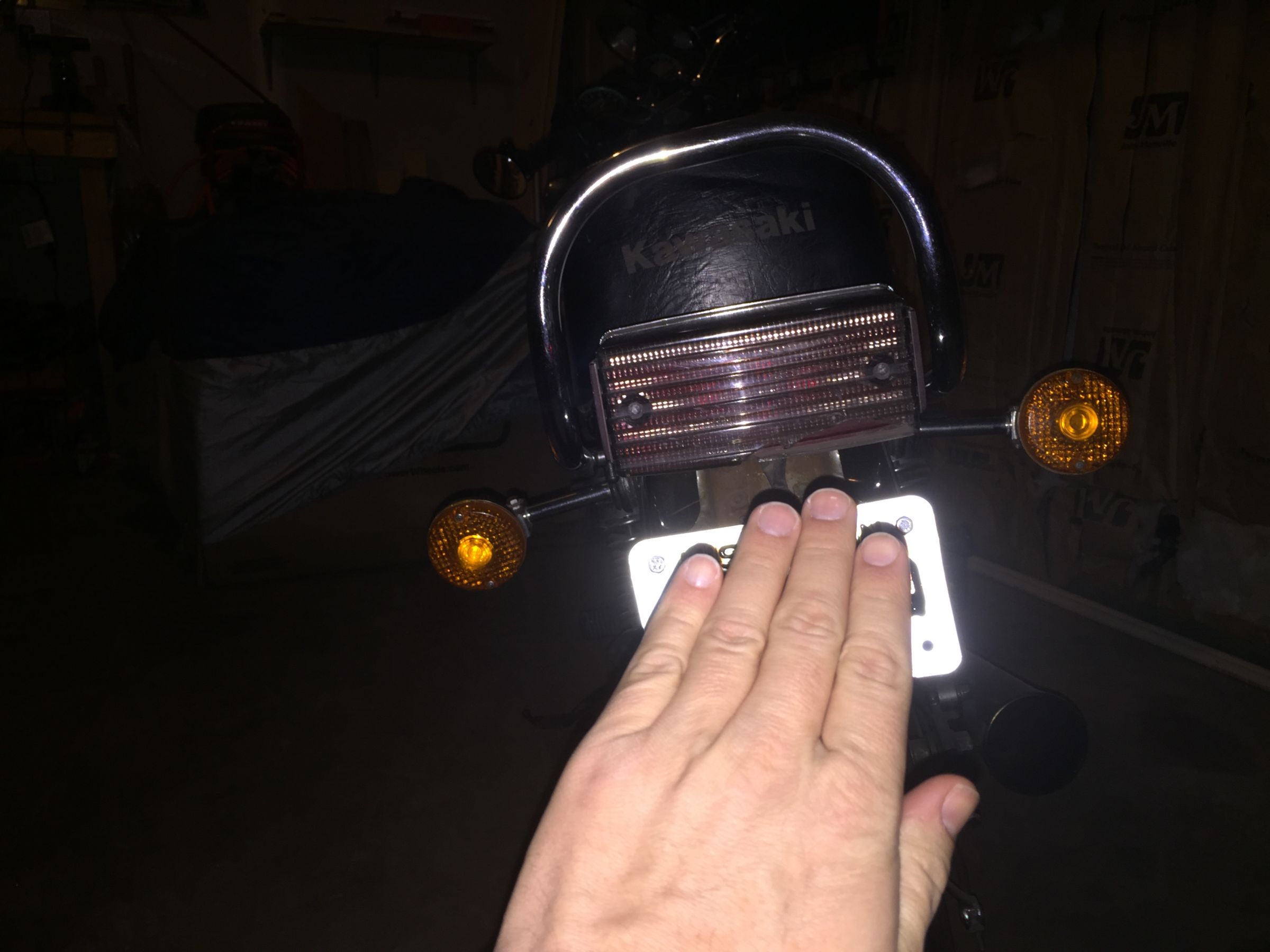

Try another relay. Pics of the signals?

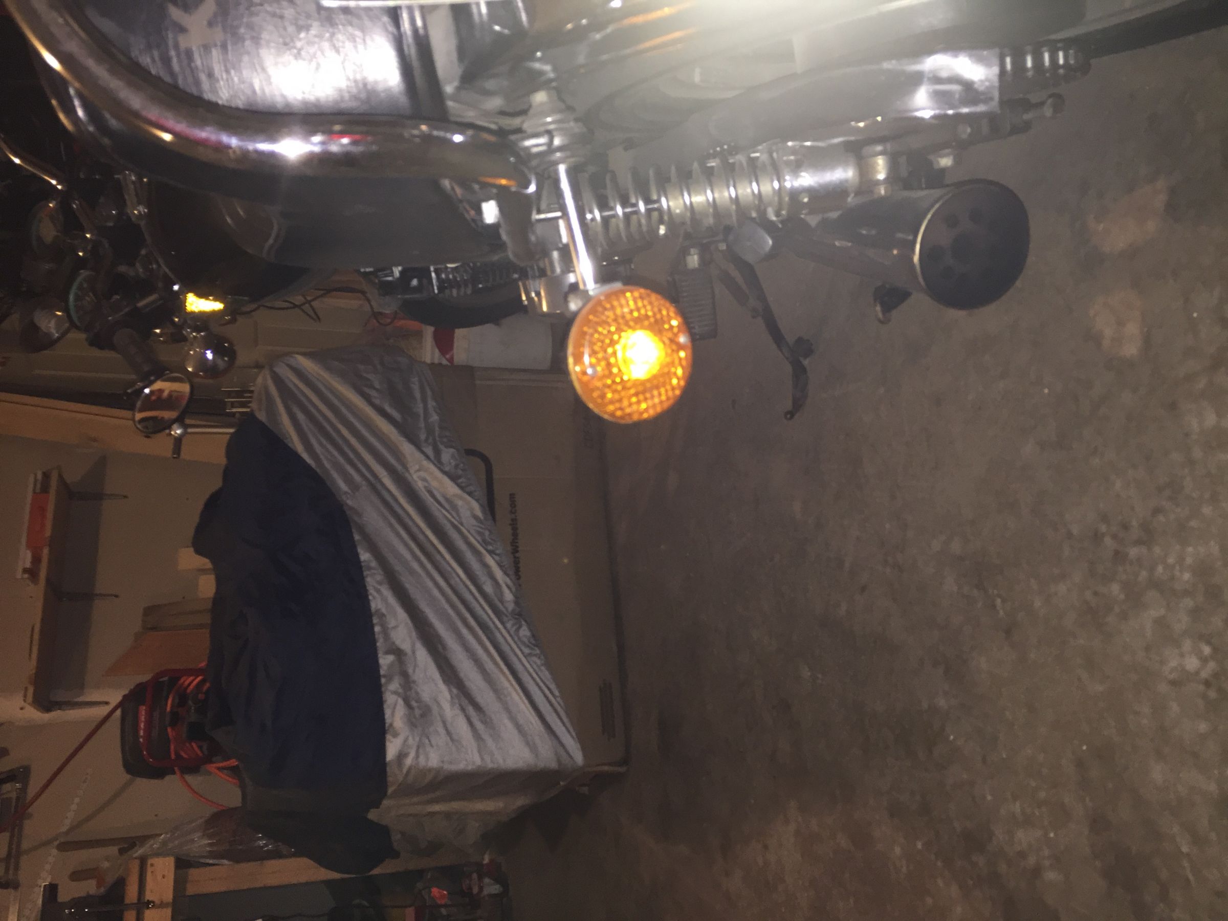

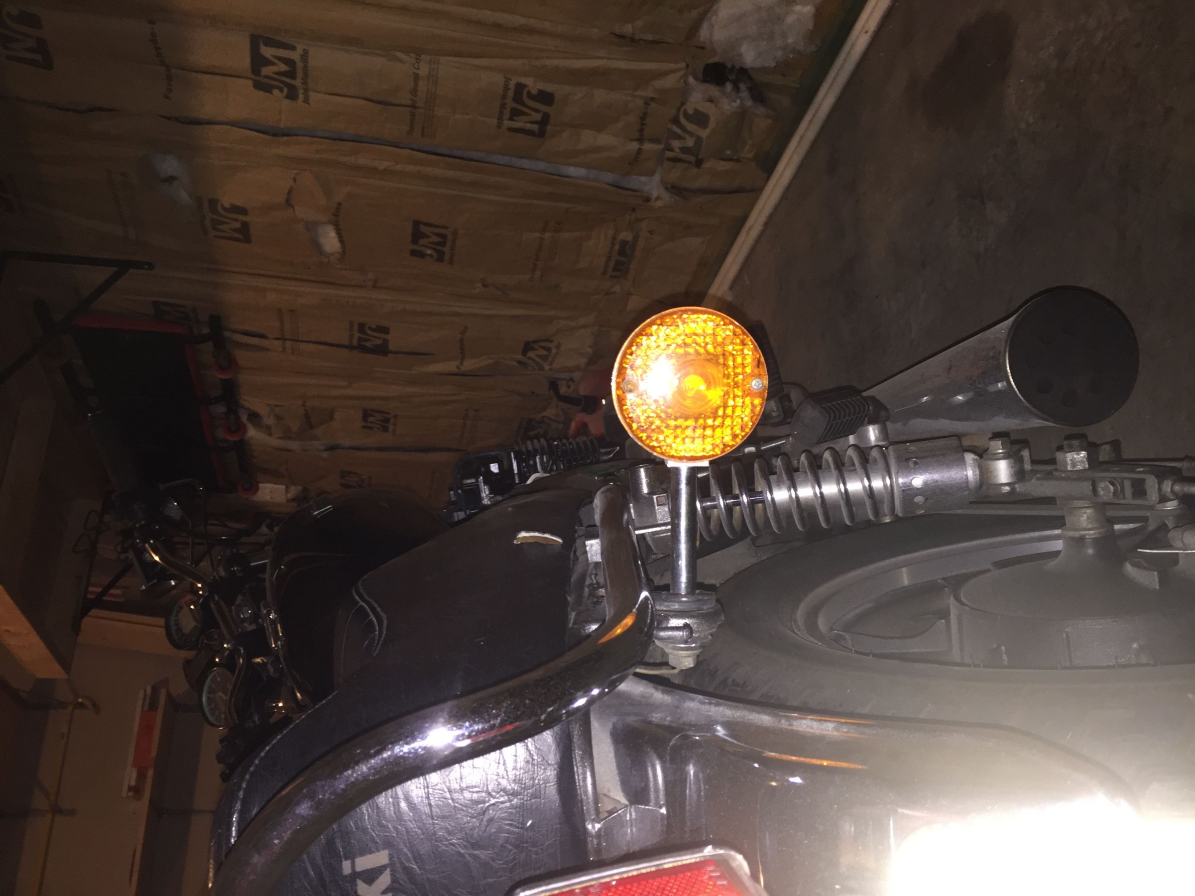

I believe the parts are all there, but MAYBE part #25 isn't. I remember installing them and having trouble getting the nut on tight because I didn't want to use a tool to hold the stalk in place and marl it up, so I held it with my hand on the housing part.
Here are a few pics...
