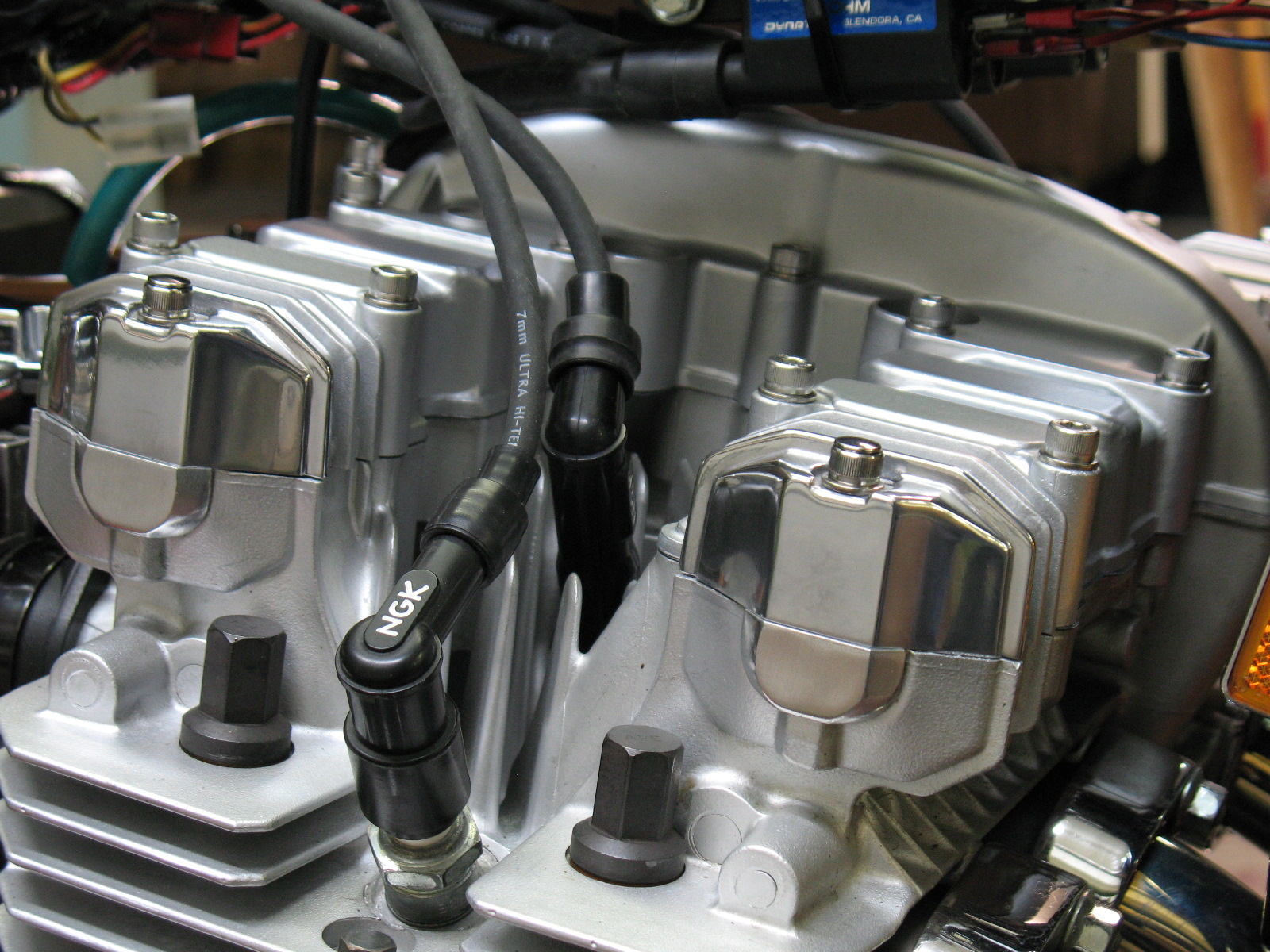

I have one pair of the only NGK non-resistor caps I could find (see below) coming in the mail tomorrow. They are 90 degree angle, and too short of reach for the center two spark plugs. The one shown in my pic should work very-well with a short piece of metal rod used in place of the resistor.

...and too short of reach for the center two spark plugs.
Try it, both my 550 and 750 have less head space than your 11 , but they work just fine.

20 Sep 2015 07:56Tyrell Corp wrote: ...and too short of reach for the center two spark plugs.
The longer caps (with less angle) are much-easier to access, especially with the gas tank installed on the bike...besides, I already have them and can be easily converted to non-resistor.
